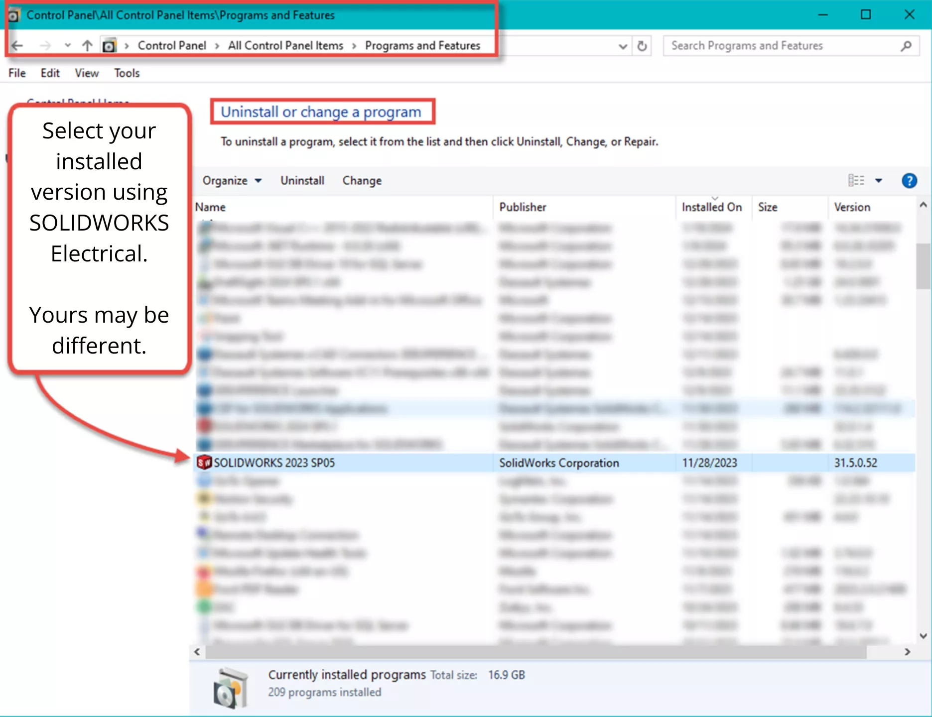

This will remove the SOLIDWORKS Electrical application from Windows. Here we will utilize the SOLIDWORKS Installation Manager initiated from the Windows Control Panel.

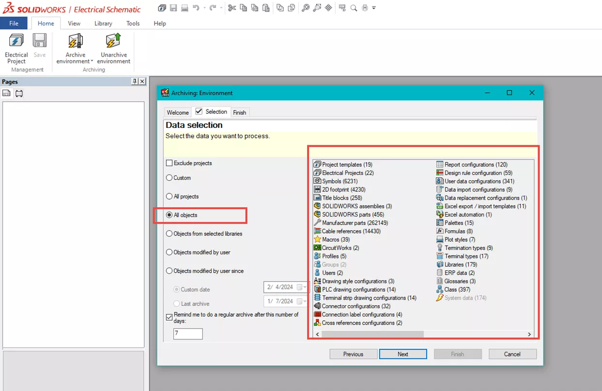

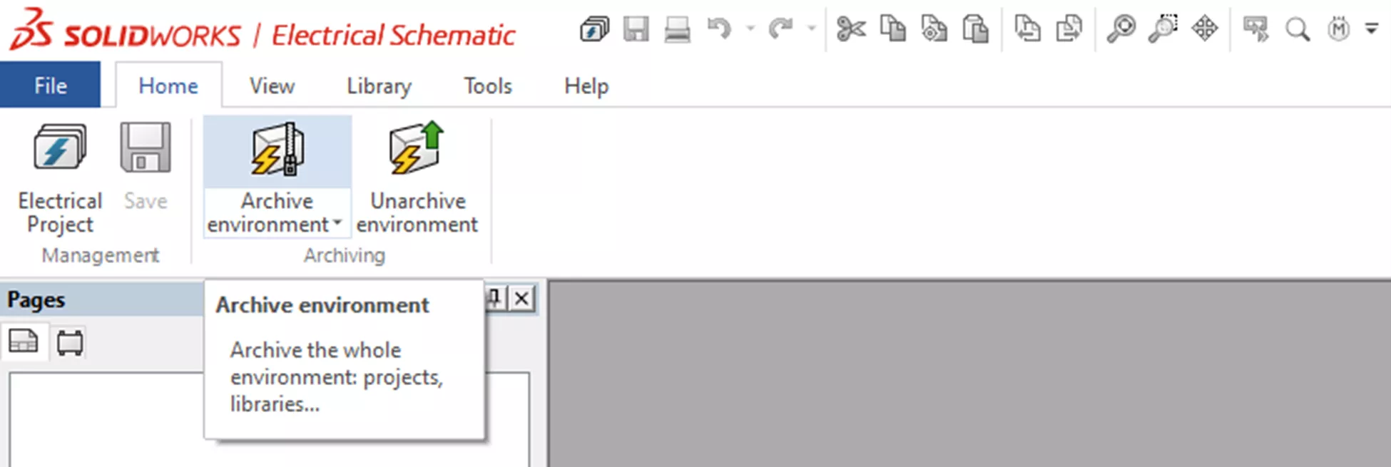

From the SOLIDWORKS Electrical home tab, select Archive environment.
SOLIDWORKS Electrical Archive Environment Option

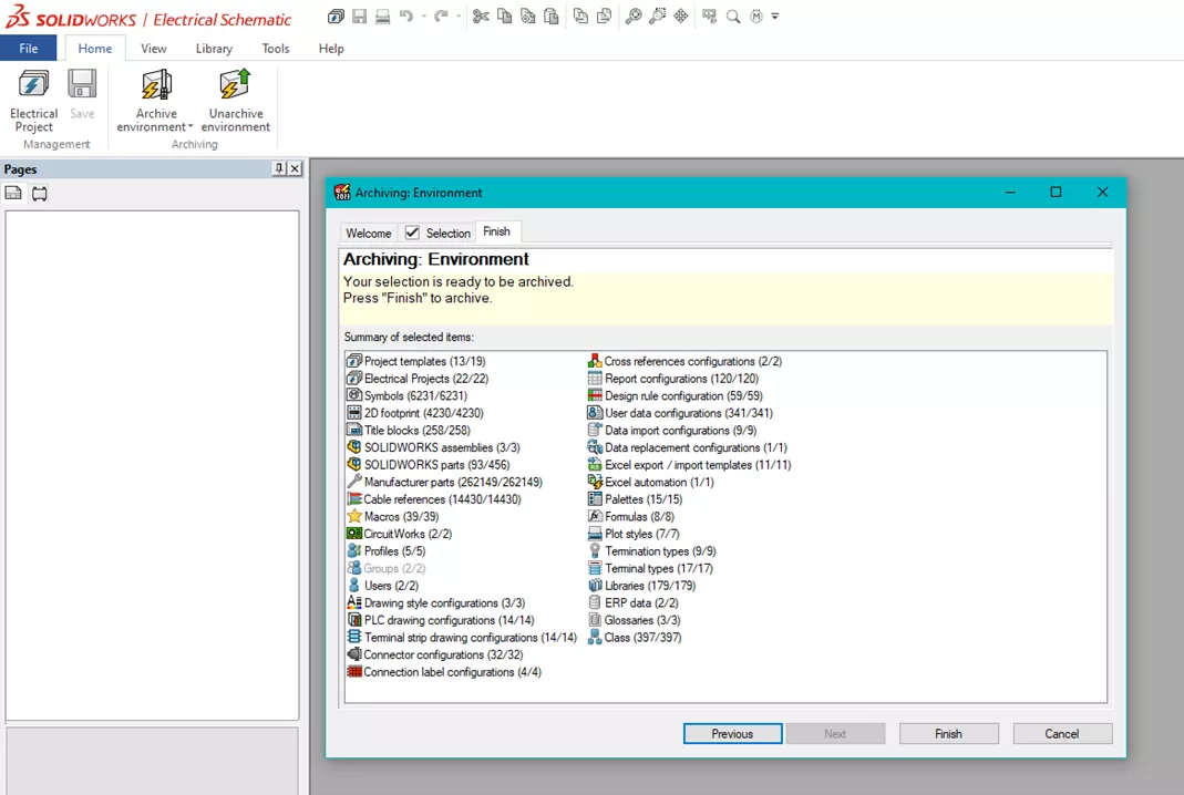

Within the Archive Wizard select the option for All Objects. This will ensure that all the data is captured in the archive.
Uninstall the SOLIDWORKS Electrical Archive Environment
Create Archive Environment when Uninstalling SOLIDWORKS Electrical

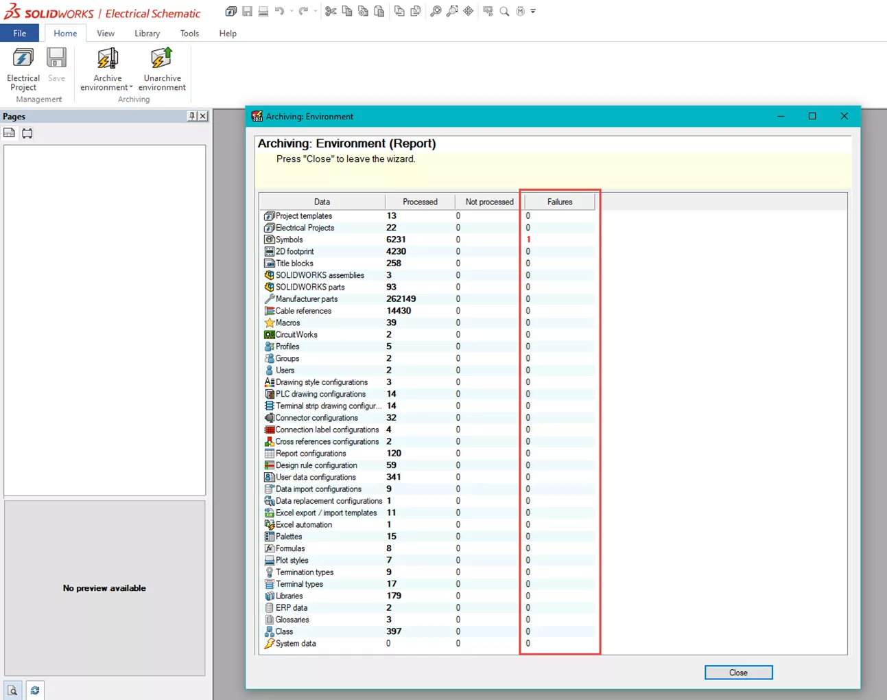

When the Archive Wizard has been completed with no failures, you are ready to proceed.
Complete Archive Server when there are no Errors when Uninstalling SOLIDWORKS Electrical

Remove SOLIDWORKS Electrical from the Windows Add/Remove programs.
How to Uninstall SOLIDWORKS Electrical

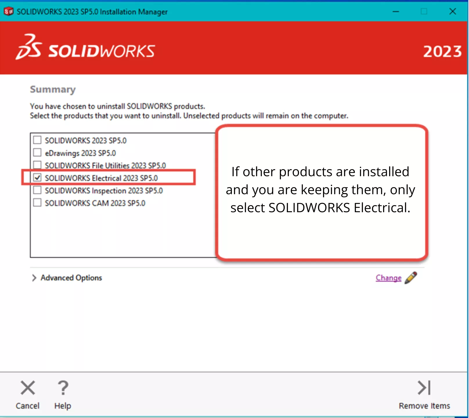

If you have other installed products you want to keep, only select SOLIDWORKS Electrical.
Uninstall SOLIDWORKS Electrical Only
Select Remove Items to proceed.

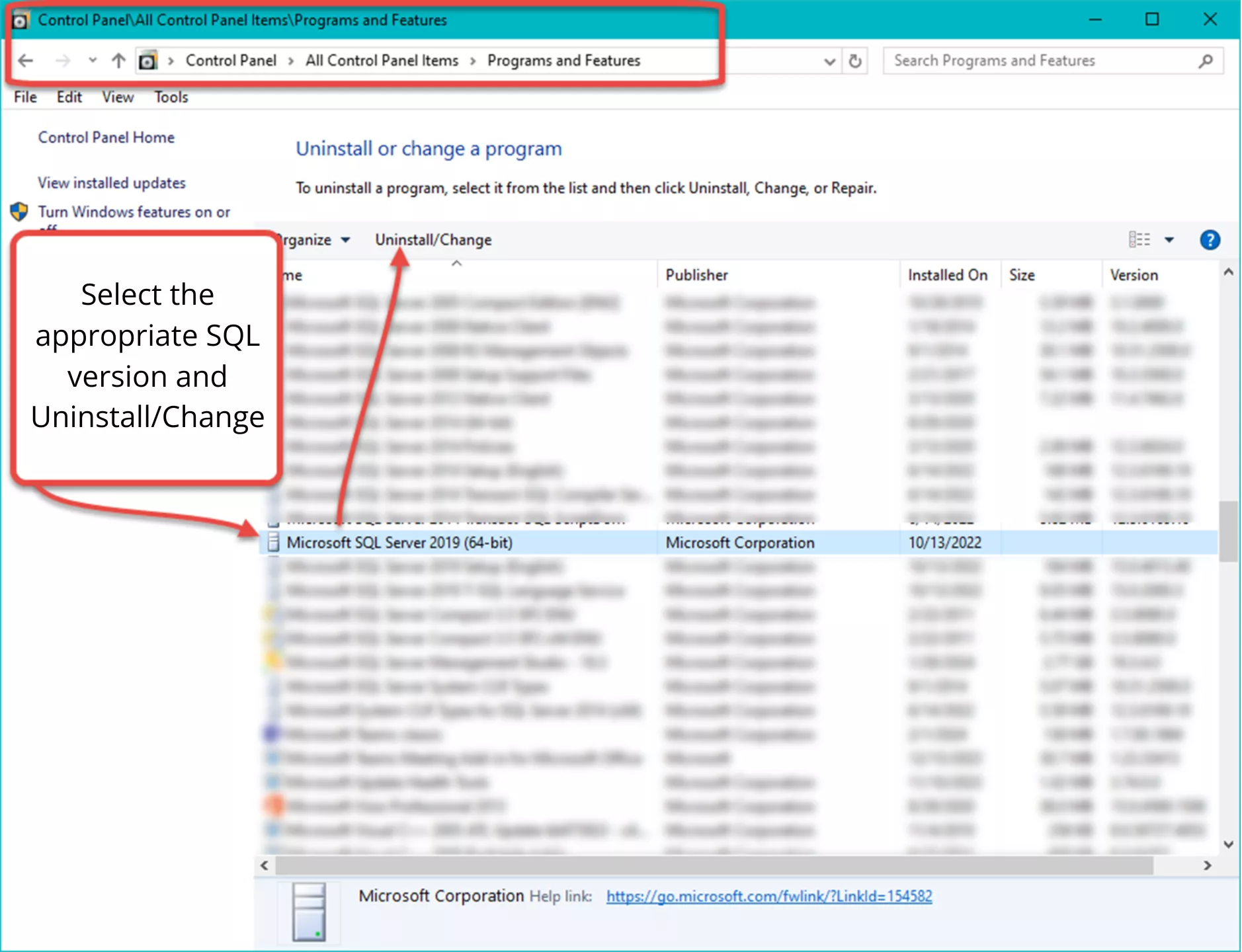

  1. 1. Navigate the Windows Control Panel, then Control Panel > Programs > Programs and Features.
  2. Scroll to Microsoft SQL Server [version] (64-bit).
  3. Right-click on this item > Uninstall/Change.

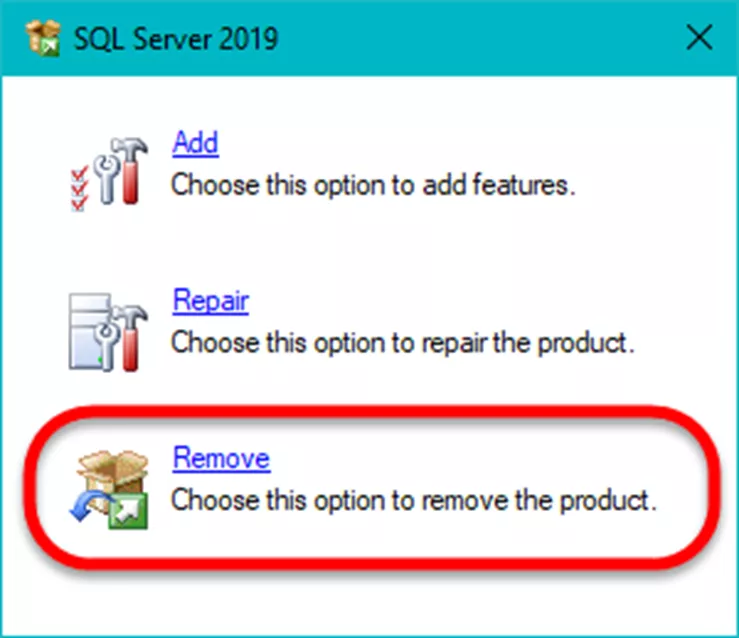

  4. When the SQL Server window appears, click Remove.
    Remove SQL Server

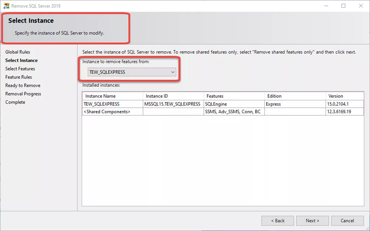

  5. In the Remove SQL Server window, select the SQL Server instance that you want to remove from the drop-down list.
    Remove an SQL Server Instance when Uninstalling SOLIDWORKS Electrical

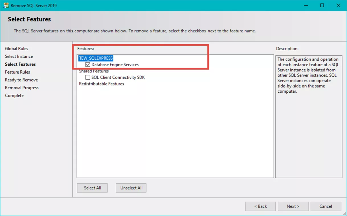

  7. Select the Database Engine Services feature only and then click Next.
    SOLIDWORKS Electrical Clean Uninstall Database Engine Service

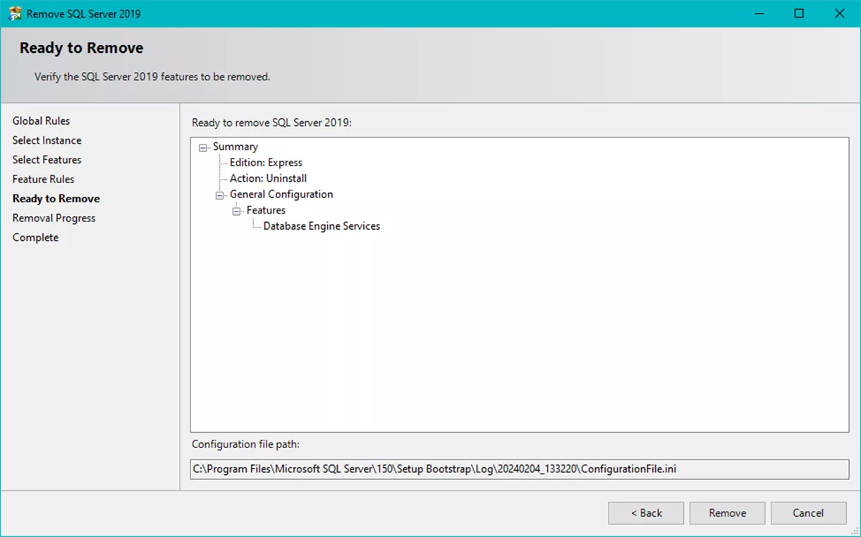

  8. A summary screen shows items for removal. If this is correct, click Remove. This will uninstall the instance.
    Uninstall SOLIDWORKS Electrical and Remove the SQL Instance Steps

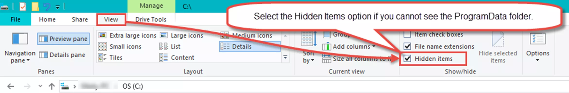

Note: The ProgramData folder may be a hidden folder. You can activate the Hidden items option in the File Explorer View tab Options.
Uninstall SOLIDWORKS Electrical Remove Folder Steps
