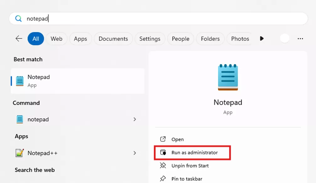

  1. Navigate to the Start Menu and type Notepad.
  2. Choose to run Notepad as Administrator.
    Notepad Run as Administrator

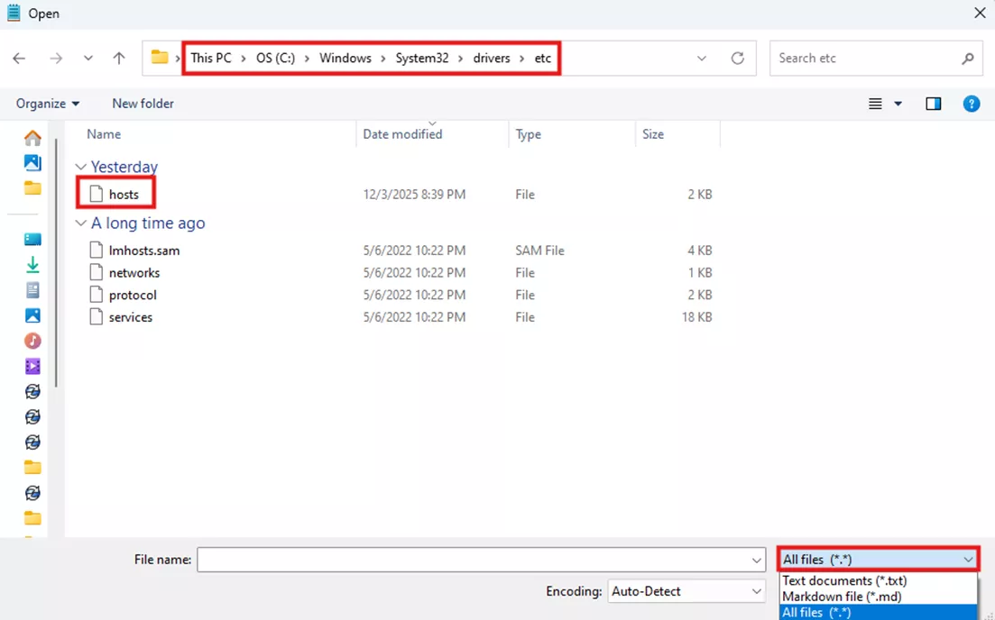

  3. Once in the Notepad window, click File > Open.
  4. Navigate to the path: C:\Windows\System32\drivers\etc\
    1. Note: Change the file type from Text Documents to All Files (shown below).
      SOLIDWORKS PDM Create Local Host File Workaround as Temporary Solution
  5. Make necessary adjustments/entries in the hosts file to allow server IP addresses. On a new line, enter the IP address followed by the server name and then save the file.
