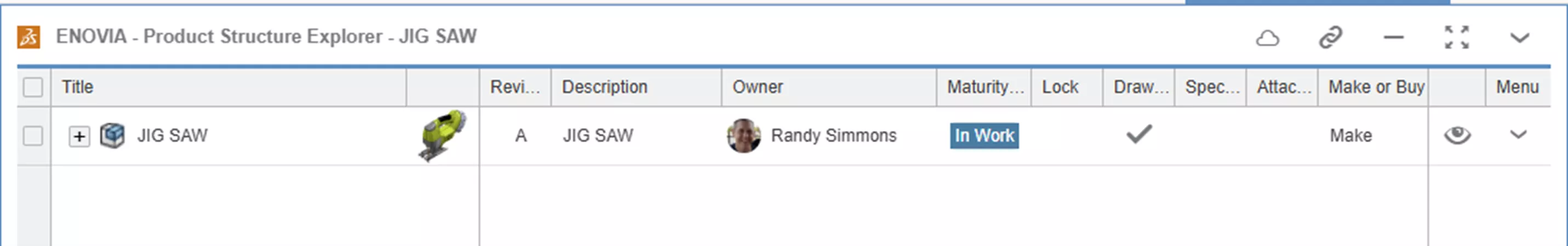

Open the assembly that contains some Derived Outputs associated with it.

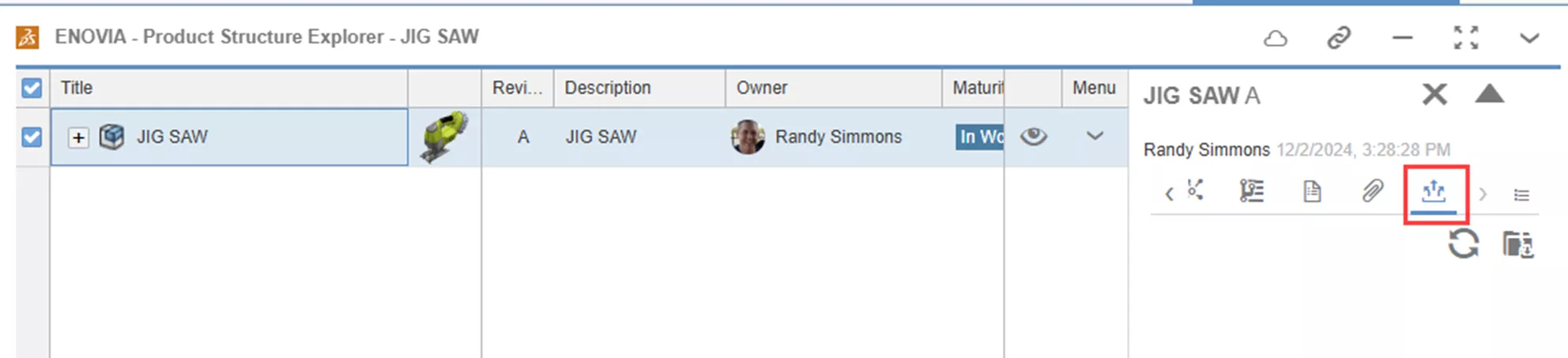

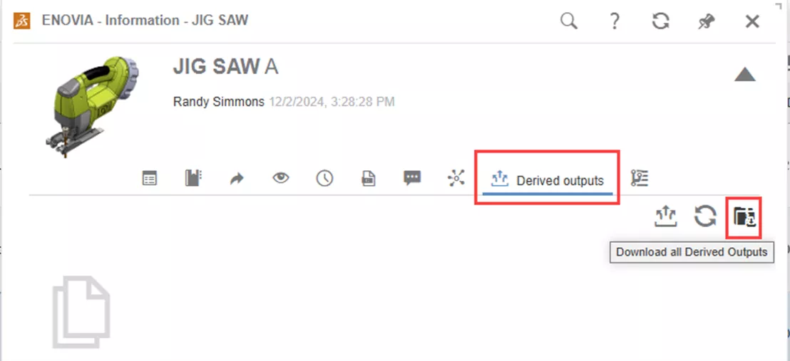

Select the top-level node of the assembly (will highlight blue), then hit the information (i) icon on the lower toolbar.
This will open a side panel.

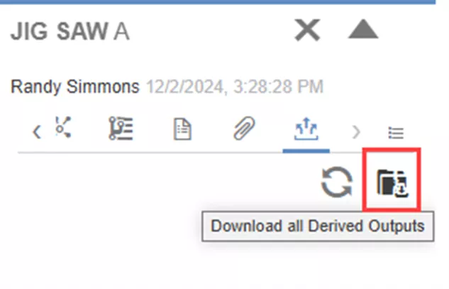

Navigate through the icons/tabs at the top of the information pane to Derived Formats.

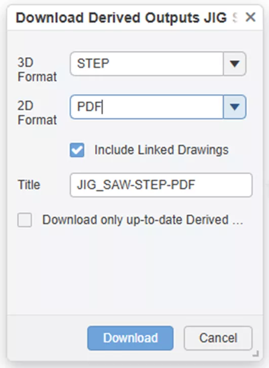

Select the Download All Derived Outputs button.
Set the options for what 3D outputs you want to collect (if any) and what 2D outputs you want to collect.
Give the .zip file a name and click the Download button.

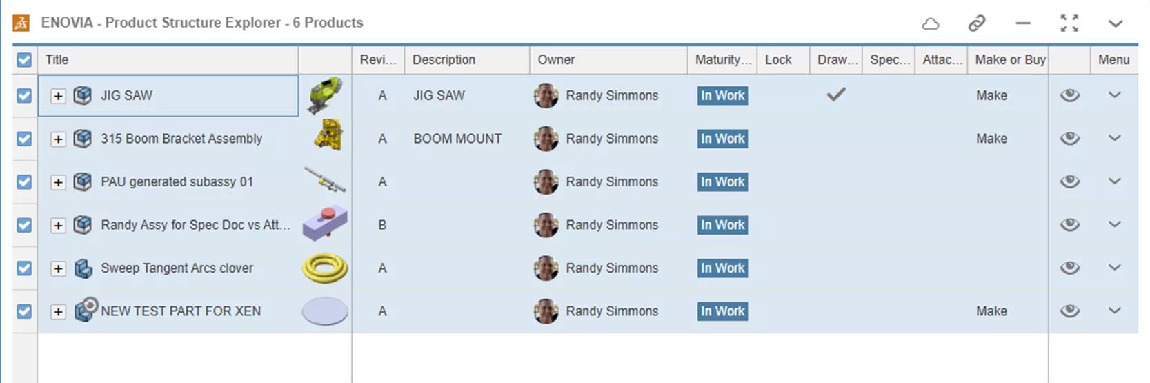

Add an assembly, multiple assemblies, or even just random parts to Product Explorer, then use the checkboxes or SHIFT+select in the list to select them all.

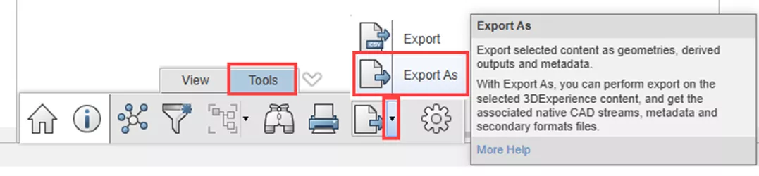

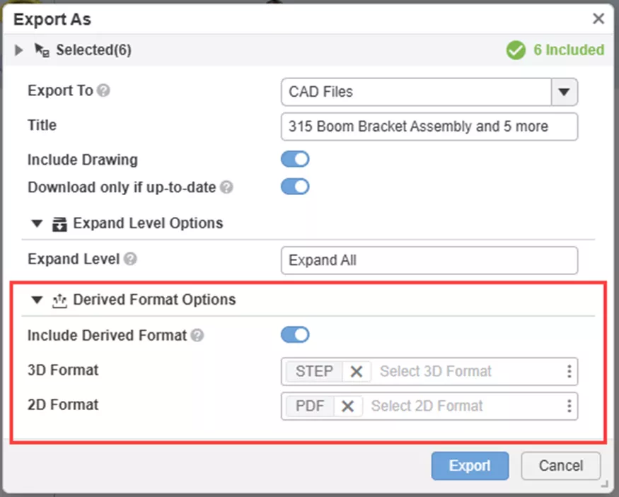

On the toolbar at the bottom, use Export As.
Name the file, choose to Expand All, and set the Derived Format Options as desired. Then, hit Export.

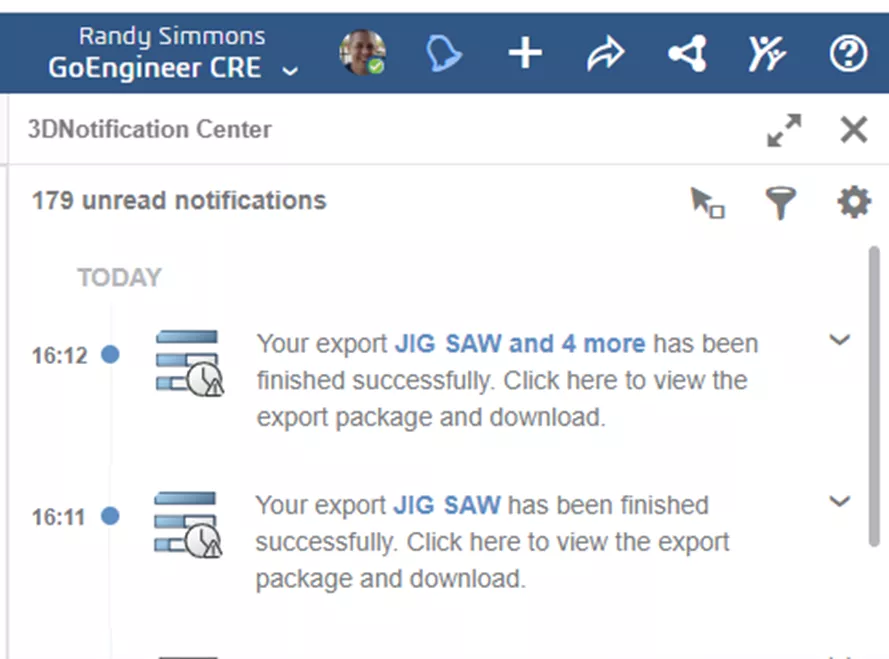

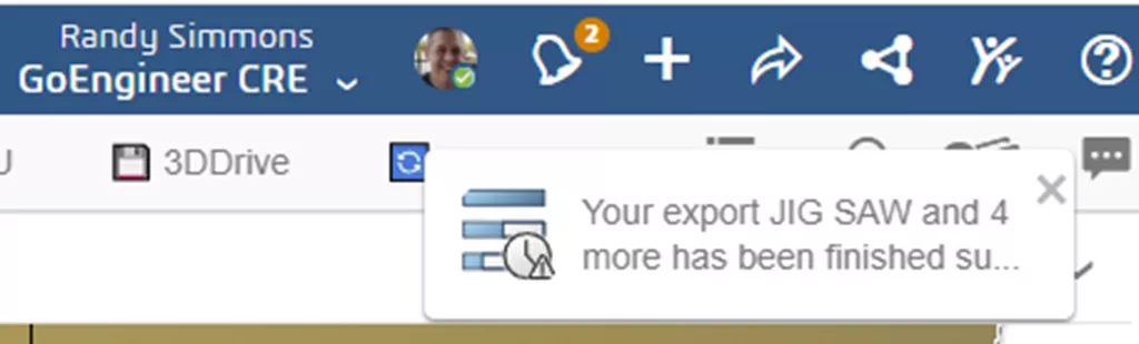

A job will start.
When it is finished, a notification will appear in the upper-right corner of the platform.
Click on the notification bell icon and click the task that was completed.

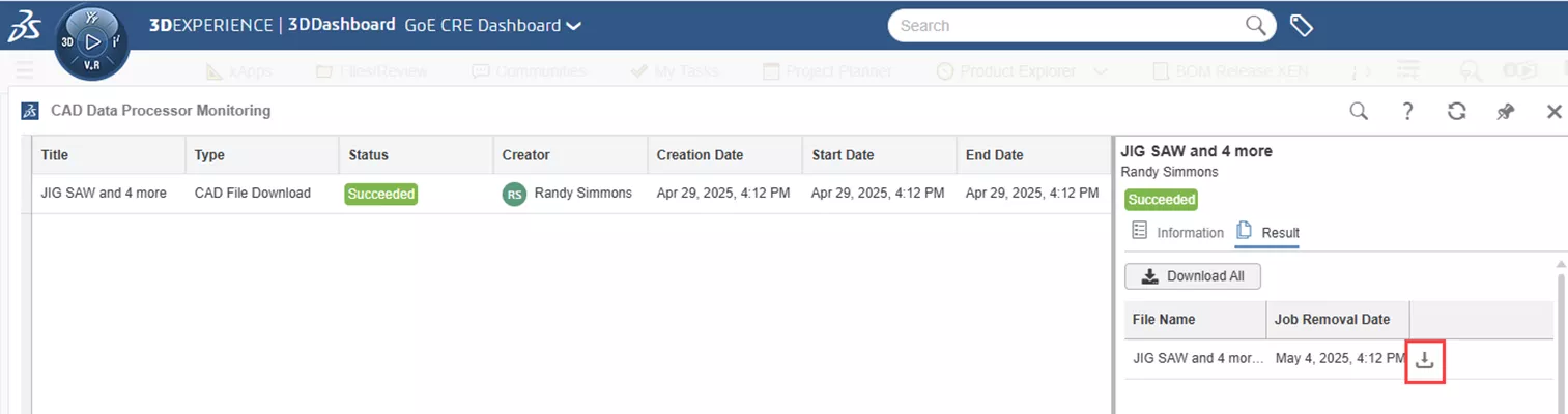

This will take you to the CAD Data Processor Monitoring app.
On the far right, click the Download button to download the .zip file.

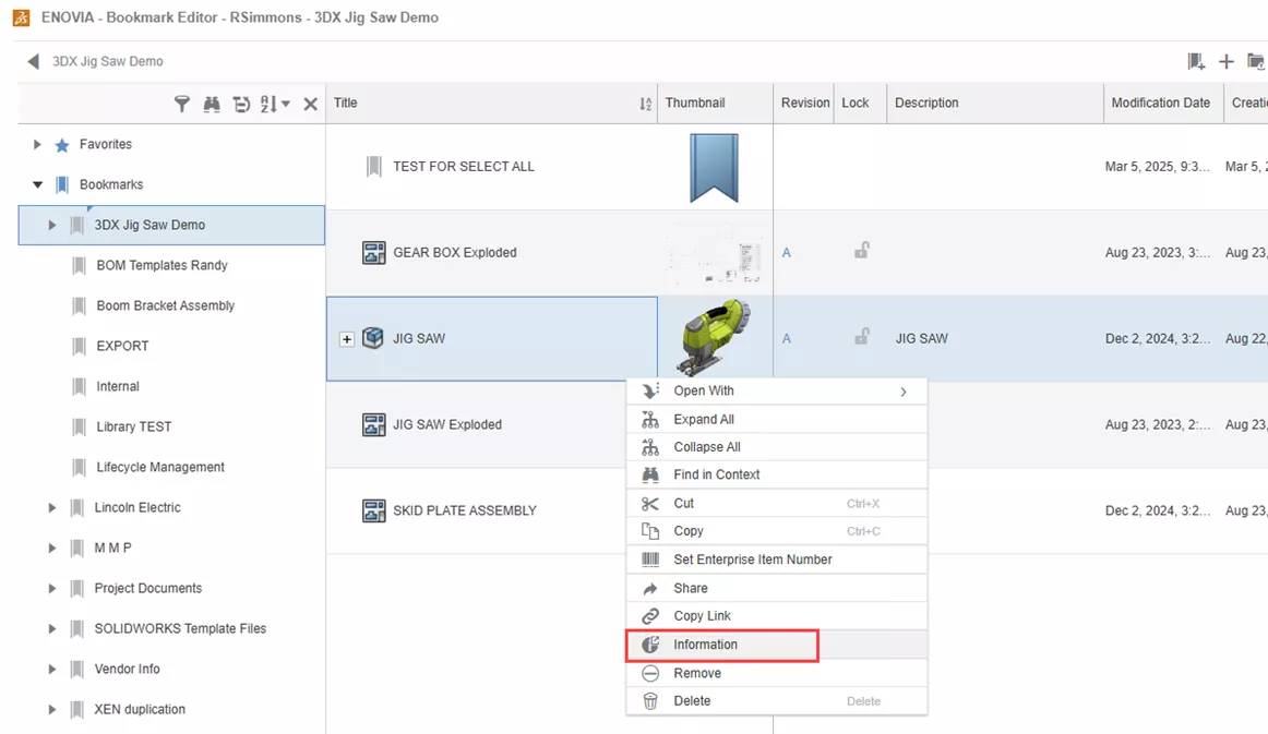

Find the assembly you want in an existing bookmark or add it to a new bookmark.
Right-click the assembly and choose Information.
This will open a standalone window on top of the bookmark editor.
Navigate to the Derived Outputs icon/tab and use the Download All Derived Outputs button (same as in the Product Explorer method above).

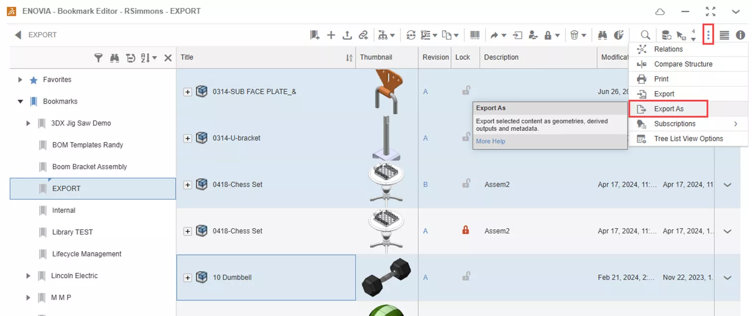

This method is the same basic process as Method 2 for Product Explorer.
Add whatever assemblies or parts you want to package the PDFs, STEP, etc., from into a Bookmark.
Select all files (or the ones you want) and use the Export As command from the upper toolbar.
As before, the downside to this method is that you will have to delete the CAD files from the resulting .zip files to only have the Derived Outputs left.
However, the upside is that you can do many assemblies at the same time or even many unrelated files if needed.
