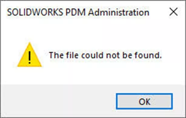

File Not Found Warnings
  • Parts and subassemblies being suppressed upon opening an assembly or drawing.
  • “The file could not be found.” – The sync function of the cloud storage software interfered with SOLIDWORKS’ ability to open the file.
    SOLIDWORK The File Could Not Be Found Error

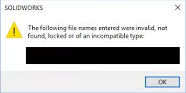

  • “The following file names entered were invalid, not found, locked, or of an incompatible type:” with SOLIDWORKS’ ability to open the file.
    SOLIDWORKS The following file names entered were invalid, not found, locked, or of an incompatible type

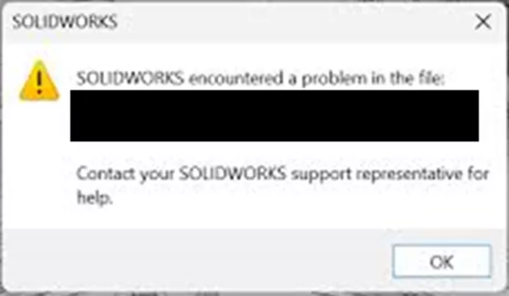

  • “SOLIDWORKS encountered a problem in the file…"

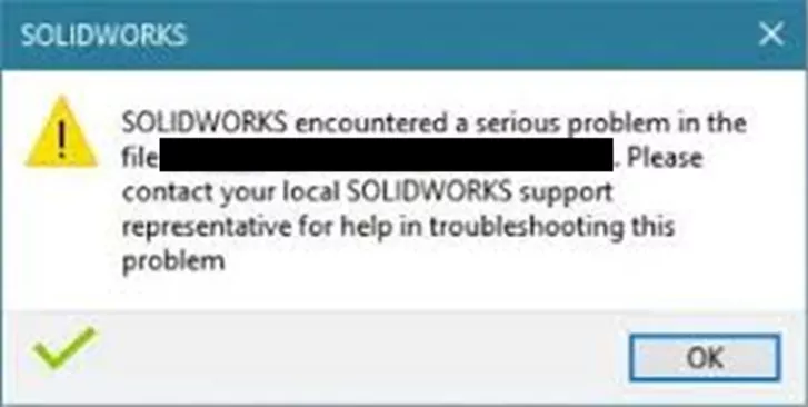

  • “SOLIDWORKS encountered a serious problem in the file…”

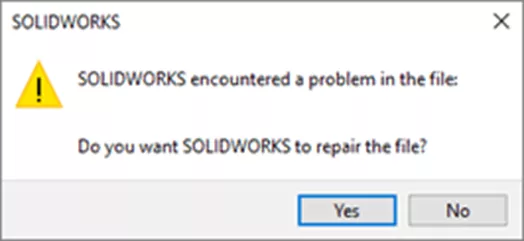

  • “SOLIDWORKS encountered a problem in the file… Do you want to repair the file?”

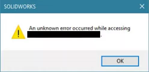

  • “An unknown error occurred while accessing…”
    SOLIDWORKS An unknown error occurred while accessing…

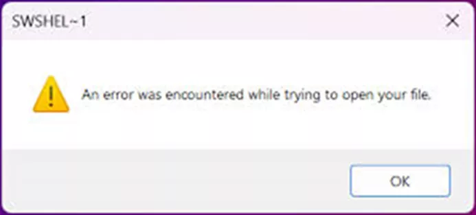

  • “An error was encountered while trying to open your file.”
    SOLIDWORKS An error was encountered while trying to open your file
If any of these errors are encountered during file open, disable the sync function of the cloud storage software and try opening the file again. If these occur during file save, try using File > Save As to save the file under a different name to see if the changes can otherwise be preserved.
