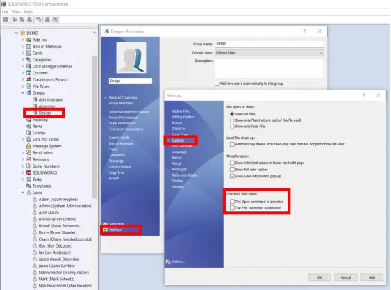

There are two options within the SOLIDWORKS PDM Administration tool to help automate this process. To find this setting, launch the SOLIDWORKS PDM Administration tool, log into the vault as the admin user, select a group or a user, click on settings, then Explorer, and there will be two options (shown below).
SOLIDWORKS PDM Setting Checked Out Files When Explained
The two options are, check out files when:
  1. The Open command is executed
  2. The Edit command is executed
One or both options can be selected based on preference.
What do these options do?
If you select to check out a file when you open it, the file will now open checked out without being prompted to check it out. If there are references associated with the file, such as the part’s drawing, the check out dialog box will launch asking if you also want to check out the reference files. By default, the file you selected to open will have a check box next to it since PDM now knows you want the file you selected to open to also be checked out.
If you select to check out the file when you begin to edit a file, by default, PDM will now check out any file that you attempt to execute a change to. Selecting both options will check out files upon opening as well as if you attempt to edit a file that is not checked out.
