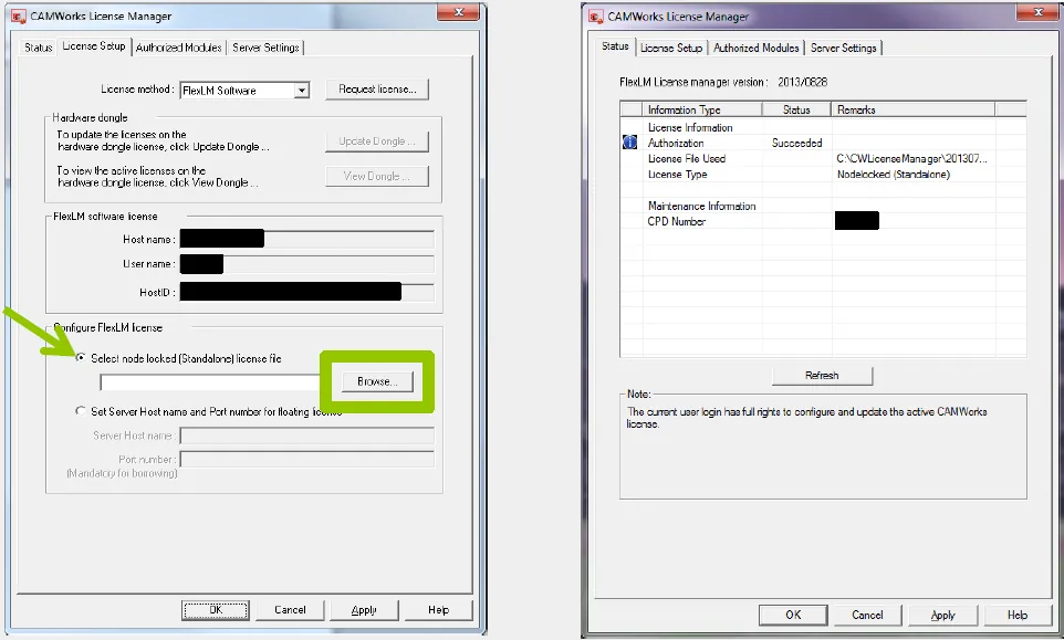

Pointing to the License File (Standalone)
Choose the Select node-locked (Standalone) license file radio button from the License Setup tab and browse to the file that you saved on your computer.
CAMWorks Standalone License Setup
Once you have done this, click Apply and then check the Status tab to see that the license authorization has succeeded. If you have any further questions, please contact Technical Support.
