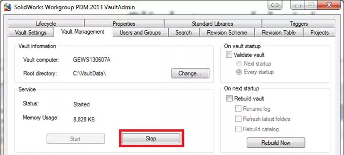

  2. Open the VaultAdmin utility and go to the Vault Management tab.
  3. Set the vault service to Stop (shown below).
    Set SOLIDWORKS Workgroup PDM Vault Service to Stop

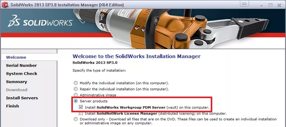

  5. On the new file server (using a disc or download), begin the installation of the vault service (highlighted below) and proceed Next.
    SOLIDWORKS Installation Manager Install SOLIDWORKS Workgroup PDM Server (vault) on this computer

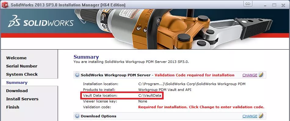

  6. At the Summary screen, change the Vault Data location to the location of the copied VaultData folder or modify the vault data folder to reflect the default location listed: “C:\VaultData\”
    SOLIDWORKS Workgroup PDM Vault Data Location

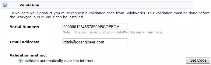

  7. Also, on the Summary screen, make sure to change SOLIDWORKS Workgroup PDM Server, enter an email address, and validate the vault installation.
    Validate Vault Installation SOLIDWORKS Workgroup Migration Procedure

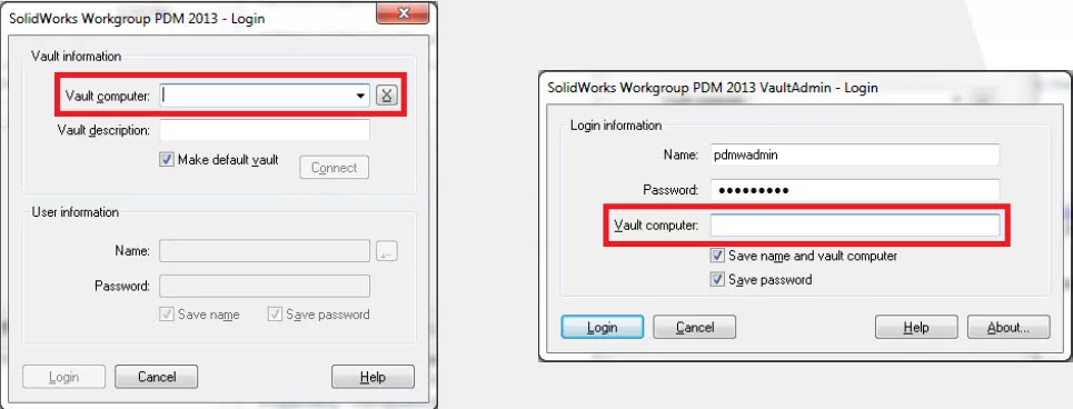

At the conclusion of this process, the vault should now be functioning under a newly installed service on a new machine. When it comes time for a client (or the VaultAdmin tool itself) to log into the new vault all that needs to be changed is the computer it is pointed to at the login screen (shown below).
SOLIDWORKS Workgroup PDM Vault Computer Field

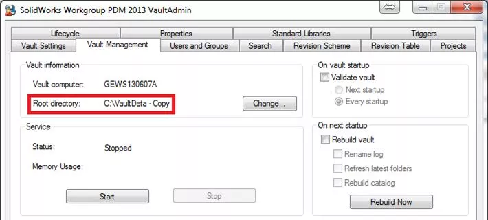

  5. Go to the Vault Management tab of the VaultAdmin tool.
  6. Under Vault information change the Root Directory indicating the location of the vault to the new permanent location of the vault on this machine (shown below).
    SOLIDWORKS Workgroup PDM Root Directory Field
  7. On the Vault Management tab, select to Start the vault service.
At the conclusion of this process, the vault should now be functioning under the same service as before in a new location on the same machine. This change will not affect how the client machines or the VaultAdmin tool access the vault as both only point to the machine the vault is on and are not concerned with its exact location.

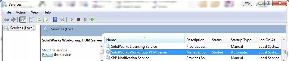

  2. Open Windows Services (via the Windows Control Panel > Administrative Tools Services).
  3. Locate and stop the service named SOLIDWORKS Workgroup PDM Server.
    Stop SOLIDWORKS Workgroup PDM Server Service

  5. On the new file server (using a disc or download) begin the installation of the vault service (highlighted below) and proceed Next.
  6. At the Summary screen change the Vault Data location to the location of the copied VaultData folder or modify the vault data folder to reflect the default location listed: “C:\VaultData\”
  7. Also on the Summary screen make sure to change SOLIDWORKS Workgroup PDM Server, enter an email address and validate the vault installation.

  8. Open Windows Services (via the Windows Control Panel >  Administrative Tools Services).
  9. Locate and start the service named SOLIDWORKS Workgroup PDM Server.
    SOLIDWORKS Workgroup PDM Server Started
