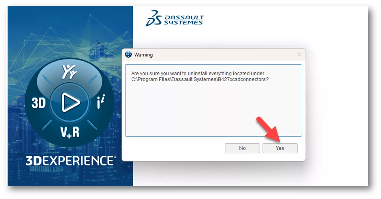

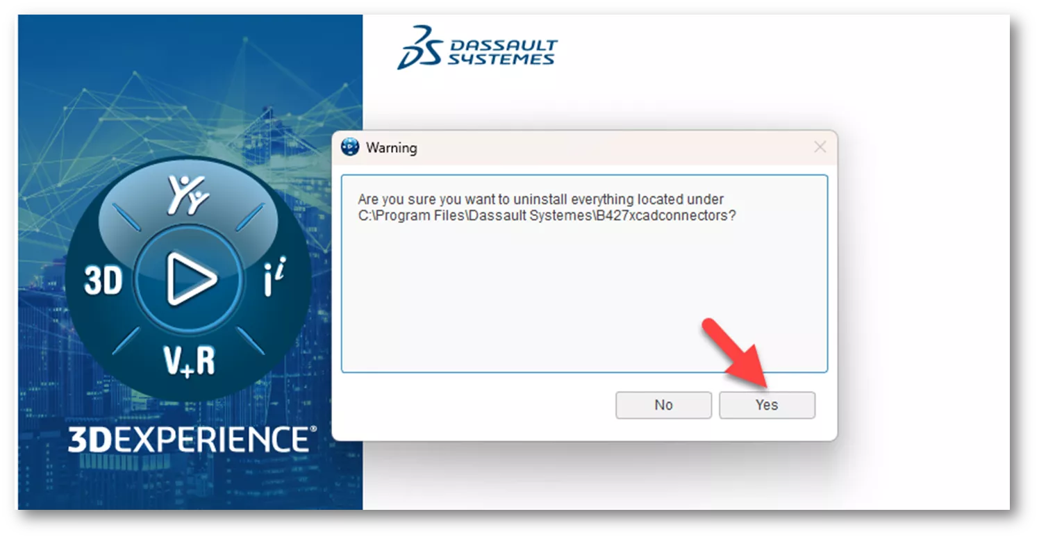

  3. Another dialog will appear, asking one more time, “Are you sure you want to uninstall everything...” Click Yes to this message.
    3DEXPERIENCE Are You Sure You Want to Uninstall Everything Message

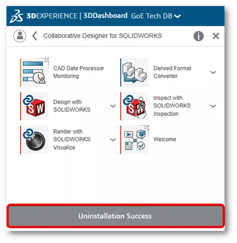

  4. Once the uninstallation process is complete, there will be an Uninstallation Success confirmation at the bottom of the apps window on the platform.
    3DEXPERIENCE SOLIDWORKS Uninstallation Success Message

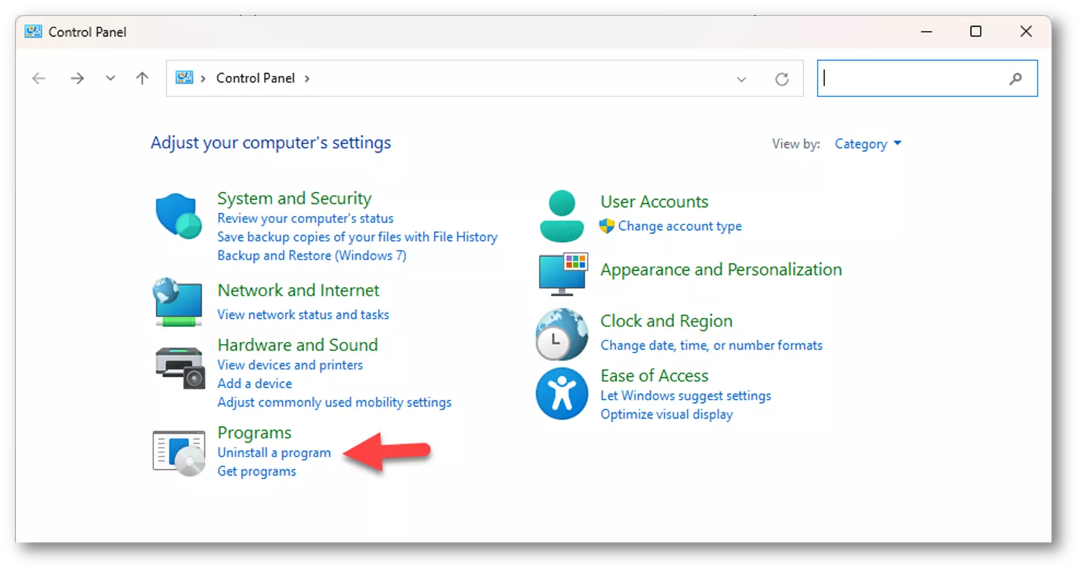

  1. Open the Windows Control Panel. I find the quickest way to find it is by clicking the Windows Start button and typing Control Panel. Then, click the Control Panel icon.
  2. In the Windows Control Panel, click Uninstall a program under Programs. If the Control Panel is set to icons, click Programs and Features, then Uninstall a program.

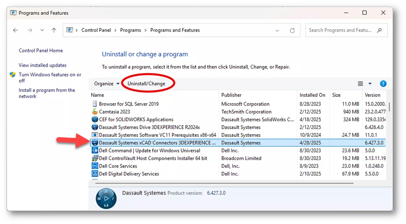

  3. In the list of installed programs, find Dassault Systèmes R20XXx version SOLIDWORKS for SOLIDWORKS Connected, or Dassault Systèmes xCAD Connectors for the SOLIDWORKS Connector add-in. Highlight the app, then click Uninstall/Change.
    Uninstall 3DEXPERIENCE SOLIDWORKS From Windows Control Panel
  4. A dialog will appear asking to confirm the uninstallation. Click Yes to this message.
    3DEXPERIENCE SOLIDWORKS Uninstallation Warning

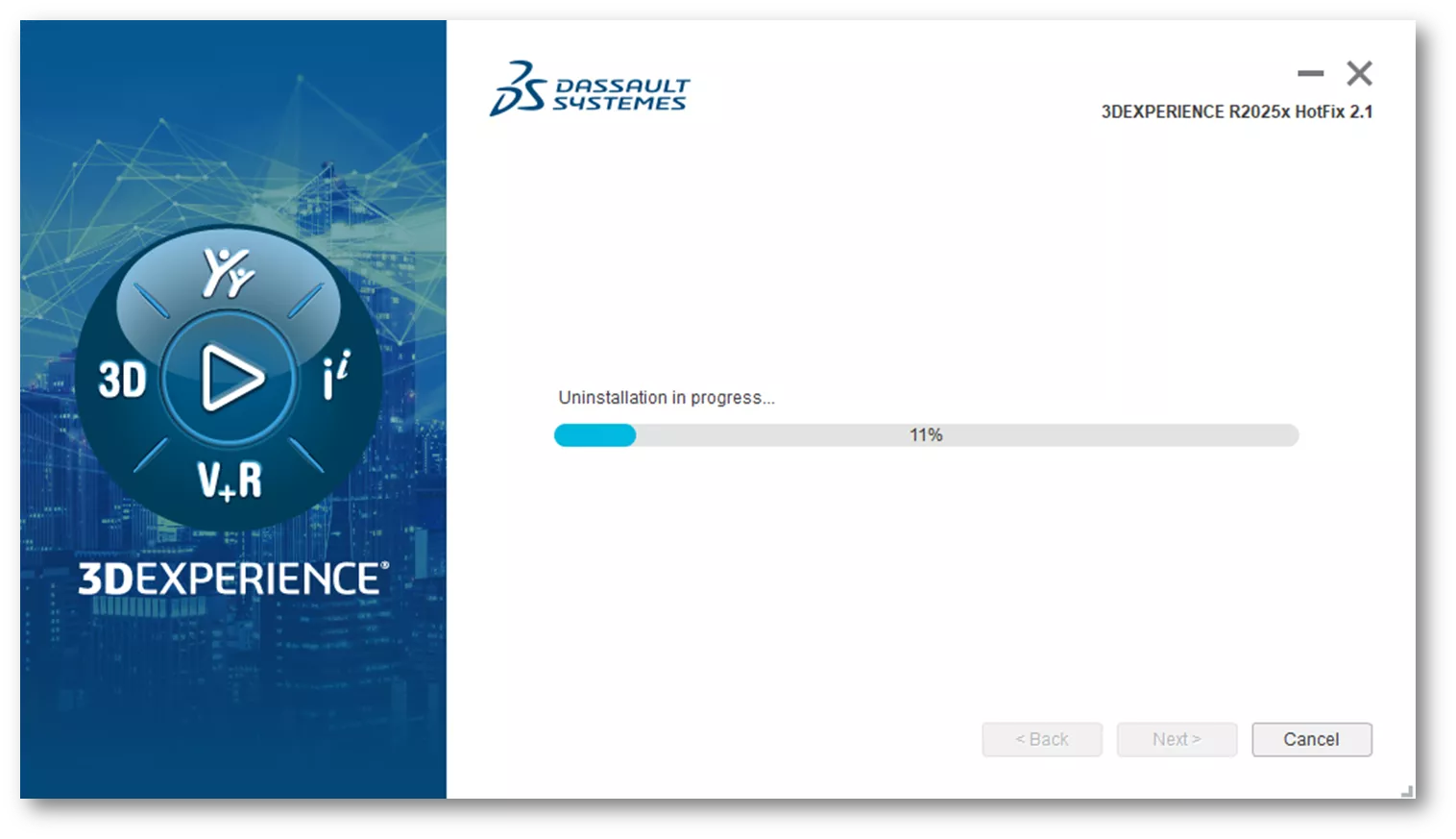

  5. After clicking Yes, a dialog will appear to show the progress of the uninstallation. Once the uninstallation is complete, the dialog will disappear with no further confirmation.
    3DEXPERIENCE SOLIDWORKS Uninstallation in Progress
