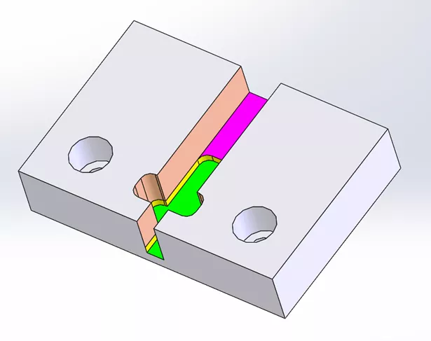

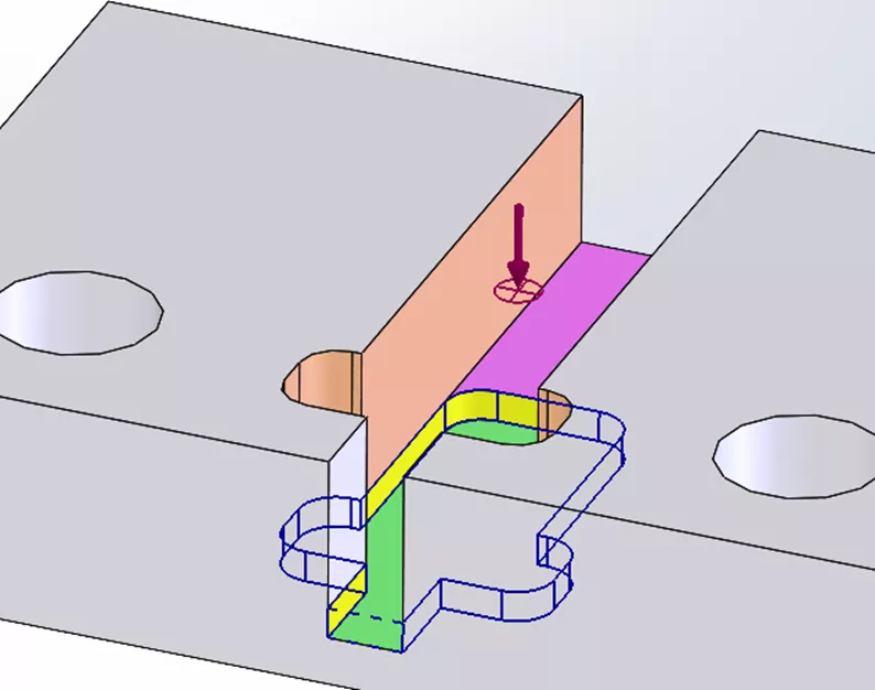

In the part pictured below, the center channel can be processed by looking at two volumes, whose floors are purple and green faces, and go all the way up to the top of the part.
It can also be processed as two separate volumes: one from the top surface to the purple floor (with salmon-colored walls), and another for the next step (green floor with yellow walls).

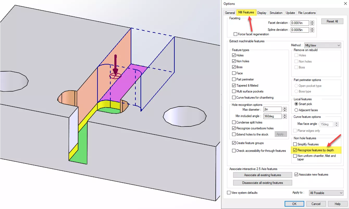

One of the option settings in SOLIDWORKS CAM or CAMWorks is to recognize features by depth.
When this setting is used, you end up with two distinct features. Both are called slots because some walls are missing.
Imagine that the part is like a bucket; you start empty and add water to make the level rise. As every floor face is covered (the green first, then the purple), it extends the volume defined by that face by following the vertical edges and removing material all the way up.

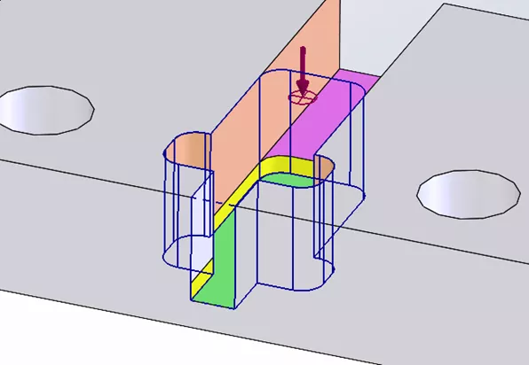

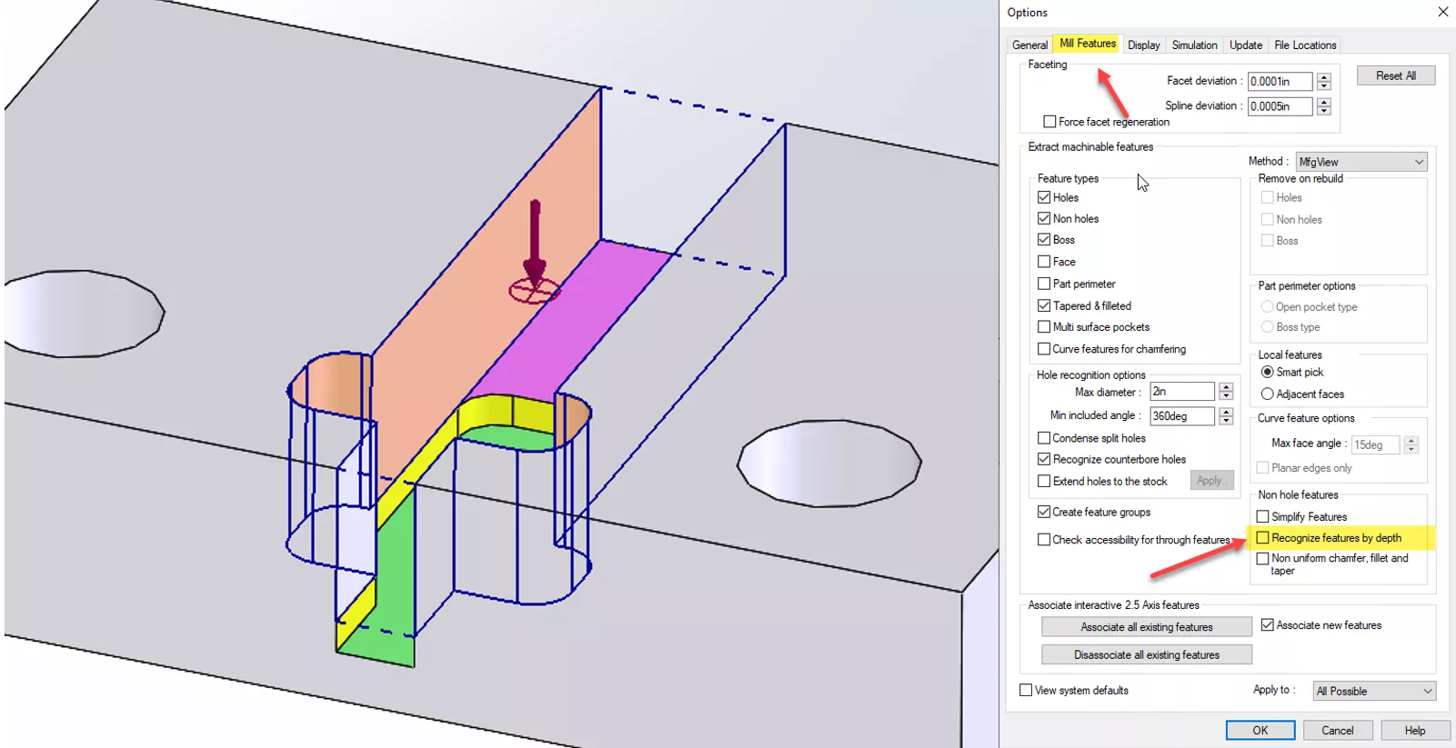

If you set the options to not recognize the feature by depth, the result is something like this:
Following the previous analogy, this time the bucket starts full of water. As the level drops, it follows the vertical wall down until it runs into a floor (the purple first, then the green). This results in two slots, but they’re different than the prior method.

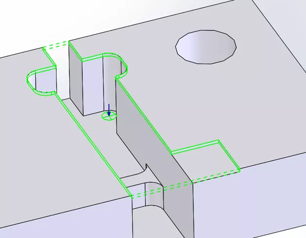

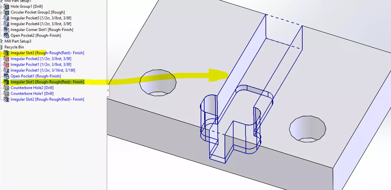

If the system finds a feature and it is deleted but still in the recycle bin, it indicates that the software should ignore it. This is what happened with the original extract features:
The only time you need a sketch is when the tool pushes past the edge (into open air), a different distance for each slot segment. The operation only allows you to apply a fixed amount to all edges (limit is 150% of the tool):

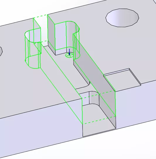

I added to the center channel by extracting machinable features with the setting recognize features by depth unchecked in the options. Notice that it adds an entire feature to the depth of the small square:

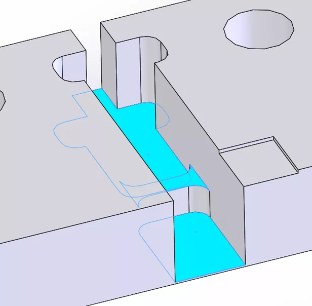

Next, hold CTRL and select the floors:

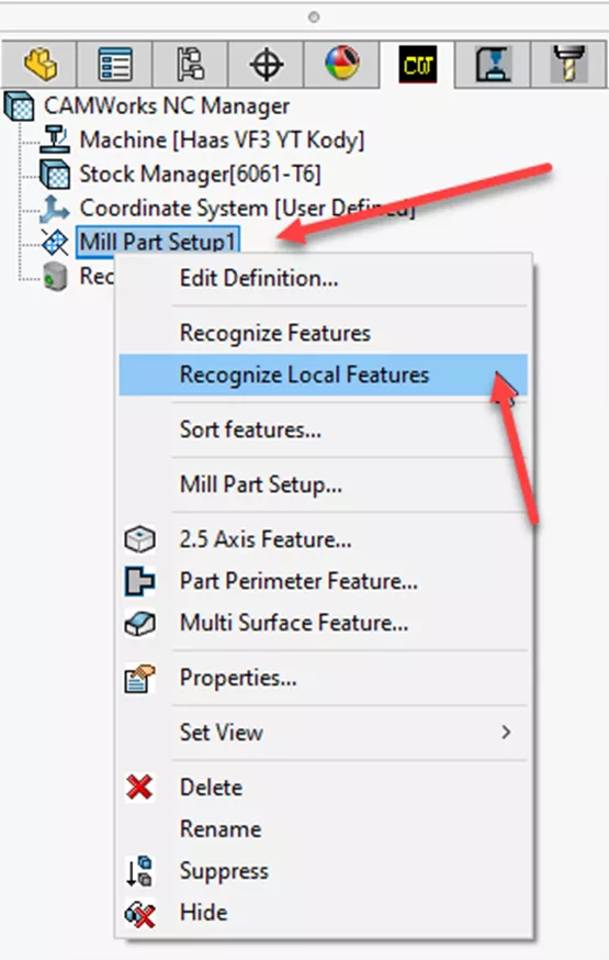

Then, right-click on the Mill Part Setup and select recognize local features.
CAMWorks tries to add the faces and comes up with a deep slot, ignoring the small square.

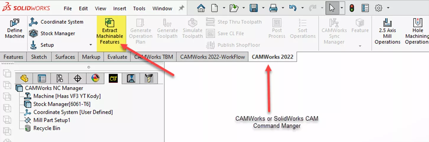

Next, run the Extract Machinable Features under the CAMWorks toolbar.
