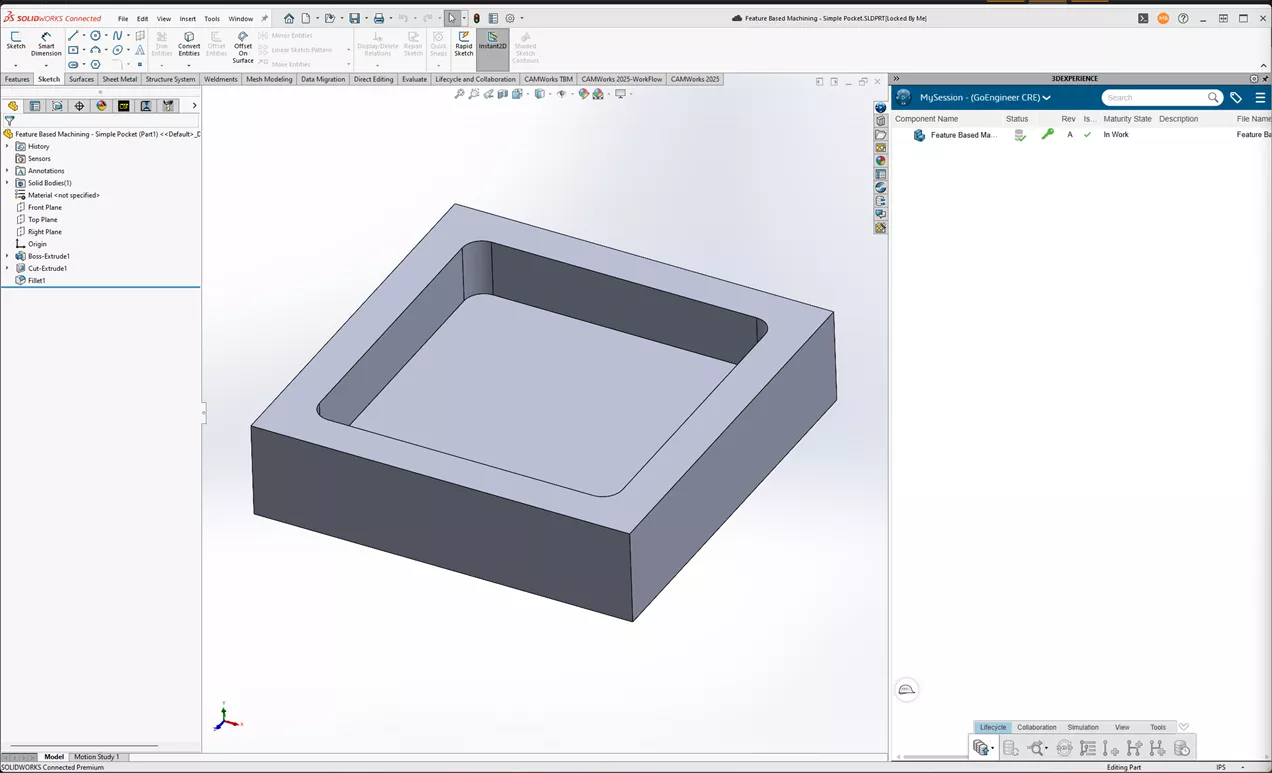

SOLIDWORKS CAM and CAMWorks turn the dynamic of “Roughing here, contouring there” on its head. Instead, the actual geometry of your parts holds primacy, and the strategies used to machine those features follow from there. Let’s consider a simple part: a block with a pocket inside.
Feature-based CAM
In traditional operations-based CAM software, the following workflow would be expected:

In feature-based CAM software, we would choose the geometry (the feature) first, and then the operations follow. In this case, we will do the following:
  1. Select Geometry
  2. Select Strategy (series of operations)
  3. Set Parameters (if creating or tweaking strategies)

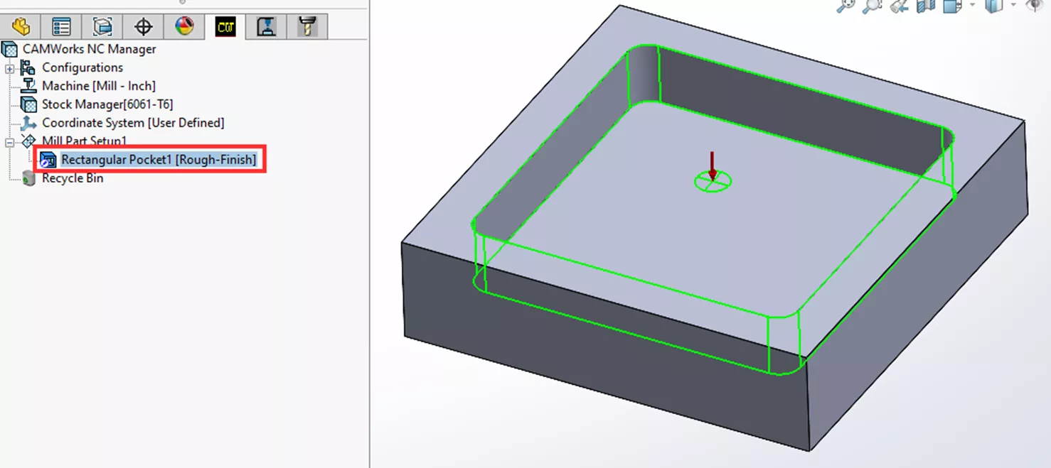

For this part, we have identified a rectangular pocket feature:
SOLIDWORKS CAM & CAMWorks Rectangular Pocket Feature

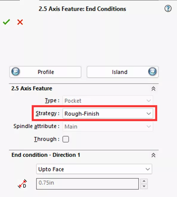

And, in that very same dialog, selected the Rough-Finish Strategy.
CAMWorks Rough Finish Strategy

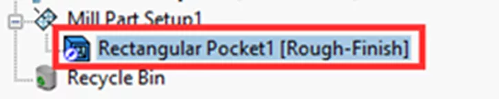

After these few clicks, notice that the feature is identified in the CAM Feature Tree with the strategy in brackets afterwards.
CAM Feature Tree Strategy

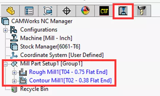

We then generate the operation plan, which takes our Rough-Finish strategy and produces a roughing operation and a finishing operation.
CAMWorks NC Manager Generate Operation Plan

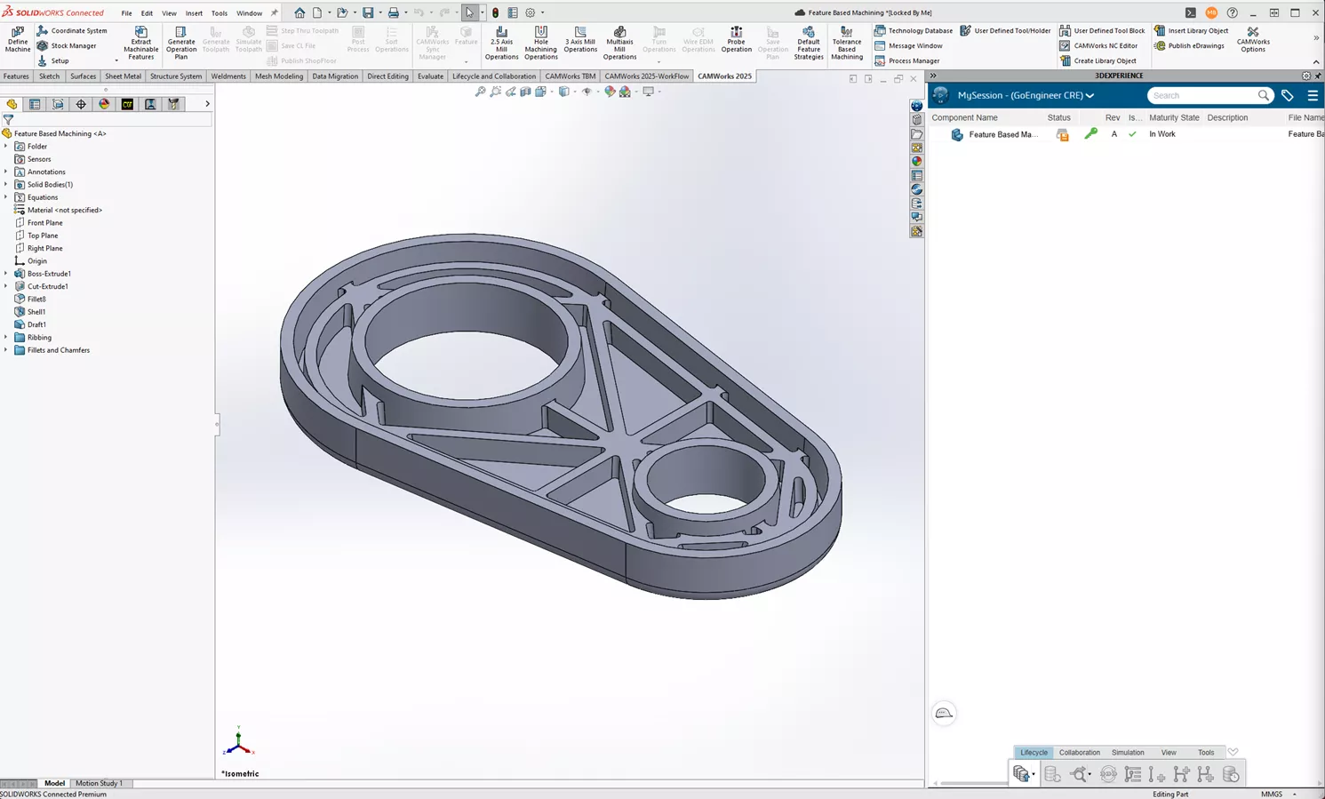

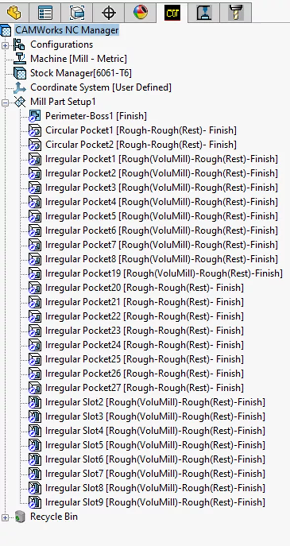

This part has a lot of geometry, but it has even more operations. Each pocket is tapered and takes a roughing pass, rest machining pass, and a contour pass. This entire setup was programmed in just a handful of minutes using parameters I know are good.
CAMWorks Feature Tree Mill Part Setup
Creating a new strategy is as simple as customizing existing strategies or creating them from scratch. Saving that information back to the TechDB for future use automates so much of the programming workflow and eliminates the tedious task of re-entering the same feeds and speeds over and over again on every part.
