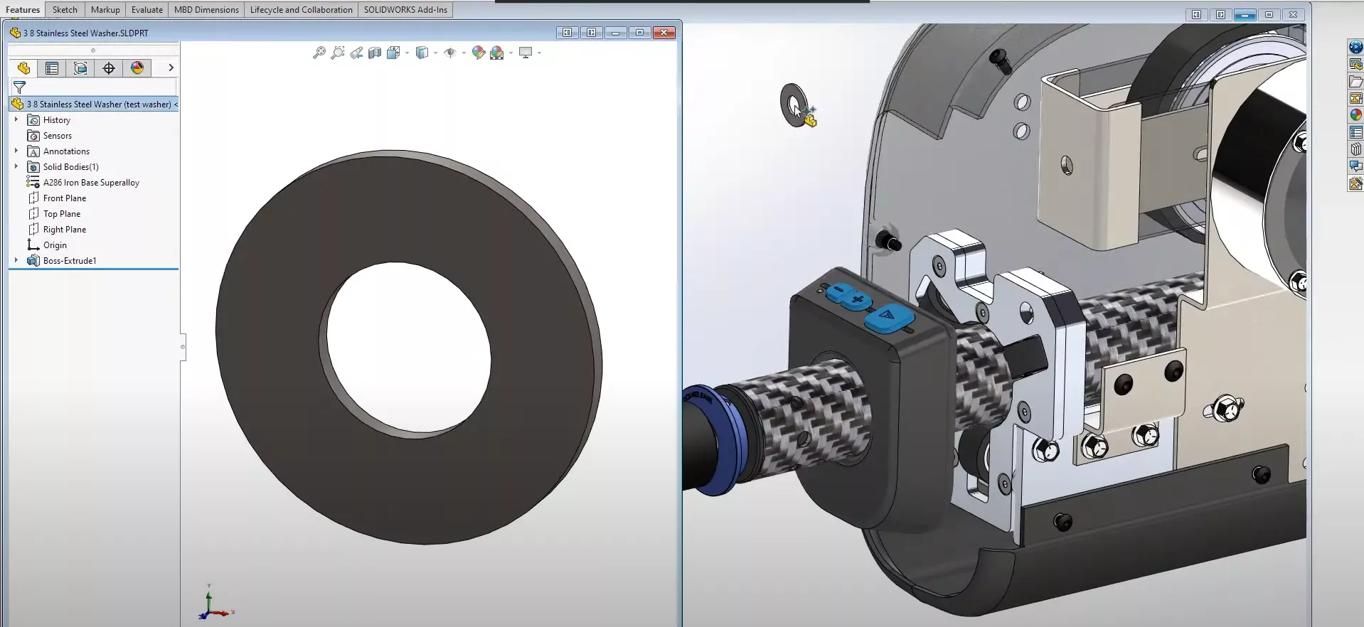

Now, when you insert a part into an assembly, SOLIDWORKS automatically recognizes fastener-like geometry, including bolts, washers, and nuts. SOLIDWORKS applies the appropriate mates as you drag and drop the fastener into place. Even cooler? It works on non-toolbox parts, like that random part you found online or even non-SOLIDWORKS file formats like STEP.
I tested it myself, and here’s how I’d describe it. It’s like smart components, without the prep work. You don’t need to predefine anything; just insert the part and, if it looks like a washer, bolt, or nut, SOLIDWORKS will take care of the mates.

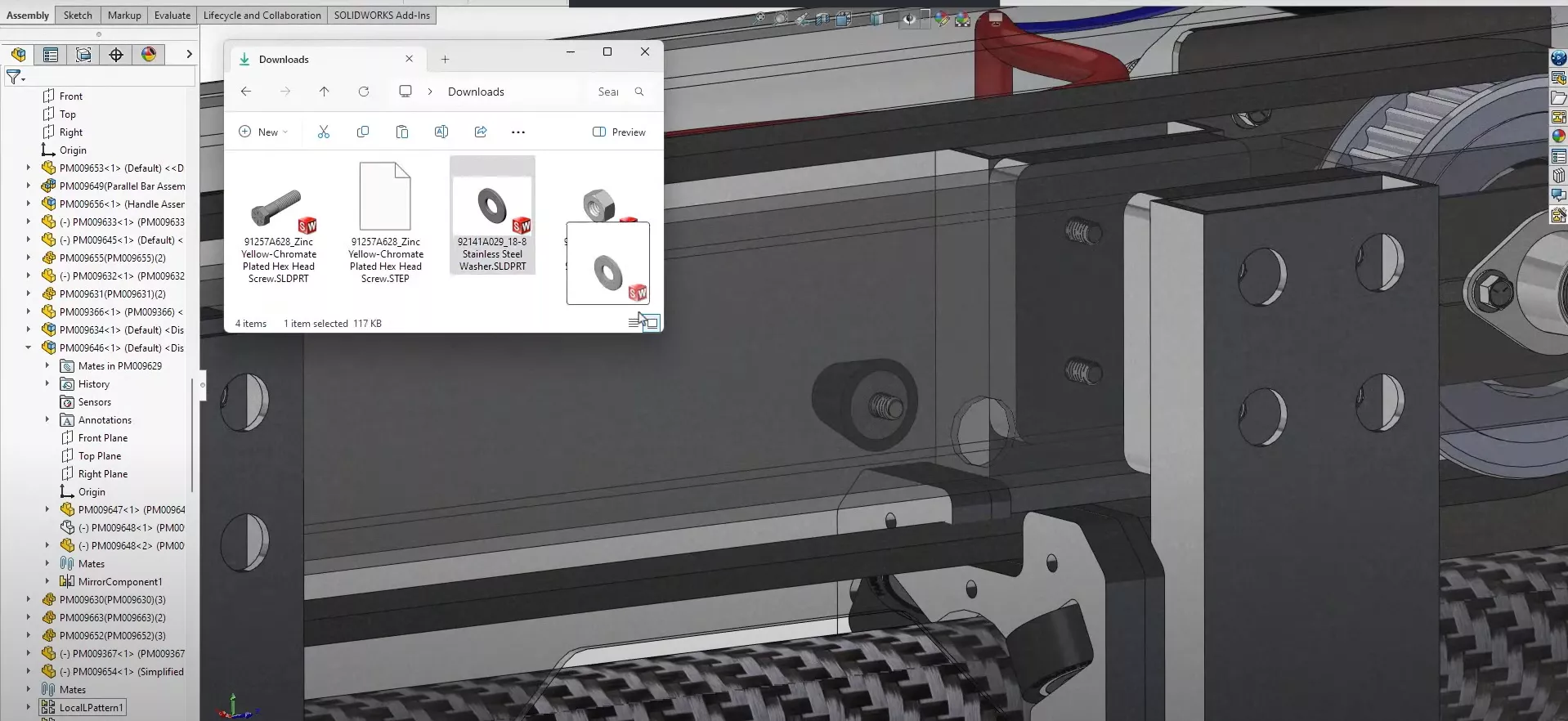

2. Click and drag
Click and drag your fastener into the assembly. This can be a fastener that is open in another window, a fastener from File Explorer, or a fastener that is already in the assembly (you can create a copy by holding down the CTRL key while you click and drag).

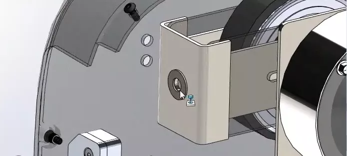

3. SOLIDWORKS recognizes the fastener
You will know that SOLIDWORKS recognized the part as a fastener if you see a sparkle icon next to your mouse cursor (shown below).
4. Automatic mates are applied
SmartMates are applied based on the geometry of the fastener and where it is being dropped.

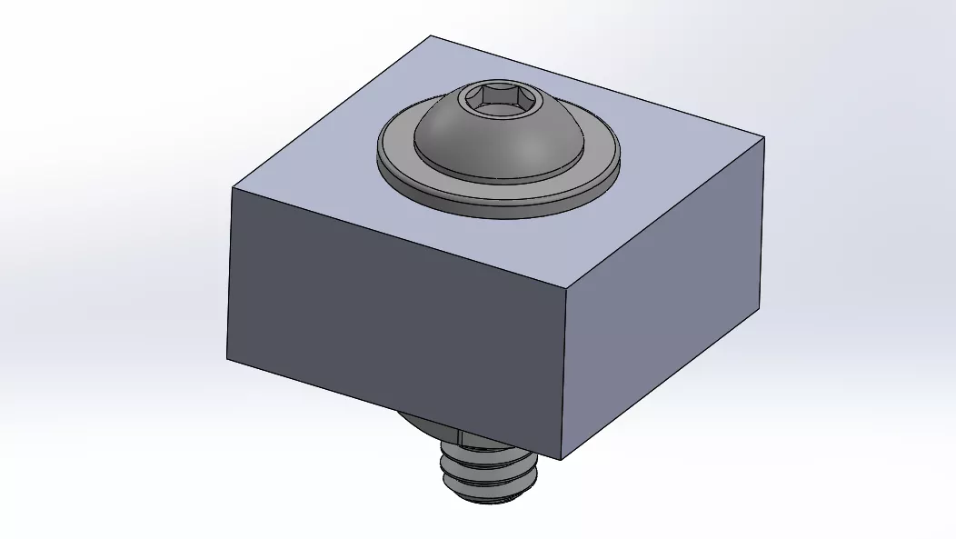

If you are having difficulties using AI fastener recognition at first, know that I did too. Like any new feature, there are still some kinks that need to be worked out. There was one bolt that I could not get SOLIDWORKS to recognize as a bolt. Look for the sparkle. If you don’t see the sparkle, then you'll know SOLIDWORKS is not recognizing the fastener, and you will need to apply the mates yourself.
Also, it took some practice for me to get the bolt and nut to place themselves on top of the washers instead of interfering with the washer. Try moving your mouse around a little as you bring the bolt or nut in to get it to snap on top of the washer instead of the part beneath.
