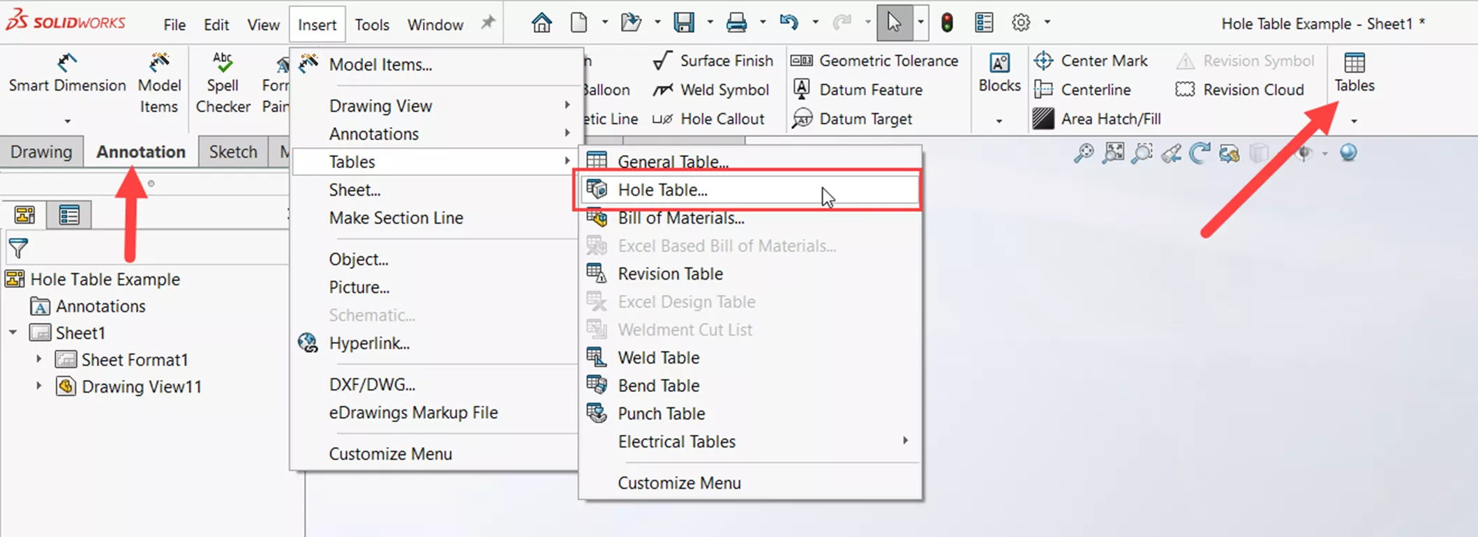

To start a Hole Table, go to Insert > Tables > Hole Table. You can also get there from the Annotation tab in the CommandManager.
Where to Access Hole Tables in SOLIDWORKS

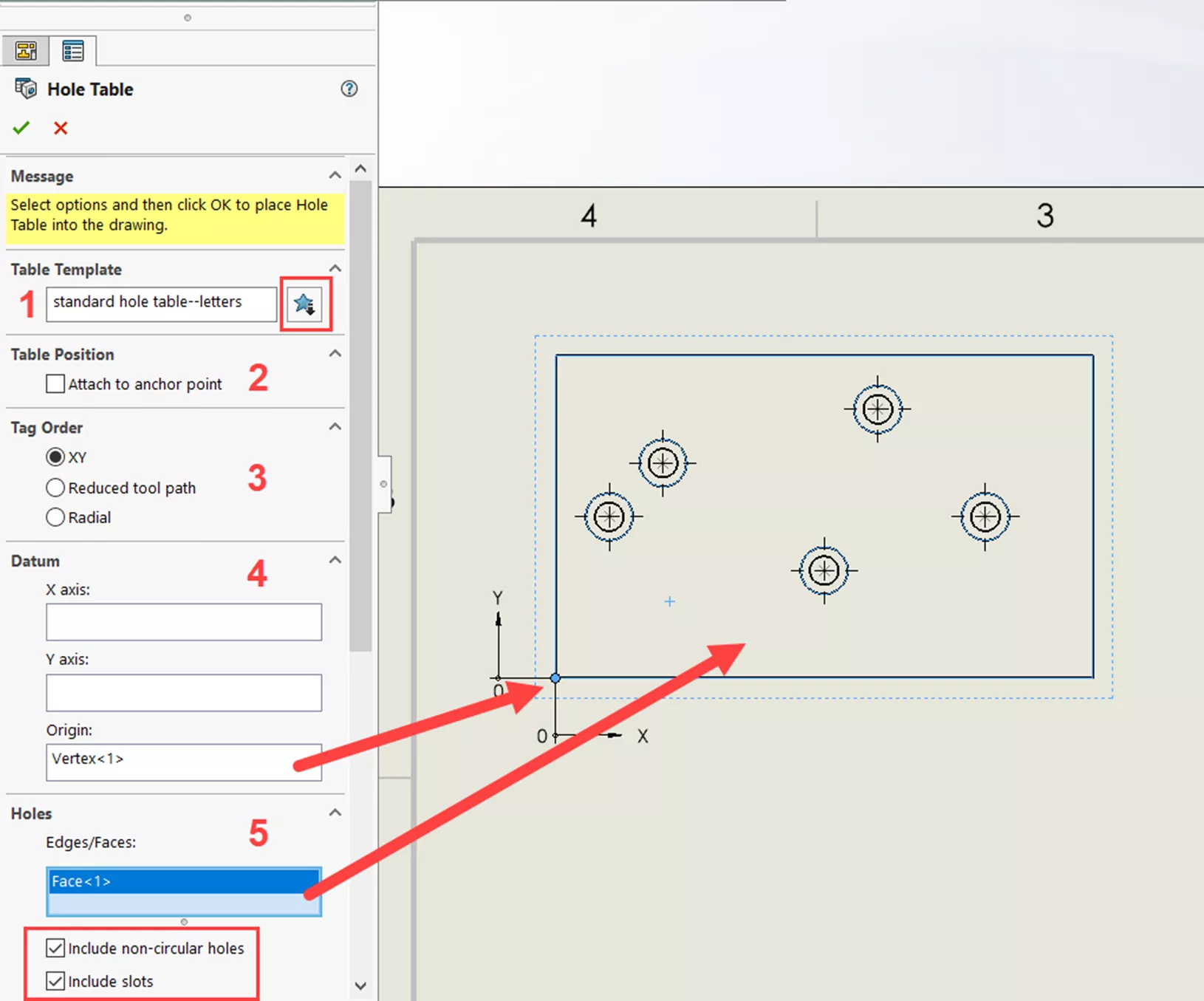

For this example, I will use the standard template (1). To use another, select the star icon under Table Template to browse for a template. As with any table in a SOLIDWORKS drawing, if there are set anchor points, the Attach to anchor point option can be selected to pin the table to that location (2).
You can also specify the order tags appear in the view under the Tag Order section (3). The XY option tags the holes according to their XY positioning closest to the selected datum. The Reduced tool path option looks at holes of the same size and tags them based on the shortest length between them, which helps minimize manufacturing time. The Radial option is generally used for lathe-turned parts (but can be used otherwise) and tags them radially from the origin.
The next section is for choosing where to place the datum (4). The easiest selection for the datum is to pick a specified origin; you can select any sketch point, vertex, or circular edge. In this example, I selected the bottom left corner of my part as the datum. You can also choose linear edges as X and Y directions to set this datum point.
In the Hole section, select the holes you want represented in the table (5), either individually (click an edge of each hole) or all the holes on a face (select a face with holes). In this example, I chose to select the face. Keep in mind that these selections can include more than just round holes if you check the options Include non-circular holes and Include slots.

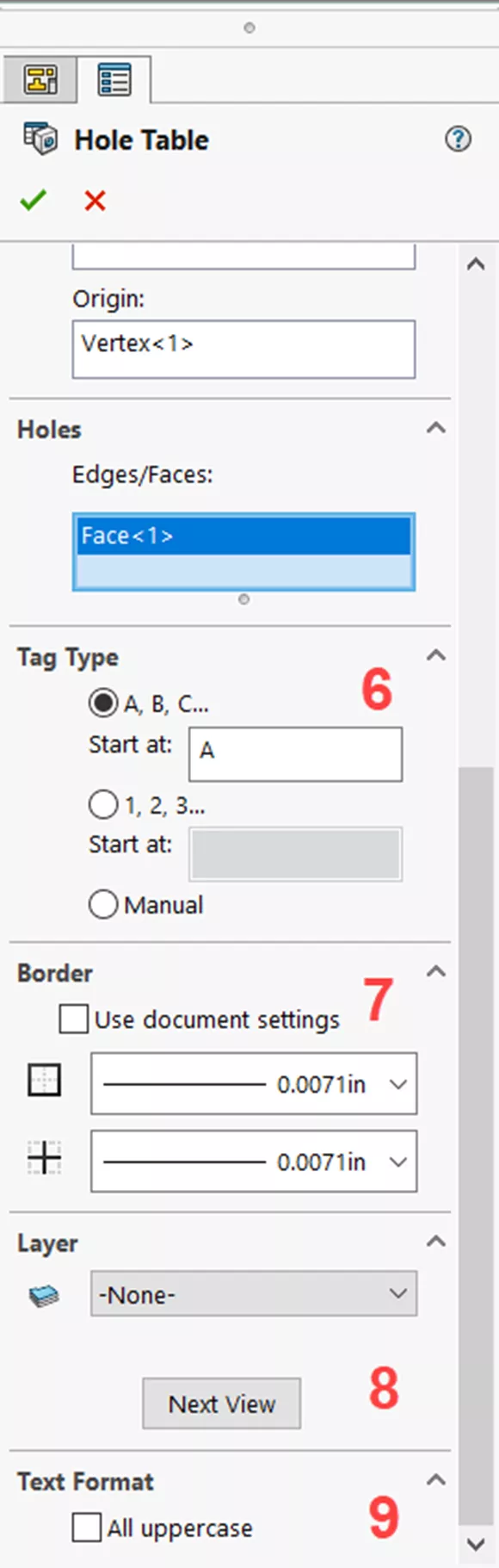

For the tag type, choose how you'd like each hole in the drawing view to be labeled (6). They can be organized alphabetically or numerically, or use the Manual option for full customization. From there, the remaining options to choose are border options (7), whether you want to add the table to a layer (8), and the appearance options for text in the table (9).

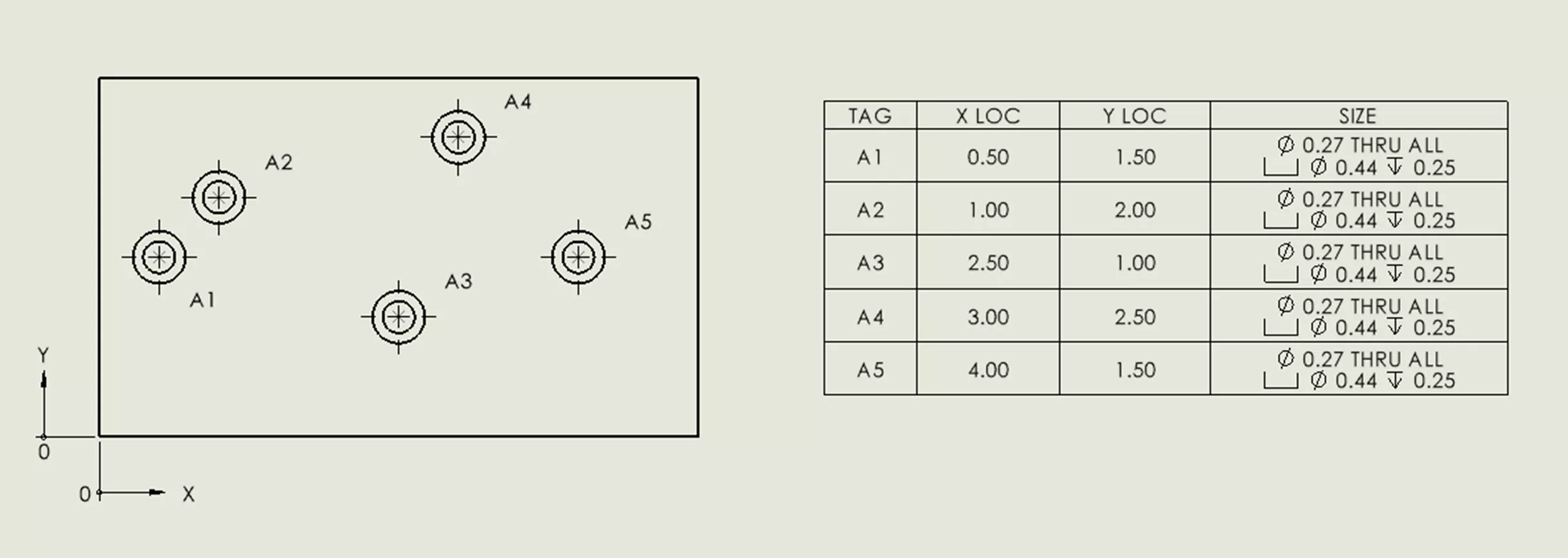

Once you’ve gone through all of those options and the table is accepted and placed, you will see the labels for each hole appear in the drawing view. If needed, the labels for these holes can be moved to more convenient locations.
SOLIDWORKS Hole Table Tutorial

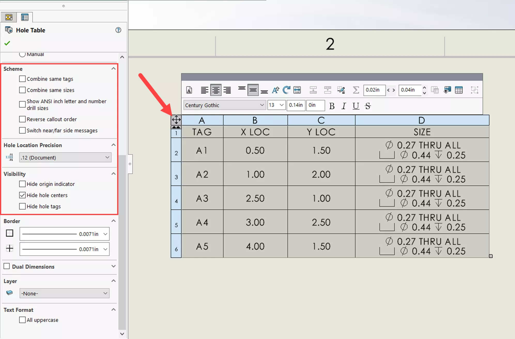

Once you place the table, there are more options for organizing it. To do so, click the arrow icon at the upper left corner of the table (below).
  • Scheme is used to organize the table.
  • Combine same tags will make the table much smaller but removes the locations of each of the holes. So, dimensions will need to be specified in the drawing view.
  • Combine same sizes keeps the table the same size but combines the cells the same size information.
  • Show ANSI inch letter and number drill sizes displays hole specification from the Hole Wizard information if they are Hole Wizard holes.
  • You can also choose to change the precision of the values in the table under Hole Location Precision, and the appearance of the drawing view under Visibility.

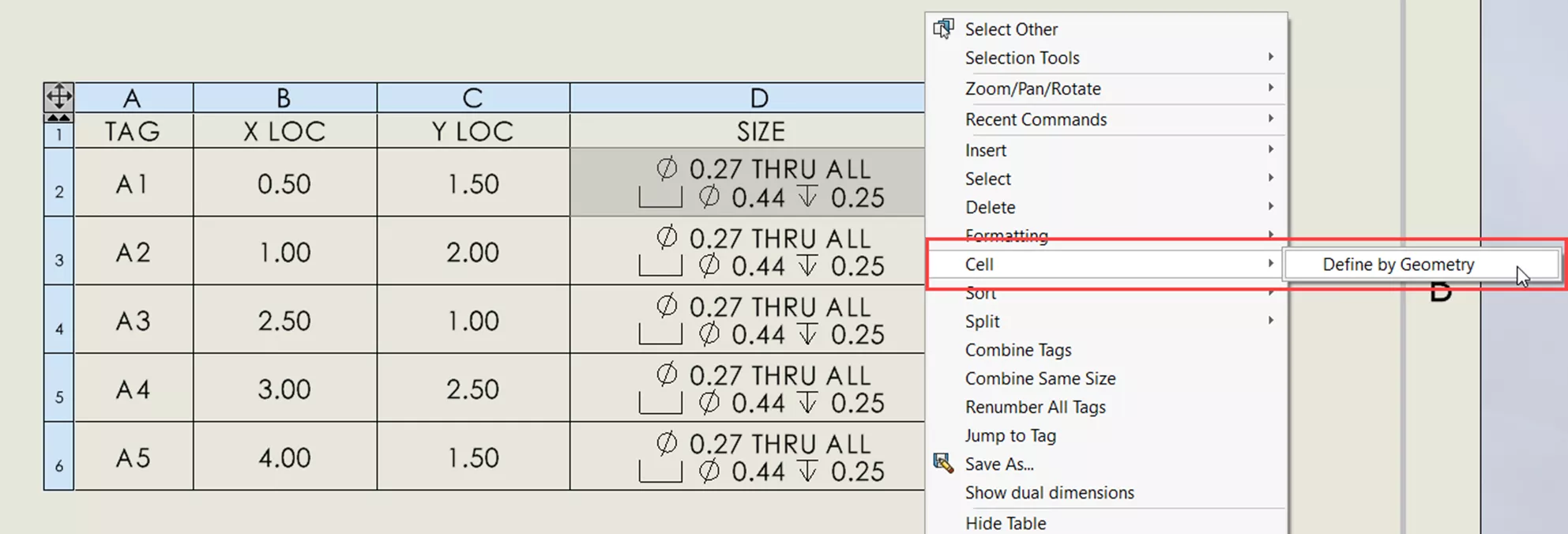

There are two options to define what is listed in the size column. It will either go by geometry or by Hole Wizard callout information for Hole Wizard holes. If you have Hole Wizard holes and want to show or hide the additional information, this can be changed by right-clicking on one of the size cells, then going to Cell, and choosing whether to define by geometry or the Hole Wizard.
Define SOLIDWORKS Hole Wizard Column Size

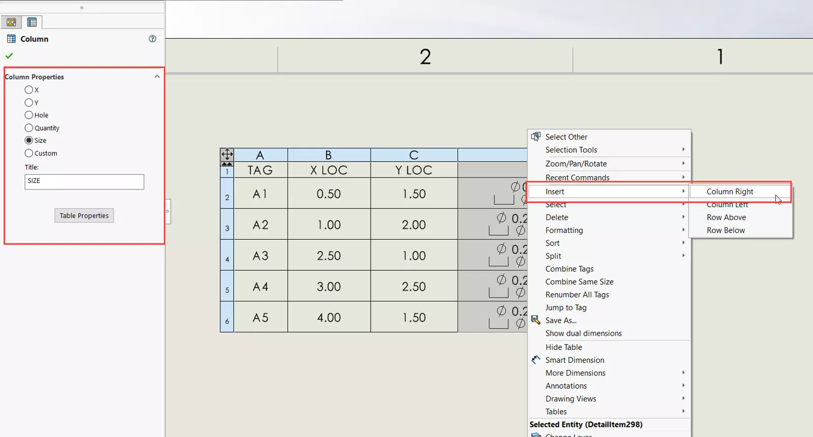

Other columns can be added to include more information. Right-click on a column and go to Insert > Column Right (or Left). Then, on the left-hand side of your SOLIDWORKS screen, the Column PropertyManager will appear and you can choose what you want the column to be.
SOLIDWORKS Hole Table Column PropertyManager
