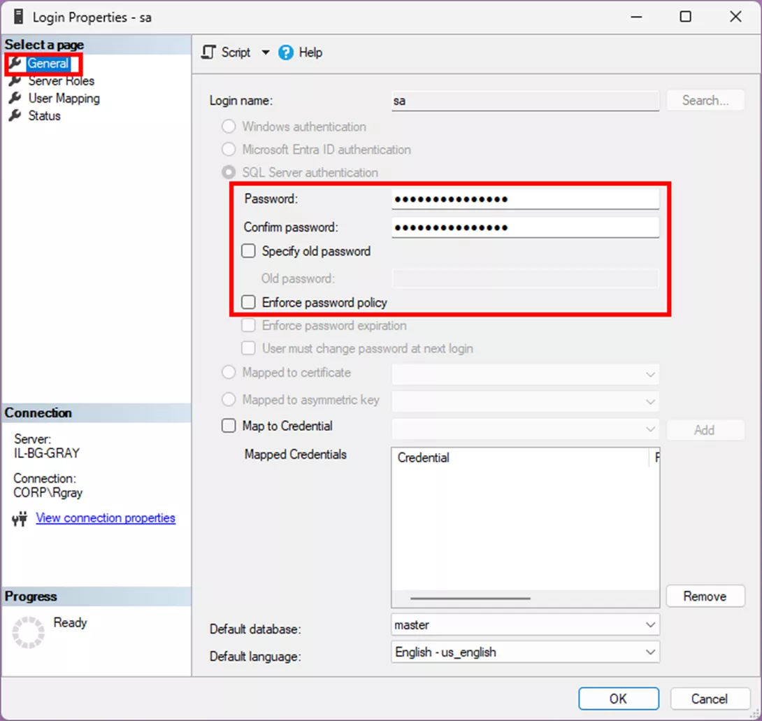

Log in to the SQL server as a Local Windows Administrator.

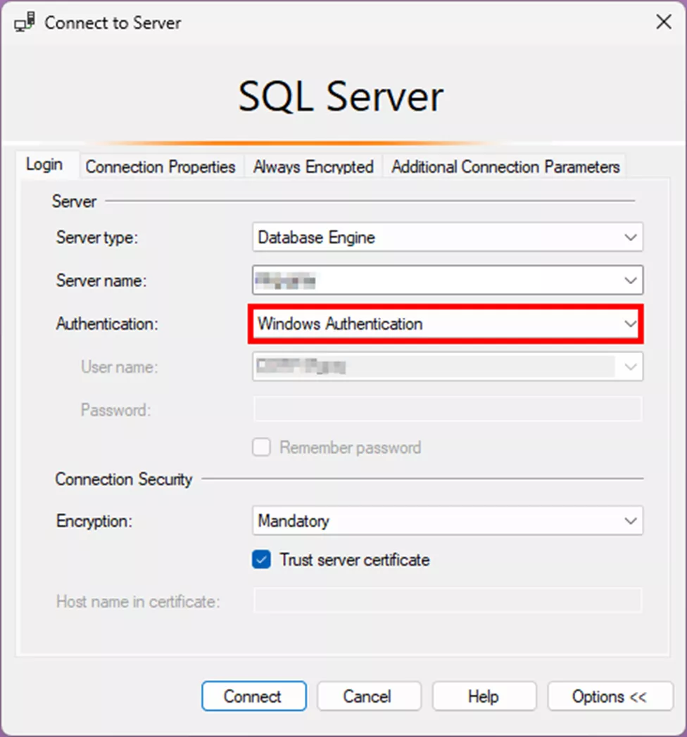

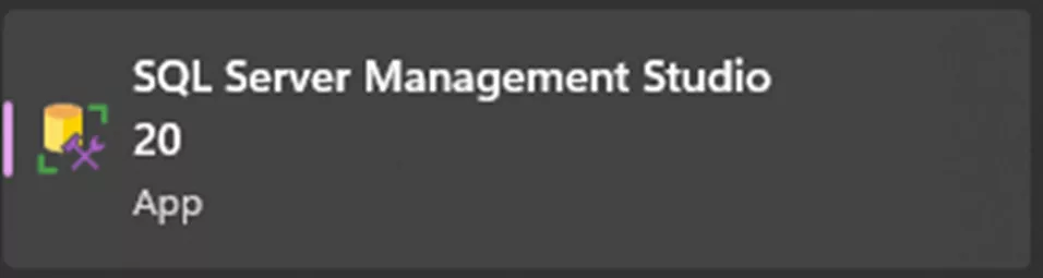

LaunchSQL Server Management Studioas an administrator. You can searchSSMSfrom the Windows Start menu, right-click it, and select theRun as Administratoroption.
SelectWindows Authenticationin the Authentication dropdown. Ensure thatTrust server certificateis checked. ClickConnect.

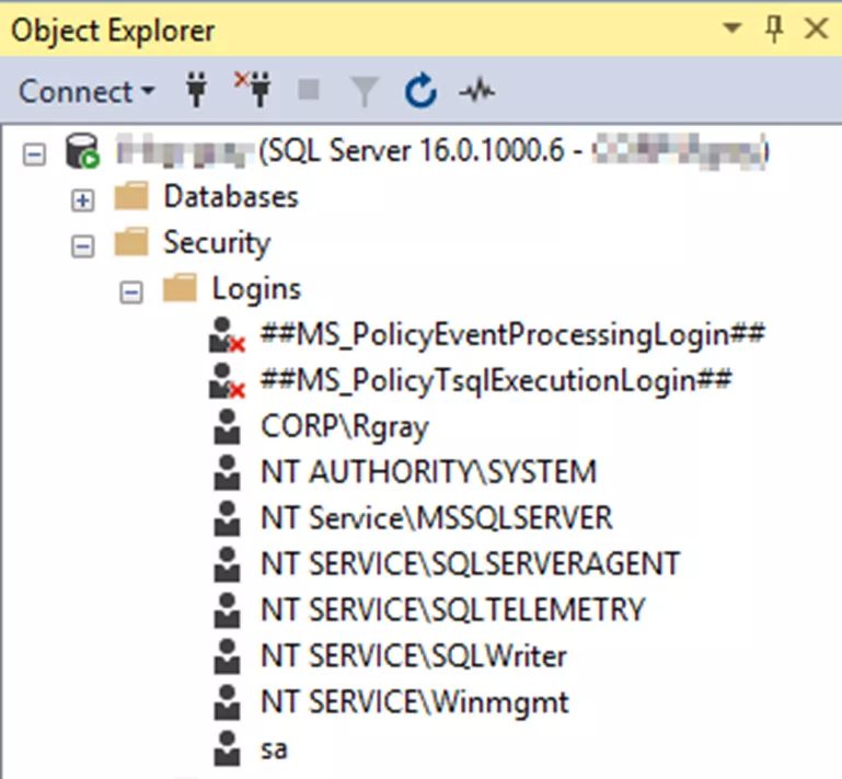

InObject Exploreron the left, expandSecurity>Logins.
Double-click the SA user to open the Login Properties dialog.
In the Login Properties dialog, delete any pre-filled credentials and type a new password in both thePasswordandConfirm Passwordfields.
Uncheck theSpecify old passwordandEnforce password policyboxes if they’re checked.
ClickOKto close the dialog.
CloseSQL Server Management Studioand relaunch it. You want to confirm that the new credentials work as expected.
Switch the Authentication field toSQL Server Authenticationand enter the new SA password you just created.

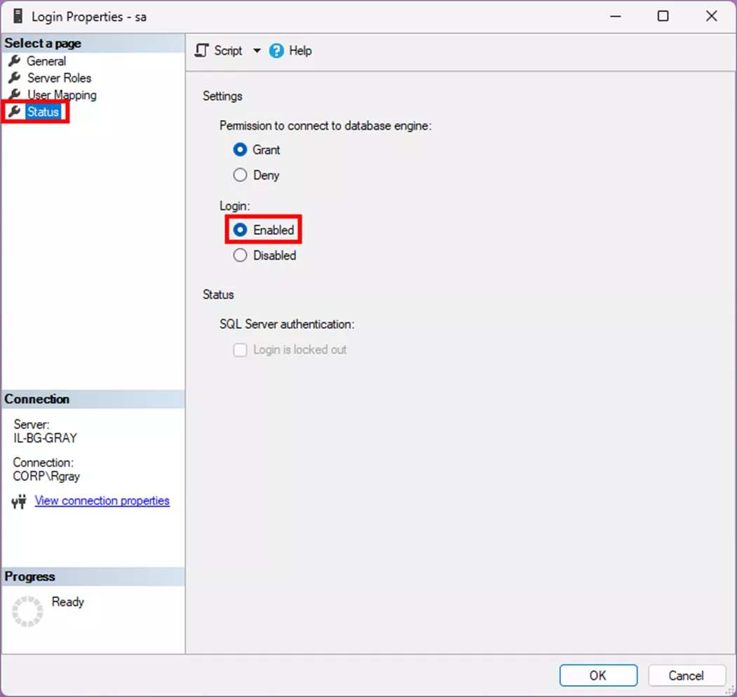

Tip: If you find you still cannot connect with the SA account after changing the password, you may need to go back into the Login Properties for SA and confirm the Login is set toEnabledunder theStatus section.

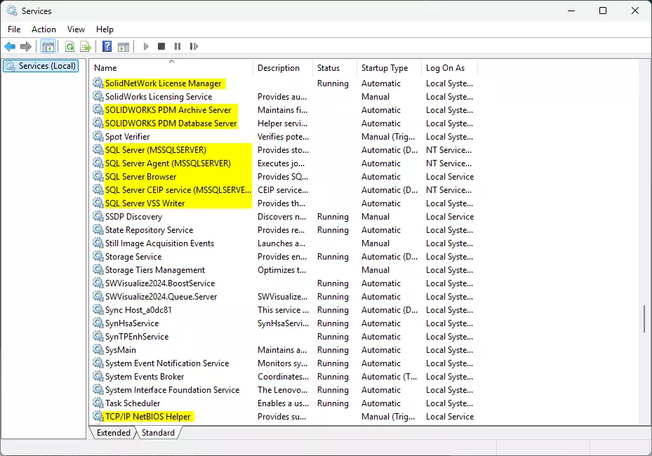

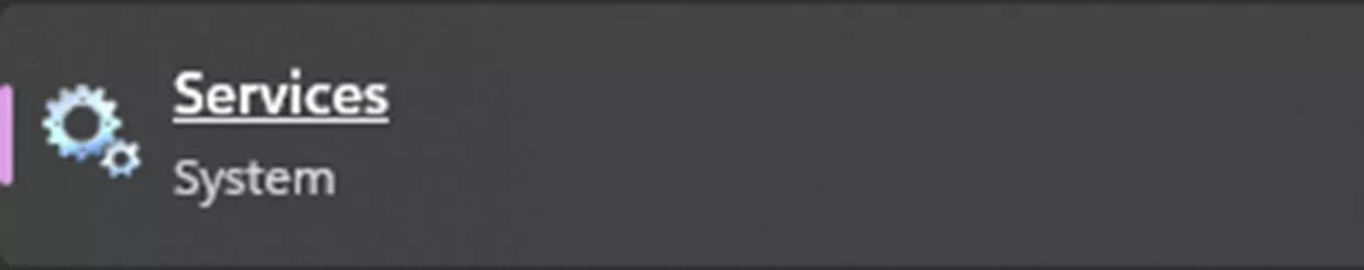

Log in to your SQL server as a local Windows admin. OpenServicesby searching the WindowsStartmenu for “services”.
Stop all the following services, if present. Note that for the PDM server services, you’ll need to go onto the server they’re hosted on to shut them off if SQL is housed separately from your other components.
SolidNetwork License Manager
SOLIDWORKS PDM Archive Server
SOLIDWORKS PDM Database Server
SQL Server (MSSQLSERVER)
Be sure to turn off any other SQL Server services with different instance names. They should show asSQL Server (InstanceName).
SQL Server Agent (All Instance Names)
SQL Server Browser
SQL Server CEIP Service (All Instance Names)
SQL Server VSS Writer
TCP/IP NetBIOS Helper

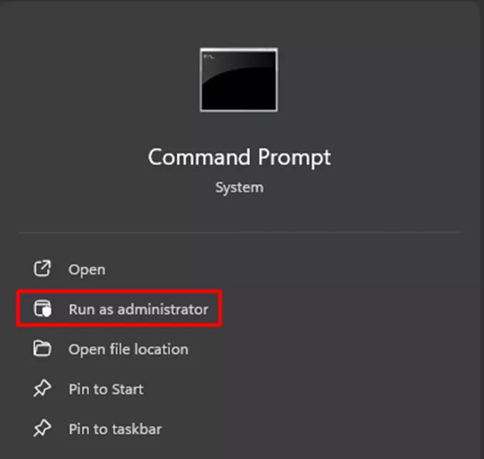

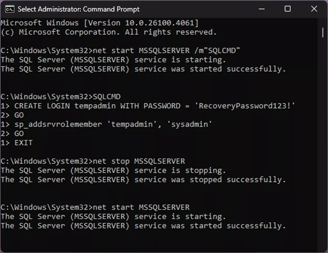

Once these are turned off, open a Command Prompt window as an admin. You can do so by searchingStartfor “CMD” and selectingRun as administrator.
In theCommand Prompt, type the following lines, hitting Enter between each line.
Note 1: These are case-sensitive! Be careful to match things up properly.
Note 2: If you use a named SQL instance, you’ll switch out “MSSQLSERVER” with “MSSQL$InstanceName” (where “InstanceName” is the name of your SQL instance).
net start MSSQLSERVER /m”SQLCMD” SQLCMD CREATE LOGIN tempadmin WITH PASSWORD = 'RecoveryPassword123!' GO sp_addsrvrolemember ‘tempadmin’, ‘sysadmin’ GO EXIT net stop MSSQLSERVER net start MSSQLSERVER
Let’s walk through what we just did:
This will start the SQL server in single-user mode, which only allows a single user/process to connect to it. We specifically only allow that single connection to happen through “SQLCMD”, which is a command-line utility for executing SQL. If you have a named instance of SQL, you would replace “MSSQLSERVER” here with “MSSQL$InstanceName”.
SQLCMD
This launches the SQLCMD utility.
This creates a user called “tempadmin” with the password “RecoveryPassword123!” and executes the command. We use this password to satisfy most complexity requirements, but depending on your environment, you could just use ‘password’ if you prefer.
This adds the “sysadmin” role to the tempadmin user and executes the command. This role is what will allow us to edit the SA user.
EXIT
We exit the SQLCMD utility.
And finally, we stop the SQL service and restart it normally so it’s no longer in single-user mode.

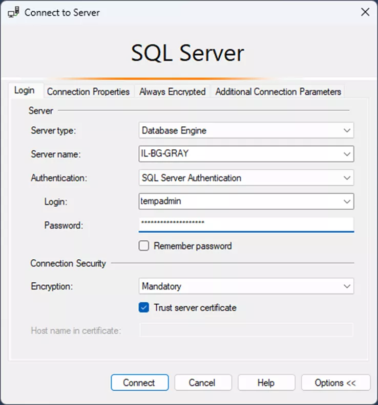

Now that you've created a new sysadmin user, you can log intoSQL Server Management Studiousing those credentials to reset your SA user.
OpenSSMSby searching for it from theStartmenu.
Set theAuthenticationtype toSQL Server Authentication,enter the tempadmin credentials, and clickConnect.
Once logged in, go toObject Exploreron the left and expandSecurity>Logins.

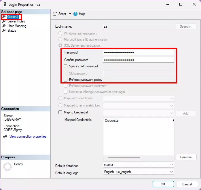

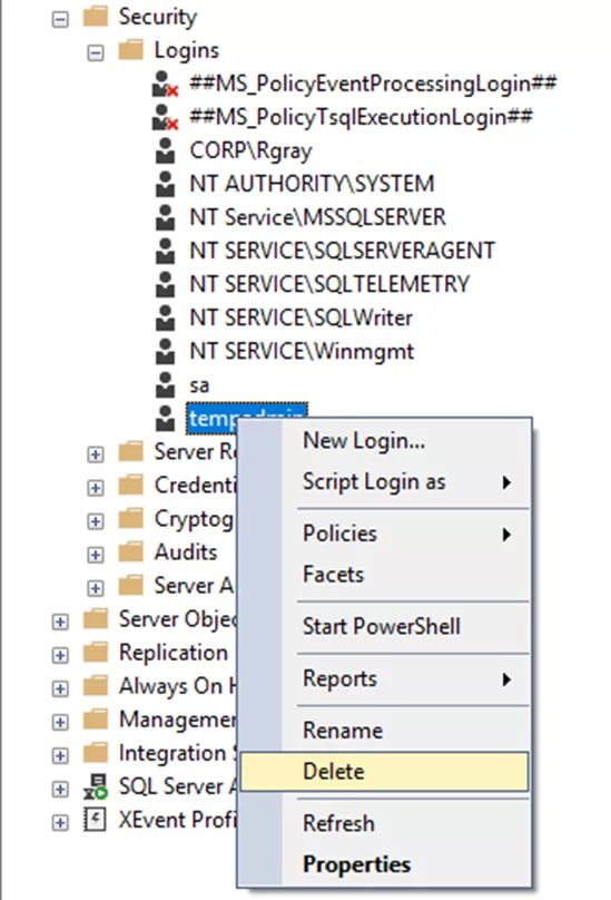

Go back intoObject Explorer>Security>Logins.
Right-click the tempadmin user you created > Delete. This ensures you’re not leaving a potentially unsecured system admin SQL user behind.

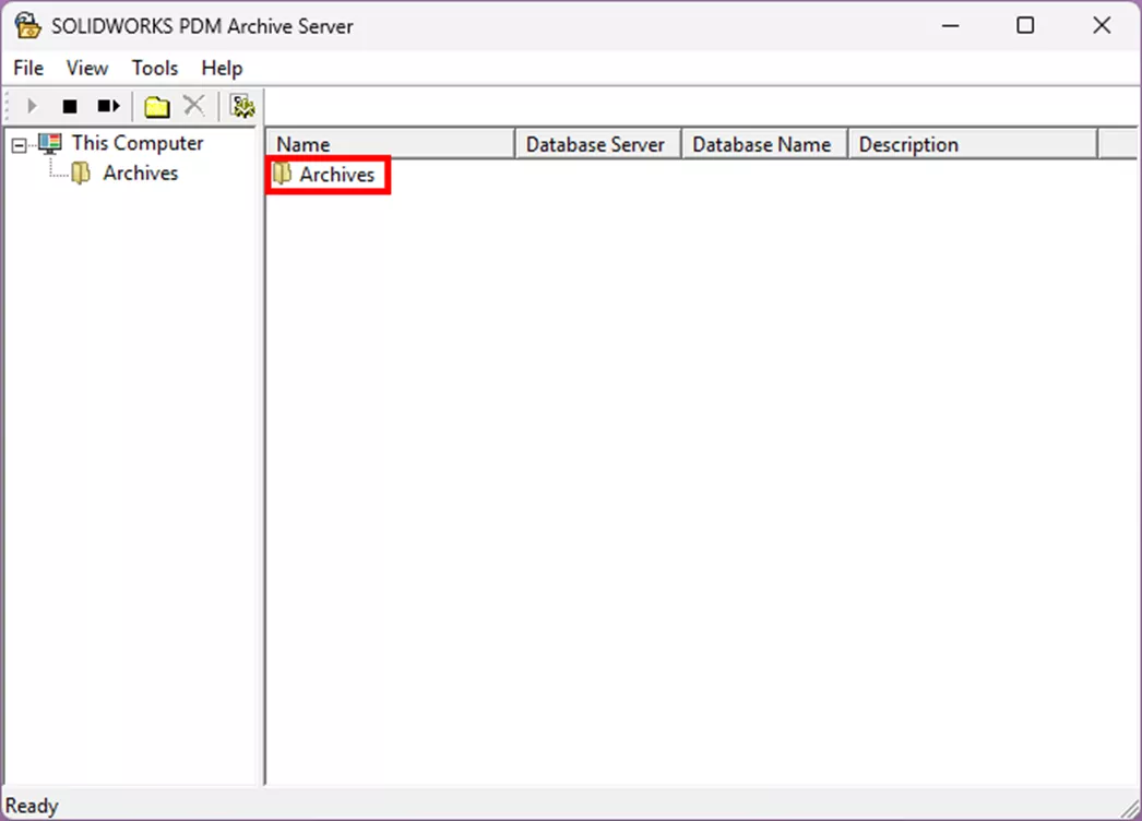

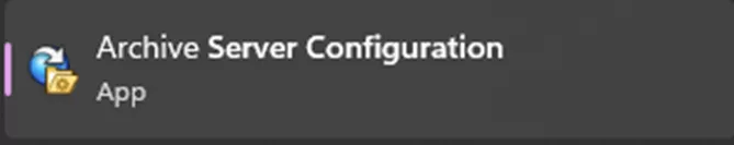

On the server hosting your archive service (if separate from the SQL server), open theArchive Server Configurationtool. This is located in the Windows Start menu under the SOLIDWORKS PDM folder.

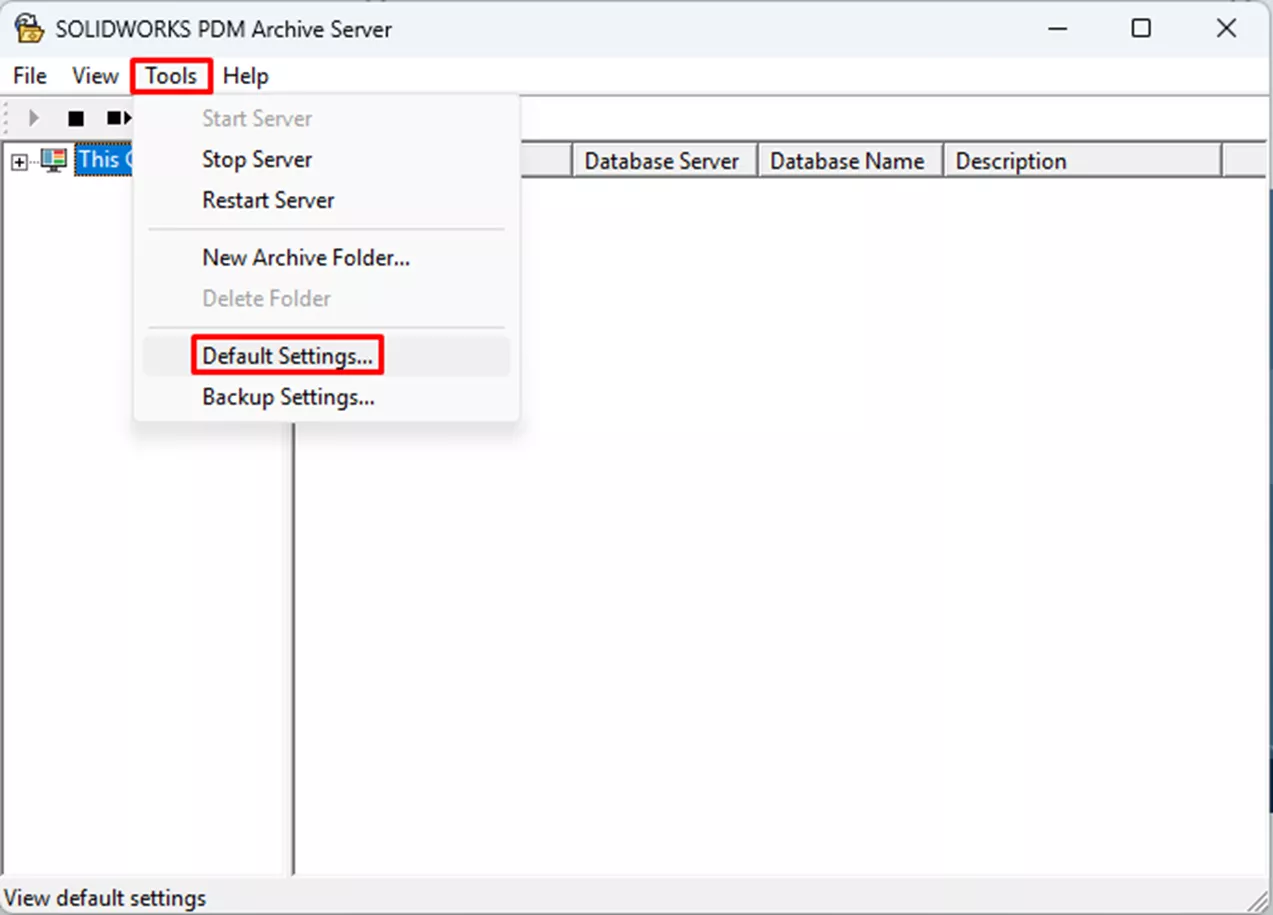

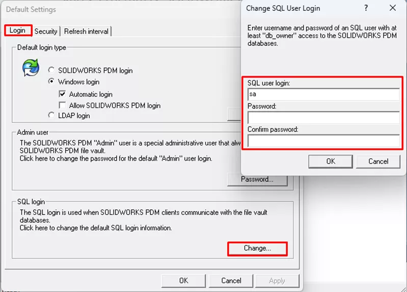

First, you'll update the default server settings. Go toTools>Default Settings.
Under theLogintab> SQL Login, click theChange…button. Enter the new SA password and clickOKtwice to get back to the main Archive Configuration screen.

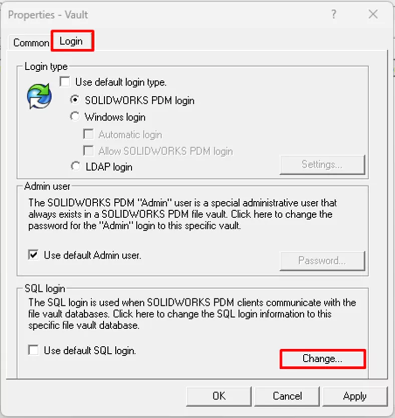

Then, you'll update the vault-specific SQL login for each vault on your server. Double-clickArchives.
Right-click the vault name >Properties.
Go to theLogintab and clickChange…under theSQL loginsection.
If theUse default SQL loginbox is checked, you can skip this step. The vault is using the server default password.

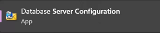

On the server hosting your PDM Database Service (this is separate from SQL and could be on either the archive or SQL server if they’re separate), open the Database Server Configuration tool. This is located in the Windows Start menu under the SOLIDWORKS PDM folder.
In the Database Service dialog, enter the new SA credentials and clickOK.

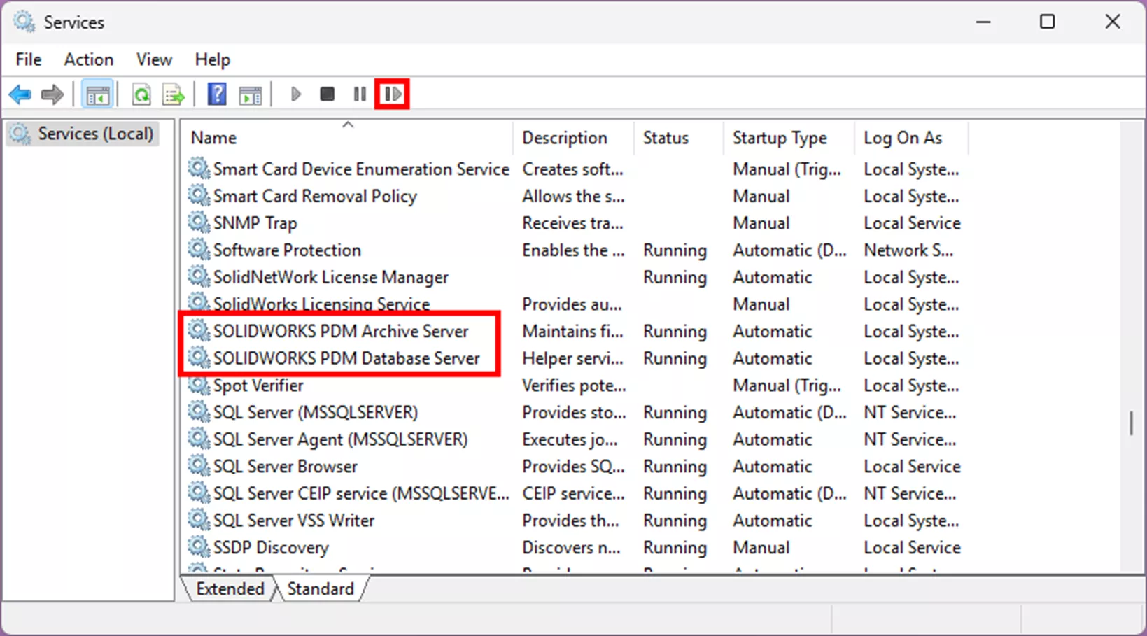

Once both the Archive and Database configurations are updated, you’ll want to go into the Windows Services menu (type ‘services’ into the Start menu search) and restart both the Archive and Database Services to apply the changes.

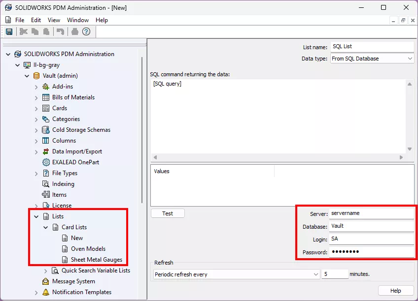

SQL Card Lists
If you utilize SQL Card lists, you’ll also want to go into theAdministrationtool underLists>CardListsand update the credentials there if you’re using the SA account to connect.

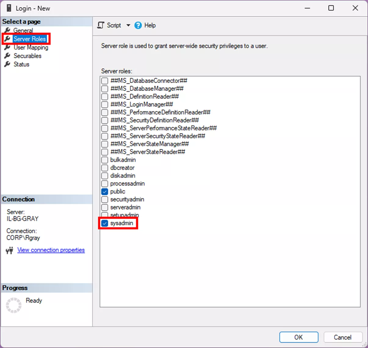

Go intoSSMS>Object Explorer>Security>Logins.

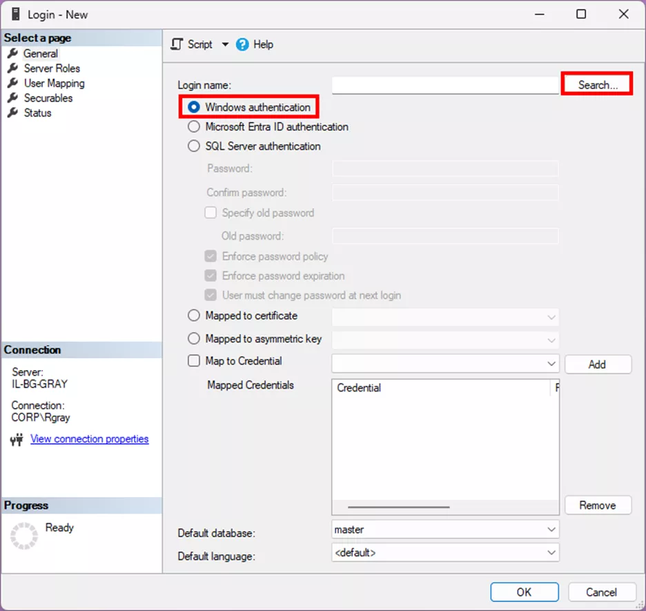

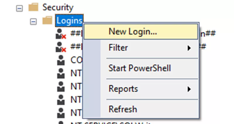

Right-clickLogins>New Login…

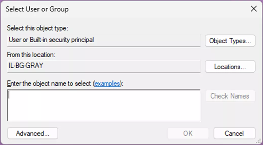

Ensure the login type is set toWindows authenticationand clickSearch…
Enter the local admin or domain admin/admin group and clickOK.
Go to theServer Rolestab and check ‘sysadmin’.
When done, clickOK.
