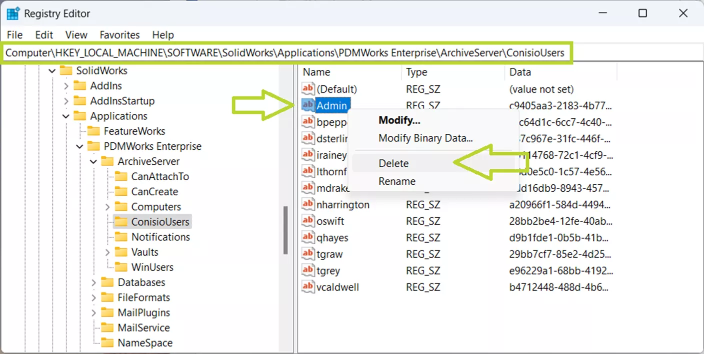

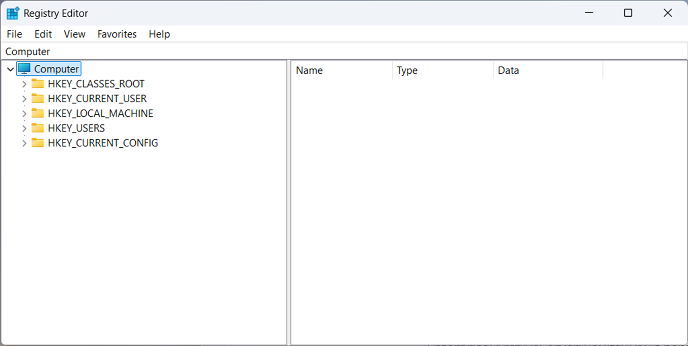

  2. Open the Registry Editor.
    Reset Lost PDM Admin Password Registry Editor
  3. Delete the Admin user in the following keys if it exists:
    1. HKEY_LOCAL_MACHINE\SOFTWARE\SolidWorks\Applications\PDMWorks Enterprise\ArchiveServer\ConisioUsers
    2. HKEY_LOCAL_MACHINE\SOFTWARE\SolidWorks\Applications\PDMWorks Enterprise\ArchiveServer\Vaults\[vault name]\ConisioUsers
      Registry Editor SOLIDWORKS PDM Admin Password Reset

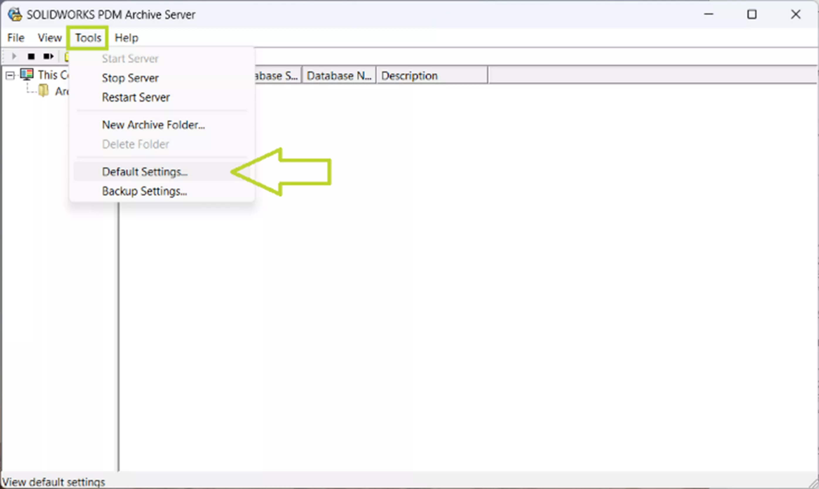

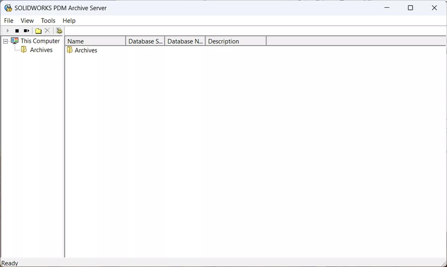

  1. Open the Archive Server Configuration app.
    SOLIDWORKS PDM Archive Server Admin Password
  2. Select Tools > Default Settings…
    SOLIDWORKS PDM Archive Server Default Settings

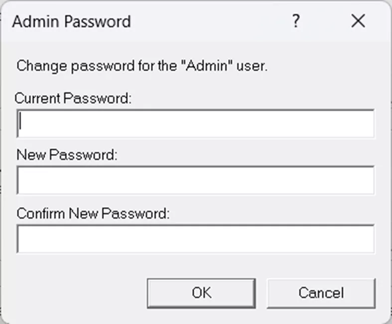

  3. In the Login tab, under the Admin user section, select Password…
    SOLIDWORKS PDM Reset Lost PDM Admin Password

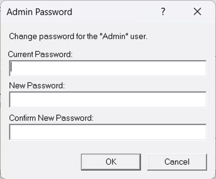

  4. Leave the Current Password field blank and type your new password in both the New Password and Confirm New Password fields.
    SOLIDWORKS PDM Admin Password Reset Fields
  5. Click OK to save your new password and OK to close the Default Settings dialog box.

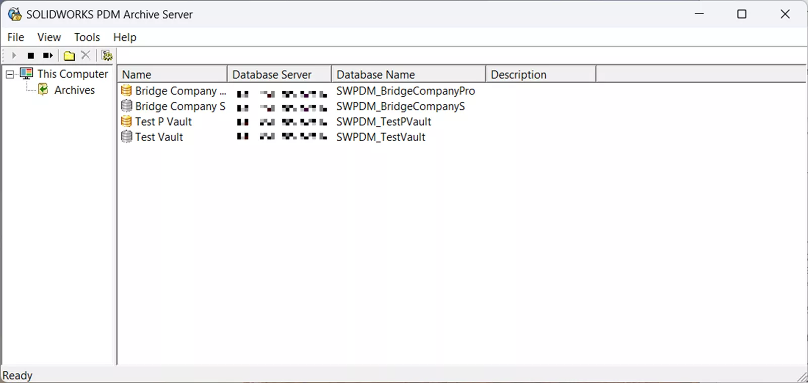

    Open SOLIDWORKS Archive Server Configuration App
  2. Expand Archives folder.
    SOLIDWORKS PDM Archive Folder

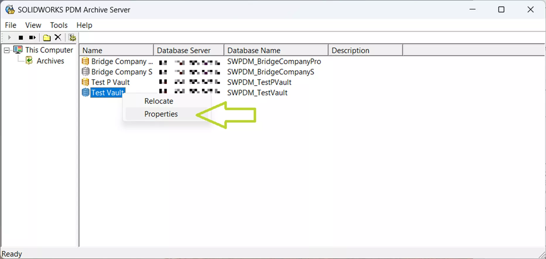

  3. Right-click on the vault name and select Properties.
    Properties Option SOLIDWORKS PDM Archive Server

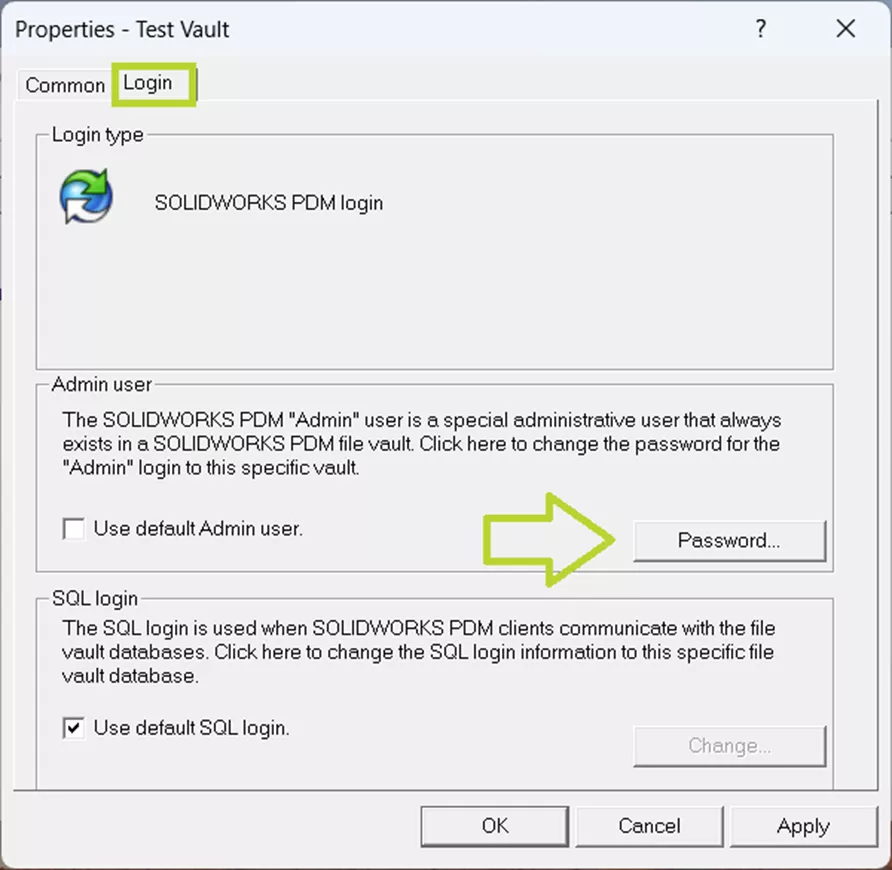

  4. In the Login tab, under the Admin user section, select Password…
    1. Note: If the Password… box is greyed out and the Use default Admin user box is checked, follow the Global Admin Login steps instead or uncheck the box to begin using a vault-specific Admin password.
      SOLIDWORKS PDM Admin Password Rest Test Vault
  5. Leave the Current Password field blank and type your new password in both the New Password and Confirm New Password fields.
    Confirm New Password Fields SOLIDWORKS PDM Admin Reset
  6. Click OK to save the new password, and OK to close the Properties dialog box.
