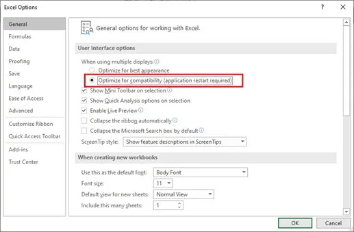

This setting optimizes the display for dual monitor and docking station setups. Follow the steps below to enable this option.

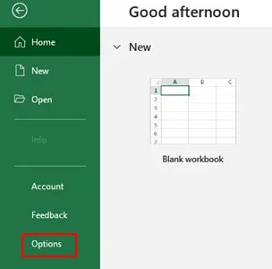

  • Launch Excel
  • On the home page, select Options in green on the left
    Troubleshooting Excel Issues within SOLIDWORKS
  • Within General>User Interface, enable the option Optimize for Compatibility and click OK
    General Options for Working with Excel
  • Close Excel and restart SOLIDWORKS to test.

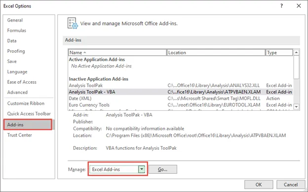

  • Turn off any Excel and COM add-ins
  • Close Excel and retest
    View and Manage Microsoft Office Add-Ins

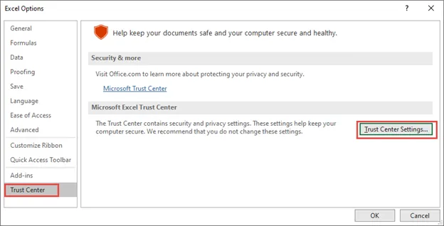

  • Disable any files generated in the XLStart folder (for Excel 2007, go to Office Button -> Excel Options -> Trust Center -> Trust Center Settings -> Trusted Location
  • Temporarily disable trusted locations
  • If this resolves the issue, you will need to browse to the Excel XLSTART folder and remove files, and test to determine which is causing the issue.
    Excel Trust Center Settings

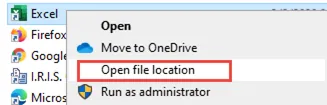

  • Search for Excel in the Windows search bar, then right-click Open file location, which navigates to the start menu programs in file explorer
    64 bit Office Installed
  • Right-click the Excel shortcut and choose Open file location again to navigate to the installation directory
    Microsoft Excel Open File Location
  • In the Excel installation directory, the file-path should look something like this: C:\Program Files\Microsoft Office\root\Office16
  • If instead of Program Files you see Program Files (x86) this indicates a 32-bit version of office

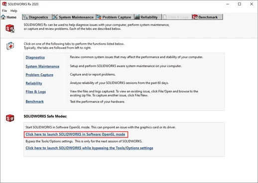

Disable Alternative Graphics Device
SOLIDWORKS can have many issues when there are multiple graphics devices present. We will use SOLIDWORKS Rx to determine if the issue is graphics related.
  • Close SOLIDWORKS and launch SOLIDWORKS RX. You can find SOLIDWORKS RX by searching for Rx in the windows search bar.
Related Article: Checking Your Graphics Card with SOLIDWORK Rx
On the Home page of the Rx, towards the bottom, there are two safe modes that can be used to assist in diagnosing issues within SOLIDWORKS.
  • Launch SOLIDWORKS in OpenGL mode. This forces your CPU to do what your GPU normally does when running SOLIDWORKS
  • Retest the issue you are having with Excel. If the problem has gone away, the issue is graphics related

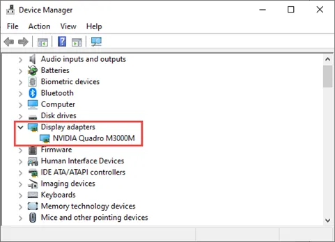

  • Next, determine what graphics devices you have on your computer. This can be done by accessing the device Manager and expanding Display Adapters
    Device Manager Display Adapters
  • If you see more than one device such as an NVIDIA card and an Intel HD Graphics card, it could be related to the problem. You will want to reach out to your IT department to turn off ‘switchable graphics’ if applicable or to disable the HD Graphics device.
