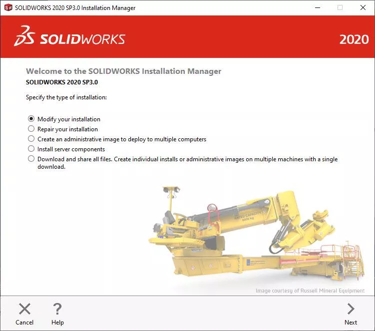

When the SOLIDWORKS Installation Manager runs into a problem, it generates a set of installation logs in the form of a zip file that will be presented to you. These files are great, and sometimes they’re all that we need. Here’s how to find them.

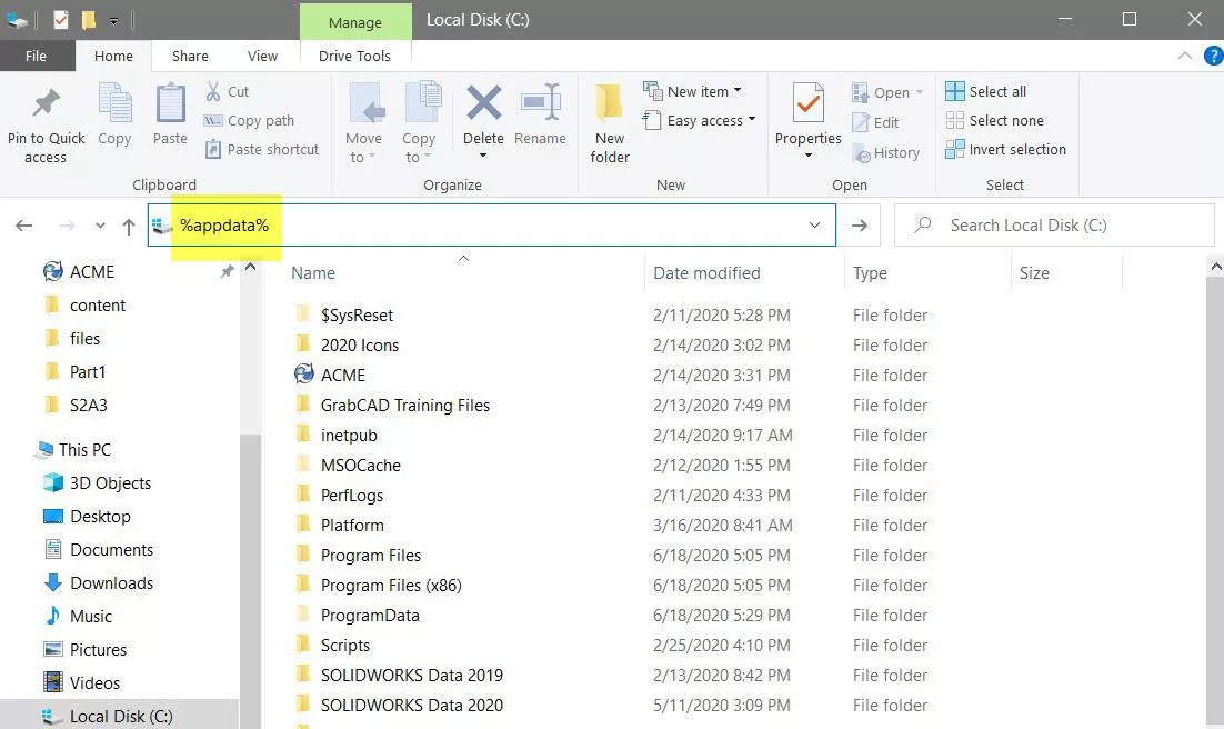

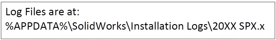

Open Windows File Explorer and search for %appdata%. This will open the file path for AppData > Roaming. Then navigate to SOLIDWORKS > Installation Logs and open the folder for the version that you're troubleshooting. This will retrieve the standard installation logs.
Inside this folder is a log file for every time SOLIDWORKS tries to install, modify, repair, or uninstall. To make things simple, package all of them as a zip file. Hold shift on your keyboard and use your mouse to select all of them, then right-click and select Send to then Compressed (zipped) folder. You can then email this zip file.

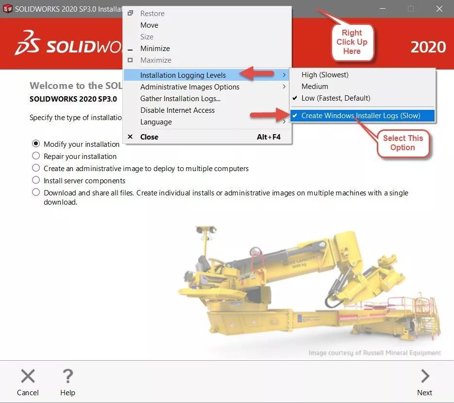

SOLIDWORKS does not generate verbose installation logs by default, but they’re only a few mouse clicks away. With the SOLIDWORKS Installation Manager open, right-click on the header, select Installation Logging Levels, and check Create Windows Installer Logs. This turns on verbose logging, which takes longer to run but gathers additional data that may be necessary to figure out the problem.
The verbose installation logs are automatically saved in the same location as the standard logs, so just follow the steps for retrieving the standard logs and send the zip file to your VAR.
