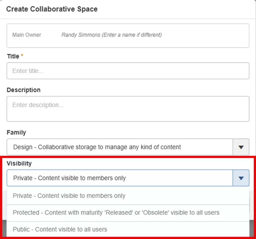

Visibility Settings
One of the first decisions when creating a Collaborative Space is its visibility setting, which determines who can see and interact with the space's content. The visibility can be modified later if needed.
Visibility Options in 3DEXPERIENCE Collaborative Space
  • Private – members must be explicitly added to the space to view or interact with its content. Data in the space will always remain Private regardless of its maturity state. Recommended for projects where design content needs to be limited to a specific team.
  • Public – all data in the space is available to everyone inside and outside the organization. Recommended for standard parts and libraries.
    • Important: If a Collaborative Space is changed to Public, any object shared within that space also becomes public.

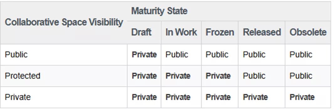

  • Protected – data in the space starts as private data, but when it reaches a Released or Obsolete maturity state, it will be visible even to non-members of the space. Members explicitly added to the space can view all objects.
As you can see from the explanations above, the collaborative space visibility is only part of the determining factor in whether the content in the space is truly Public or Private. The maturity state of the data is the other factor.
The following table shows whether content is truly public or private based on the visibility of the collaborative space and on the maturity state of the content.

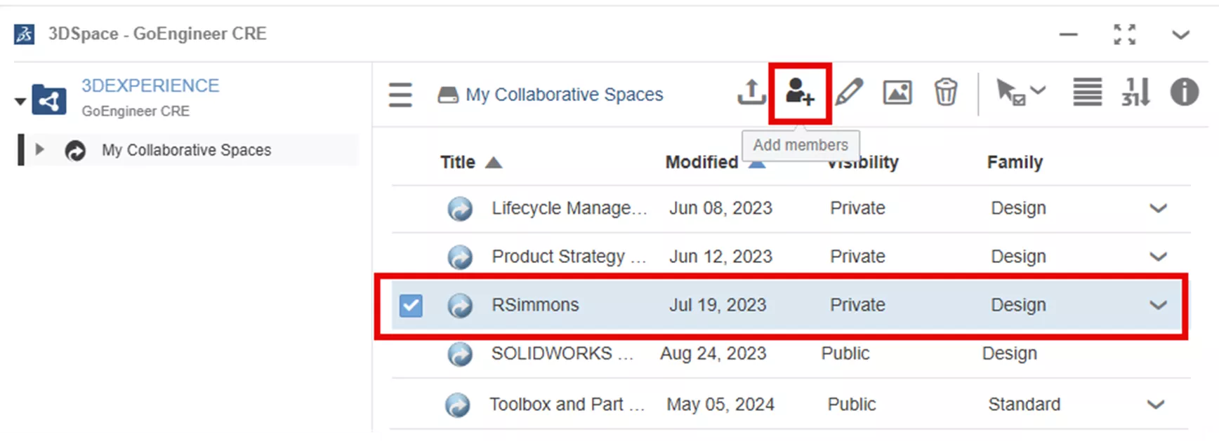

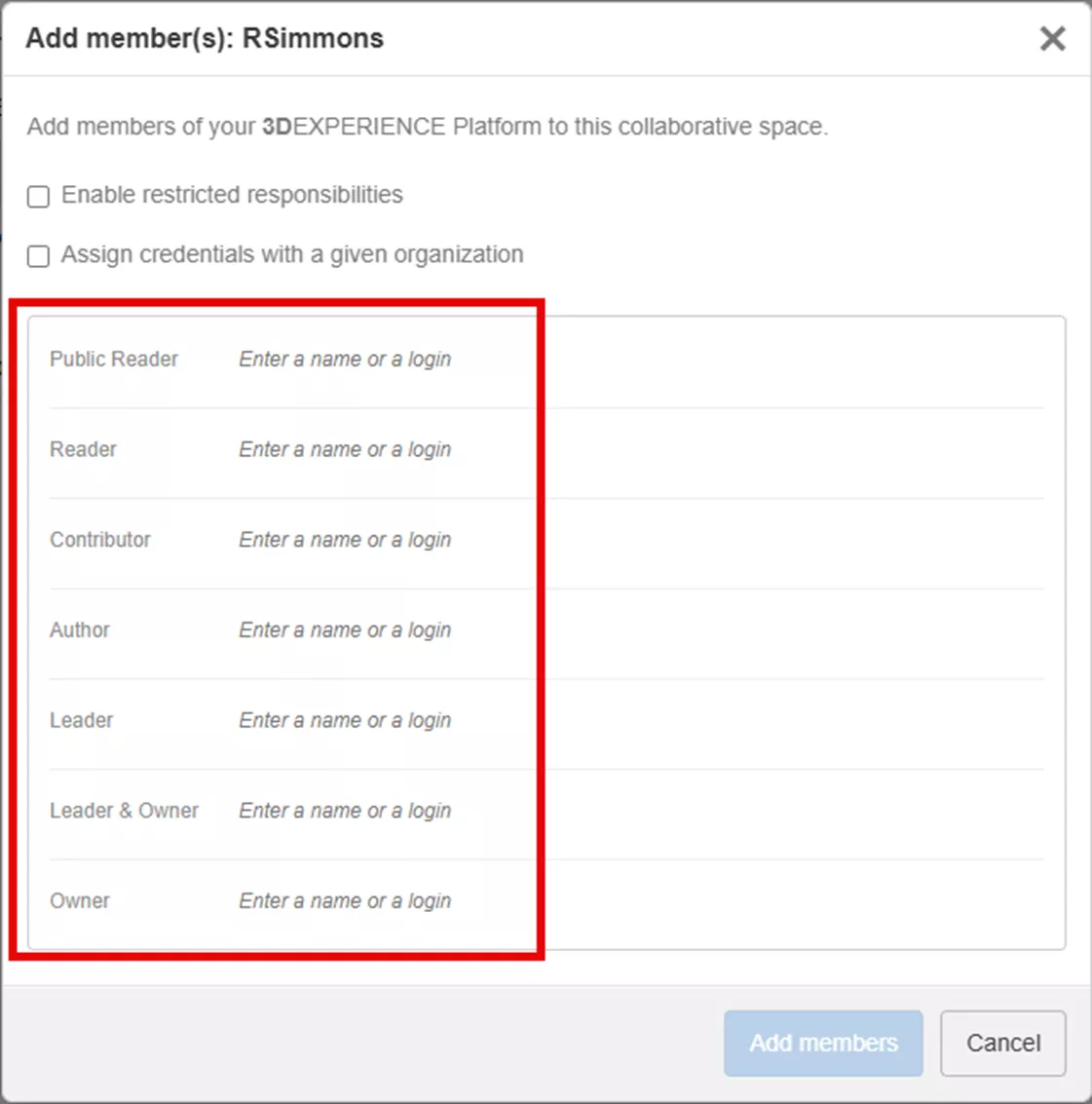

Once a Collaborative Space is created, members (or groups of members) can be invited to the space. This can be done through several locations, including the Collaborative Spaces Control Center in the Administrator Console. Here, we’ll use the 3DSpace app:
  1. Select the Collaborative Space in the list and use the Add Members icon from the upper toolbar.
    How to Add Members in 3DEXPERIENCE Collaborative Spaces

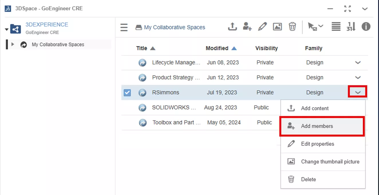

  2. Alternatively, use the dropdown menu on the far right of the list to add members.
    Add Member in 3DEXPERIENCE Collaborative Space Using Dropdown Menu

Permission Levels
Permissions within a Collaborative Space determine the level of interaction members have with stored data. These roles are listed in order of increasing control, with each level inheriting permissions from the previous one.
View Permission Levels in 3DEXPERIENCE Collaborative Space
  • Public Reader (Views Data): Can view (read/open) content (depending on maturity state), but only to the specific collaborative spaces the user is invited to. Cannot create or modify content. Good for a supplier/contractor.
  • Reader (Views Data): Can view (read/open) content (depending on maturity state) in all Public spaces and any Private spaces he/she has been invited to. Cannot create or modify content.
  • Contributor (Evaluates data, but doesn’t change it): Can create objects that augment existing data. Has read-only access to documents, folders, and discussions. Cannot modify, revise, or change maturity states.
  • Author (Creates data): Can create and modify content. Cannot move data to Released or Obsolete states. Cannot lock products in Released state.
  • Leader (Manages content (libraries, templates, etc.)): Has full control over the Collaborative Space, including deleting data, changing maturity states, managing settings, and adding/removing members.
  • Owner: Has administrative rights within the space, including managing access, setting permissions, and performing administrative tasks.

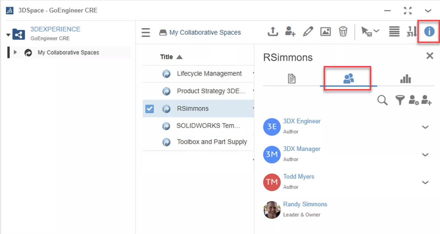

To view the permissions of existing members:
In the 3DSpaces app, select the Collaborative Space, click the “i” (information) button, then navigate to the Members tab.
View Permissions of Existing Members in 3DEXPERIENCE Collaborative Space

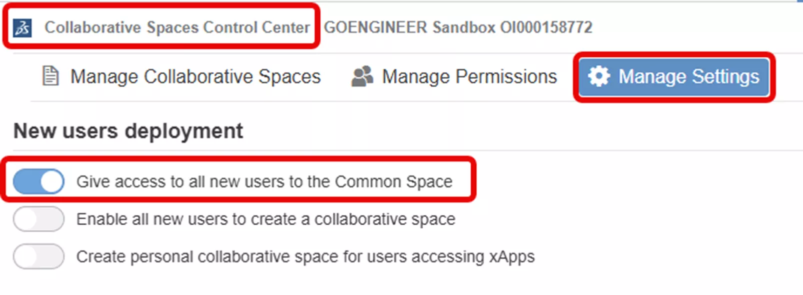

Permissions can also be viewed in the Collaborative Spaces Control Center within the Administration Console.
