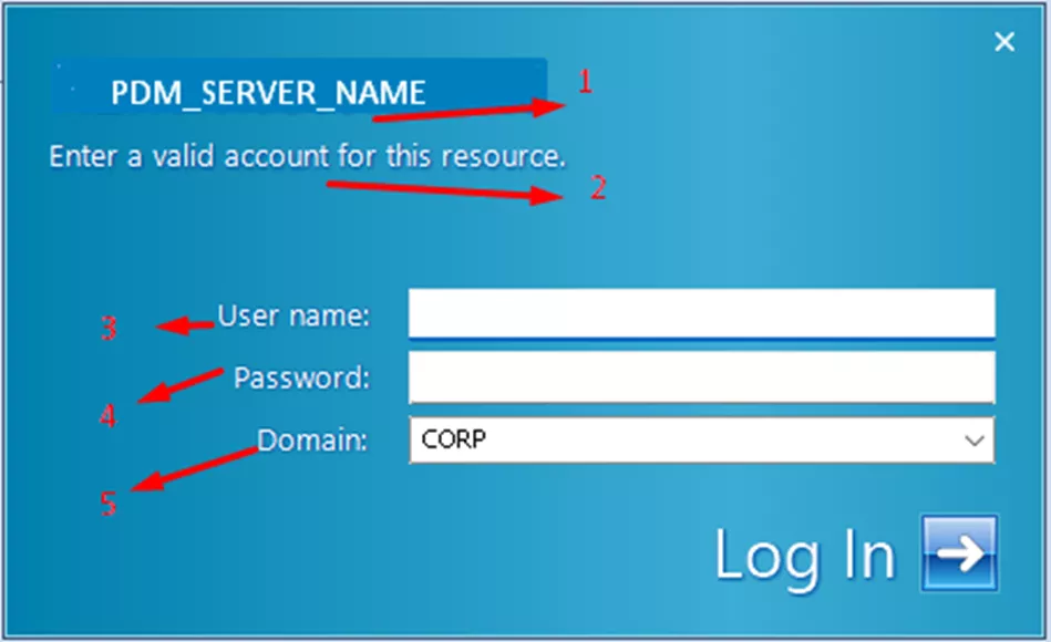

When a user attempts to create their local vault view, PDM checks the Windows User Profile running the View Setup tool against a list of Windows User Profiles in the Attach Access permission list. Note that this list can be edited from the Archive Server Configuration tool, which is covered later in this article. If the user is not on the list, it will display a request that looks nearly identical to the PDM Login screen. However, the verbiage and input fields are a bit different (and it is missing the “Work Offline” prompt in the bottom left-hand corner. I’ve included an example of each below with its components labeled to better understand.
How Does Attach Access Work in SOLIDWORKS PDM?
  1. Server Name
    1. It is important to note that this differs immediately from any vault login, as it is showing the server name and not the vault name.
  2. “Enter a valid account for this resource.”
    1. The text here is also an easy way to tell what it’s asking for. There is no comparable text on the vault login screen.
  3. User name
    1. This will, of course, be a Windows username like the one entered in the Archive Server Configuration tool.
  4. Password
    1. This will correspond with the password for the username above.
  5. Domain
    1. This is a dropdown and will often have the server’s name along with “local account”, as well as any other domains that have been entered in the Attach Access section of the Archive Server Configuration tool.
      1. For example: PDM_SERVER_NAME (local account).

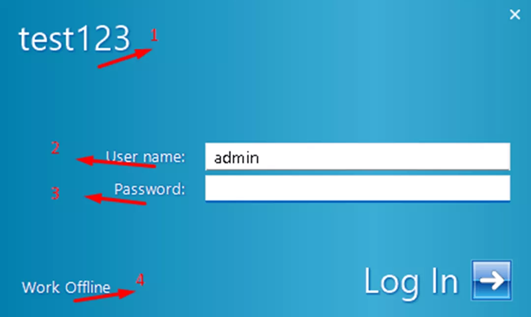

SOLIDWORKS PDM Attach Access
  1. Vault name
    1. Note that this is the vault name and not the server name.
  2. User name
    1. This is whatever username/user profile one uses to log into the vault. It does not have to be a Windows Profile unless the vault was set up that way.
  3. Password
    1. This will be the password for the PDM user.
  4. Work Offline
    1. This is interactive. Clicking on this will allow users to work in offline mode. This is another easy way to distinguish between the Attach Access dialog box and the PDM Login dialog box.

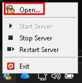

  1. On the archive server, launch the Archive Server Configuration tool (under SOLIDWORKS PDM in the Start menu).
    Default Settings Option in SOLIDWORKS PDM Archive Server

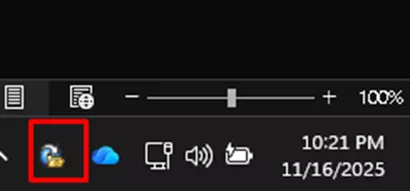

    1. If the Archive Server Configuration tool does not appear, it is often in the Windows System Tray in the bottom right-hand corner of the screen (near the clock). Right click > Open.
      Open SOLIDWORKS PDM Archive Server Configuration from Windows System Tray
      Open Archive Server Configuration from Windows System Tray

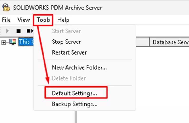

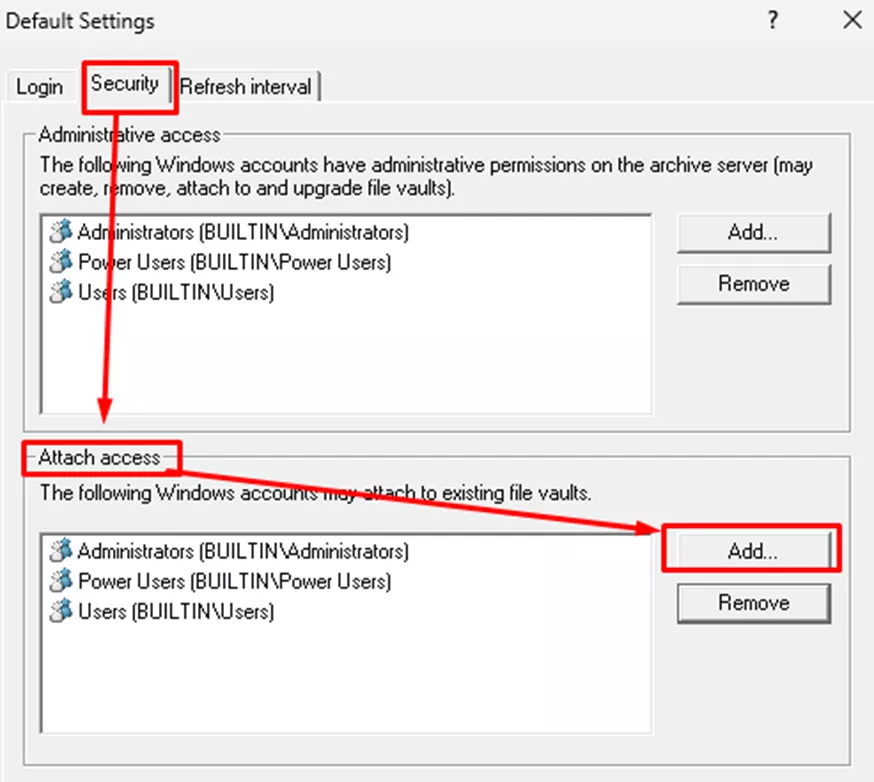

  2. Open Tools > Default Settings > Security tab > Add (under the Attach access section).
    SOLIDWORKS PDM Attach Access Default Settings Security Tab

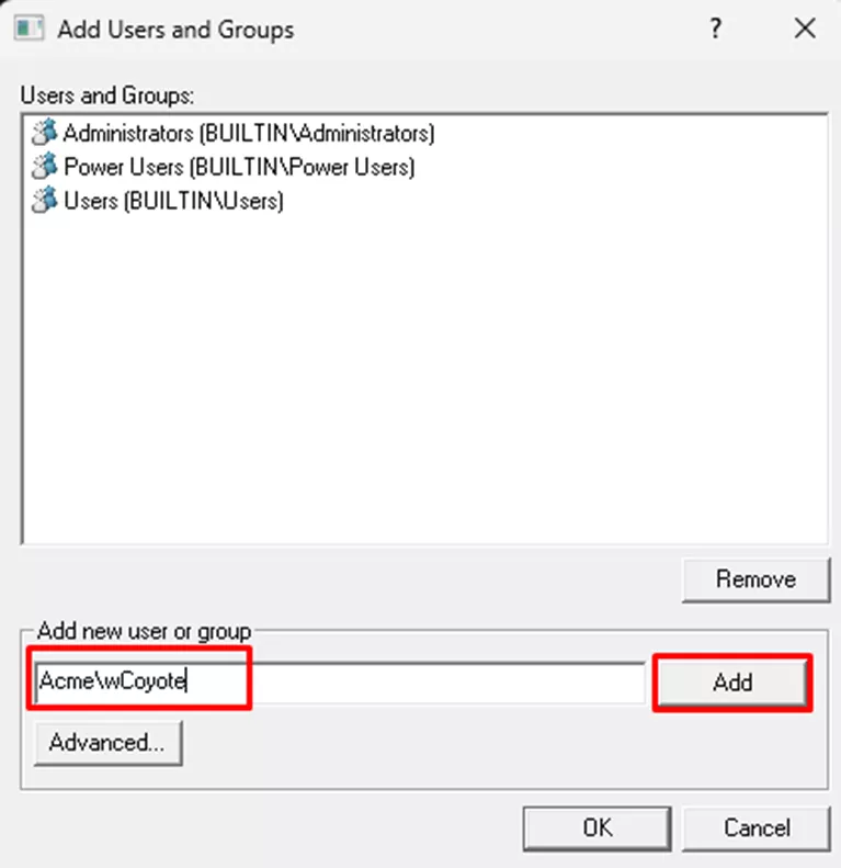

  3. Type the Active Directory username of the user or group name and select Add.
    1. This will include a domain name followed by a username.
      1. Ex: ACME\wCoyote
      2. ACME_corp.net\rRunner
        SOLIDWORKS PDM Attach Access Add Users and Groups Dialog
  4. The username or group name will be added to the list. Click OK to close the dialogs.

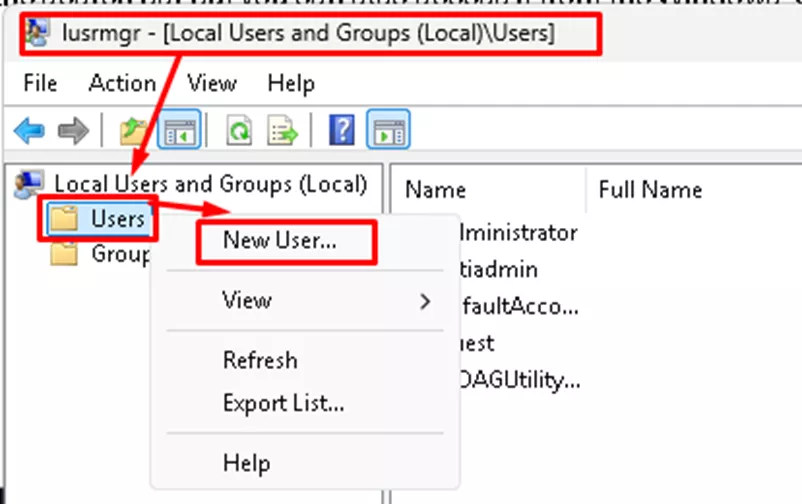

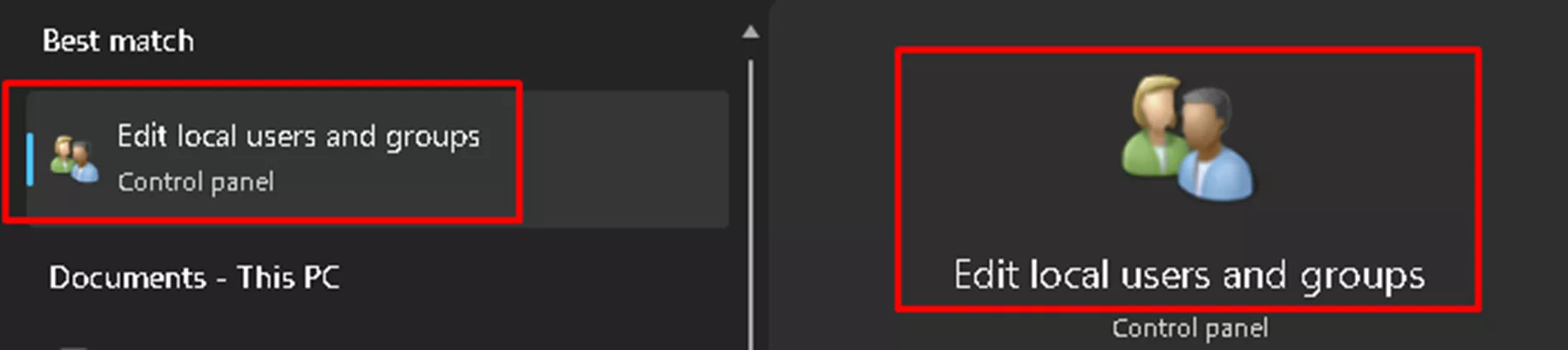

  1. Log in as an Administrator with the permission to create users (Local Administrators often have this) on the PDM Archive Server.
  2. Find the Edit Local Users and Groups.
    1. You can use the search bar, or you can access this from the Windows Control Panel.
      Create a Dummy User Account SOLIDWORKS PDM Attach Access
  3. Right-click Users > New User.
    SOLIDWORKS PDM Attach Access Create a New User

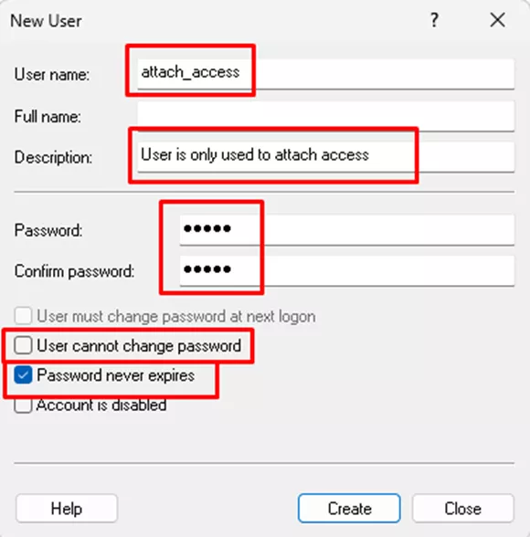

  4. Fill out the information for the new user and record your entries somewhere (like in Notepad).
    1. Username - it is suggested to keep this simple.
    2. Full Name- it is possible to skip this.
    3. Description - for documentation purposes, a brief description can be helpful, but is not necessary.
    4. Password - provide a password.
    5. Check boxes:
      1. User must change password at next login.
        1. It is suggested to uncheck this, as this isn’t an actual user so that step is unnecessary.
      2. User cannot change password.
        1. This means the user cannot log in and change their password. This may be something you want to check as a safety measure, so someone doesn’t lock you (and possibly other users utilizing these credentials for attach access) out.
        2. This is still optional.
      3. Password never expires.
        1. Again, you don’t necessarily want to have to change this password, so best practice suggests checking this box.
      4. Account is disabled.
        1. If you suspect any misuse of the account, this is a way to lock out the account. Leave it unchecked.
          New User Fields SOLIDWORKS PDM Attach Access
