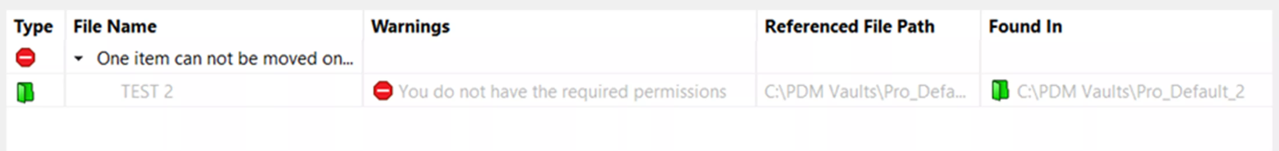

Although the method for moving files and folders in SOLIDWORKS PDM is the same as it would be in any other File Explorer location (drag and drop), restructuring the PDM Vault requires a user to have various levels of permissions. Without these permissions, warnings similar to the one below will be generated.
Permissions Error SOLIDWORKS PDM
Ultimately, the best way to bypass this error is to use the default Admin user account. This user will have the necessary permissions across the vault by default.

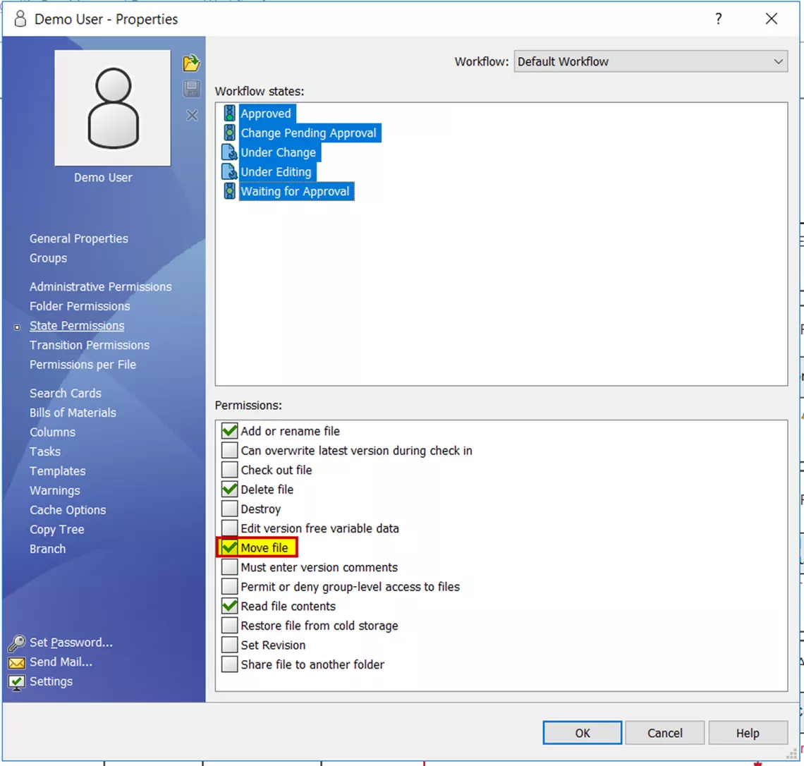

  2. State Permissions
    • Add or rename file
    • Delete File**
    • Move File*
    • Read file contents
*Note: This Move File toggle is not available in all versions
**If Move File is available, Delete File is not a required permission for this function.

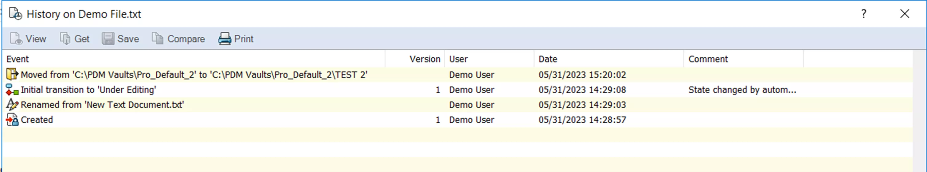

While moving file(s), the system deletes the file from the source folder and adds it to the new folder, without destroying the file’s history. Therefore, previous versions will still be accessible, and a record of its previous activity will still be visible from the file’s history – including a record of the move.
Move File Permissions in SOLIDWORKS PDM

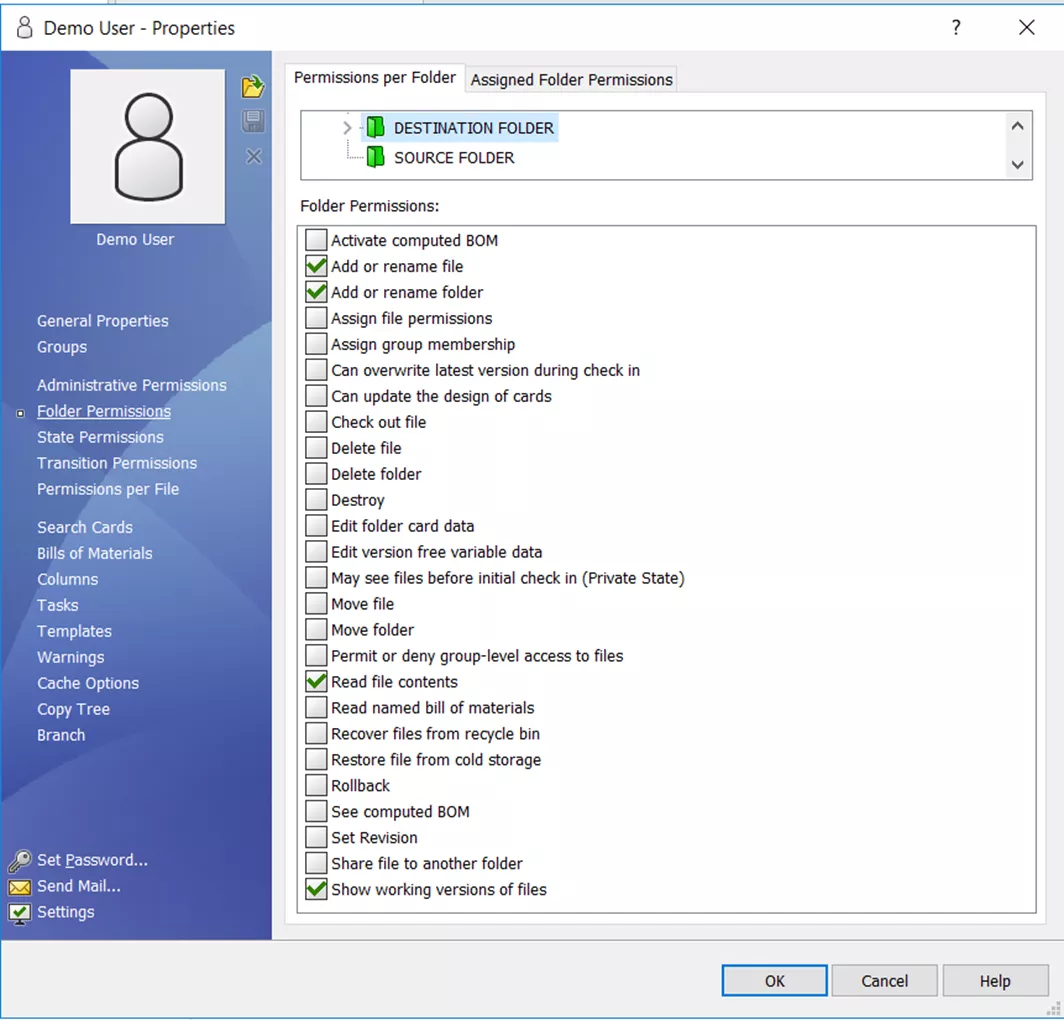

Therefore, for the permissions to line up correctly, the user must have the following permissions applied at the appropriate folder level:
Source Folder (where the file is being removed from)
SOLIDWORKS PDM Source Folder Permissions
In newer versions of the software, the Delete File requirement can be satisfied by toggling the Move File permission instead.
Destination Folder (where the file will be added)
SOLIDWORKS PDM Destination Folder
State Permissions
In newer versions of the software, the Delete File requirement can be satisfied by toggling the Move File permission here as well.

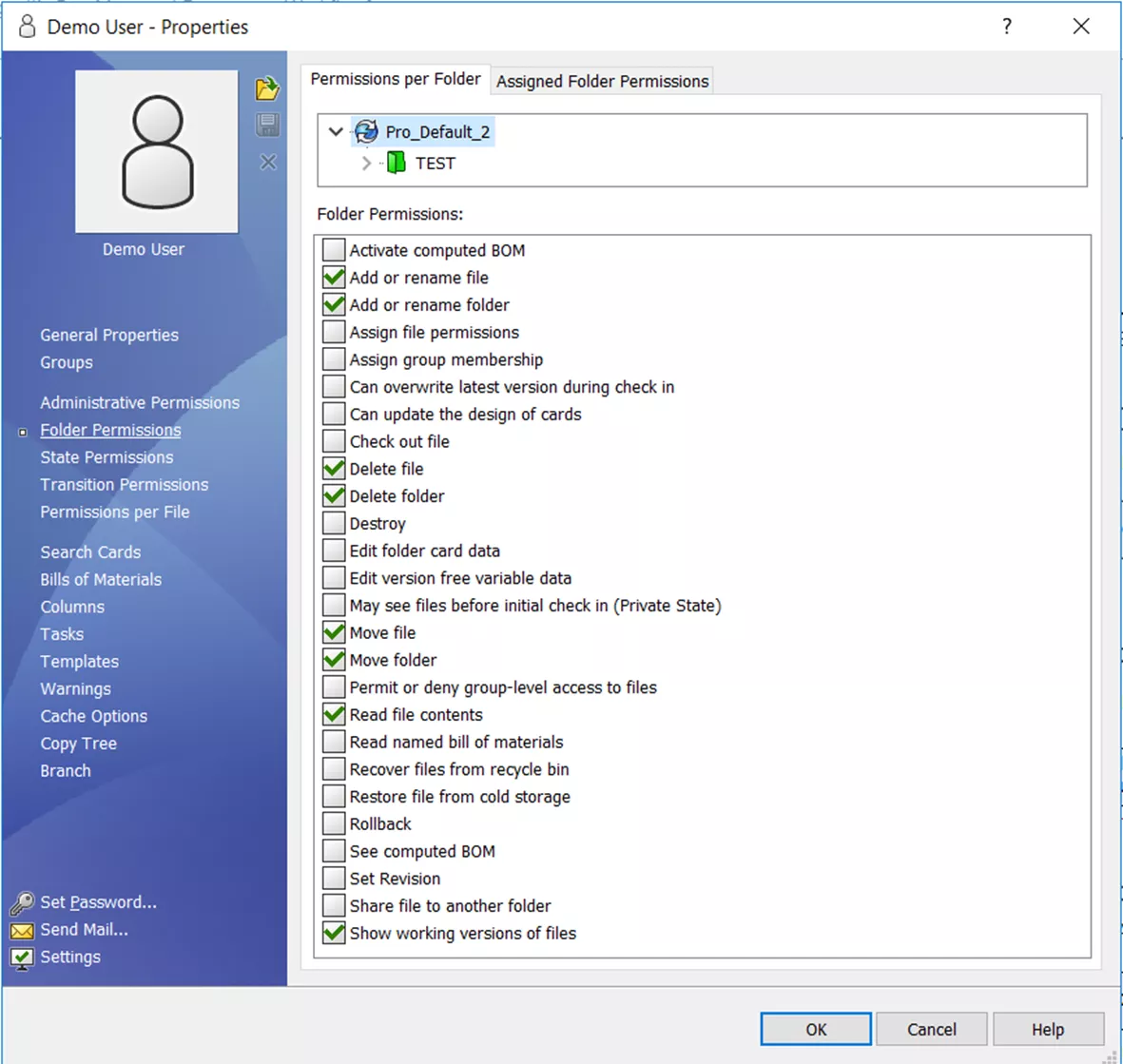

  3. Folder Permissions must be applied at the source and destination folder level – these are not required for the moving folder’s permissions.
All required folder permissions can either be applied at the vault level or to their respective folder levels. If everything is being applied at the vault level, the following are the required permissions.
SOLIDWORKS PDM Vault Level File Permissions
