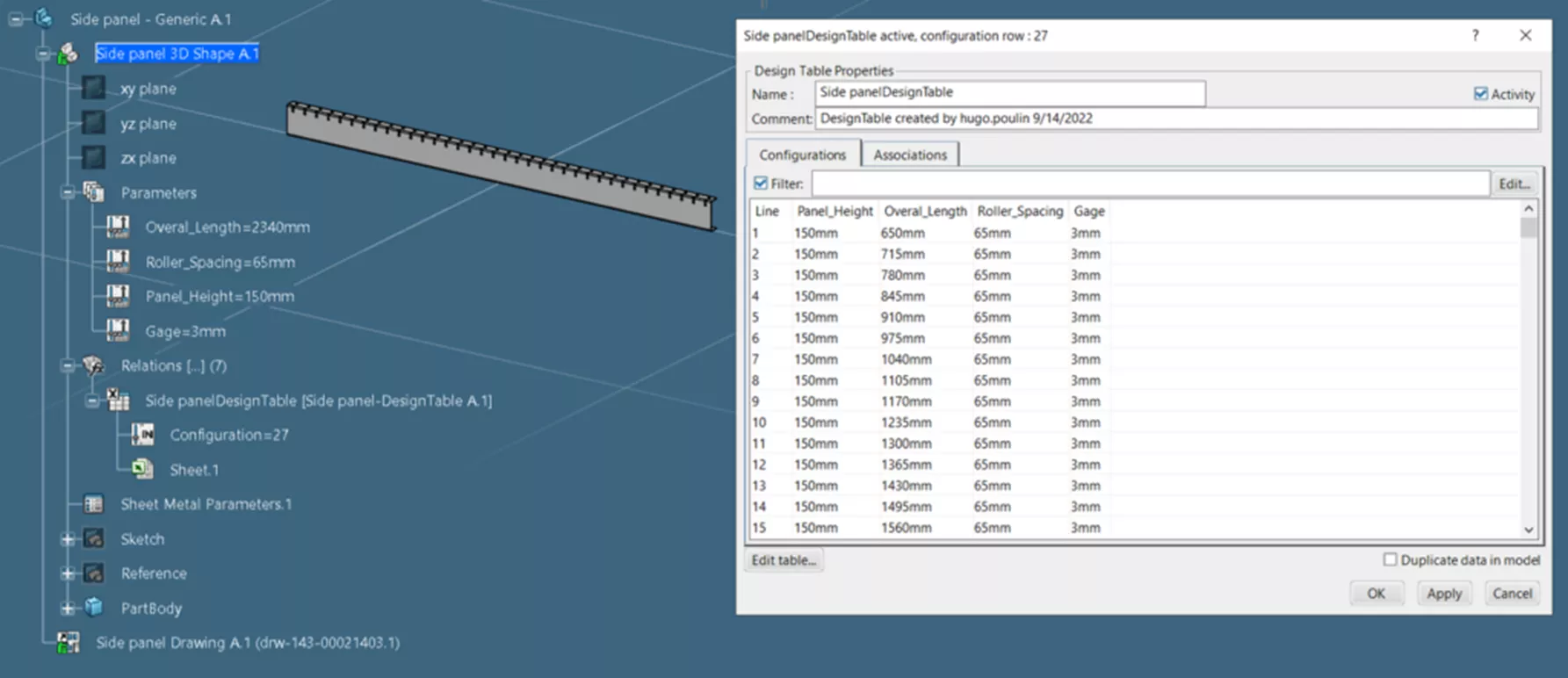

Let’s go back to our conveyor example and explore the Component Family concept with the side panel. The first step is to design the parameterized generic model. This model should not be found in a product structure since its only use will be to generate the parts of the family. The next step is to create a Design Table to link the variable parameters to the different configurations.
There are two ways to create a Design Table: by leveraging an existing spreadsheet or by creating a new spreadsheet with the current parameter values. Establishing the different configurations in Excel offers certain advantages; it is easier to manipulate the data and users can utilize the formulas to generate the cell value. Once the different configurations have been created, all you need to do is save the spreadsheet to automatically synchronize the Design Table. The part geometry is now driven by the Design Table.
How to Create a Component Family in 3DEXPERIENCE CATIA
At this stage, it is important to define the material in the generic model in order to assign the correct weight when solving the part family. It is also possible to attach a 2D drawing to the generic model. This drawing will be updated during the solve and all dimensions affected by the parametrization will follow. It is therefore of no value to apply fake dimensions or parametric dimensions. This is noteworthy as only one drawing is necessary to allow you to generate any number of different drawings.

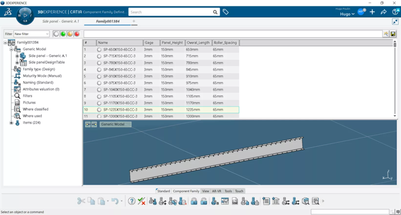

It is now time to create the part’s family. To do this, simply launch the Component Family Definition application with the generic model open in session. A new Component Family PLM object will be created automatically. In the Component Family Model tab, the Family type should be set to design family. It is preferable to use the manual change option for maturity management.
3DEXPERIENCE CATIA Create Component Family Using a Spreadsheet
The Design Table will be loaded and the Excel parameters that have not been associated with the model will also be present. These parameters can be associated with properties using the command Value Attribute.
The Weight Management command allows you to automatically calculate the weight and the center of gravity of the components to be solved. To resolve the family, simply use the Test and Resolve Family Item command. The Component Family Definition app also offers tools to control changes and revisions.
