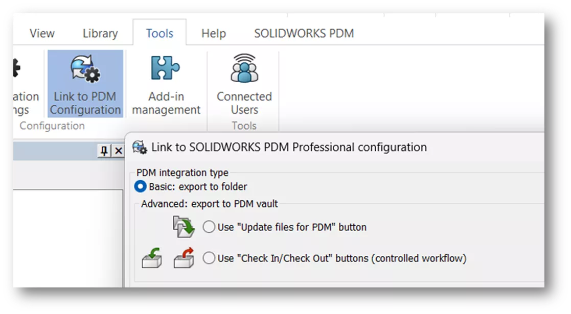

While add-ins are (and have been) available to integrate SOLIDWORKS Electrical with PDM, this article refers specifically to the options that don't require those tools. These are found under SOLIDWORKS Electrical Tools > Link to PDM Configuration.

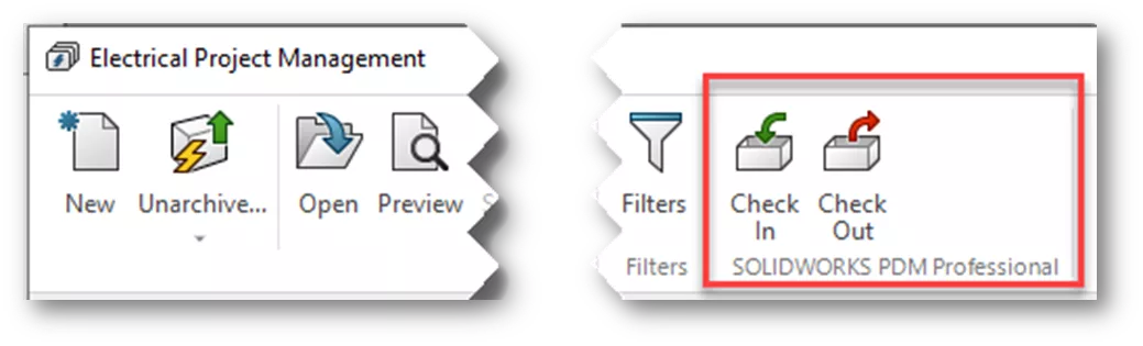

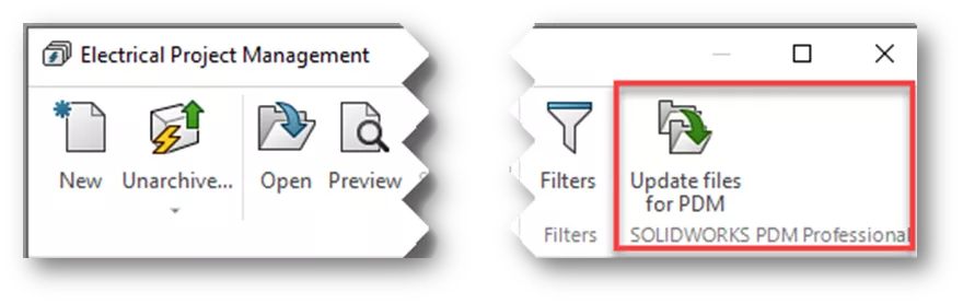

With this set of features, users can choose between Basic: export to folder or an Advanced export, which shows either of two button sets in the UI.
