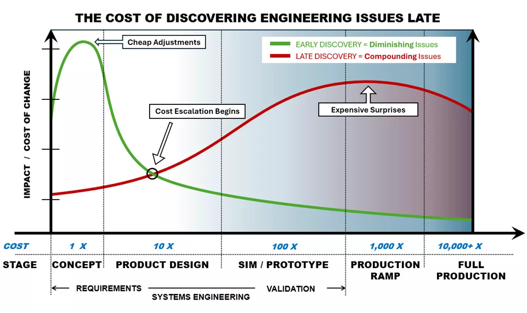

The Cost Curve Engineers Know Too Well
There is a well-known concept in product development often called the cost-of-change curve. The idea is simple: the later a problem is discovered in the product lifecycle, the more expensive it becomes to fix.
A change made during concept development might require only a design tweak and a few hours of engineering time. The same change discovered during prototype or production could affect dozens more components and trigger retooling, scrapping material, supplier updates, and cascading program delays.
The exact multipliers vary by industry and program, but the pattern is remarkably consistent.
Relative cost by lifecycle phase:
  • Concept: 1x
  • Design: 10x
  • Prototype: 100x
  • Production: 1000x
Research in systems engineering frequently shows that as much as 70–80% of a product’s lifecycle cost is effectively determined during early design decisions. In other words, the most expensive problems are the undiscovered ones.
The Cost of Discovering Engineering Issues Late
