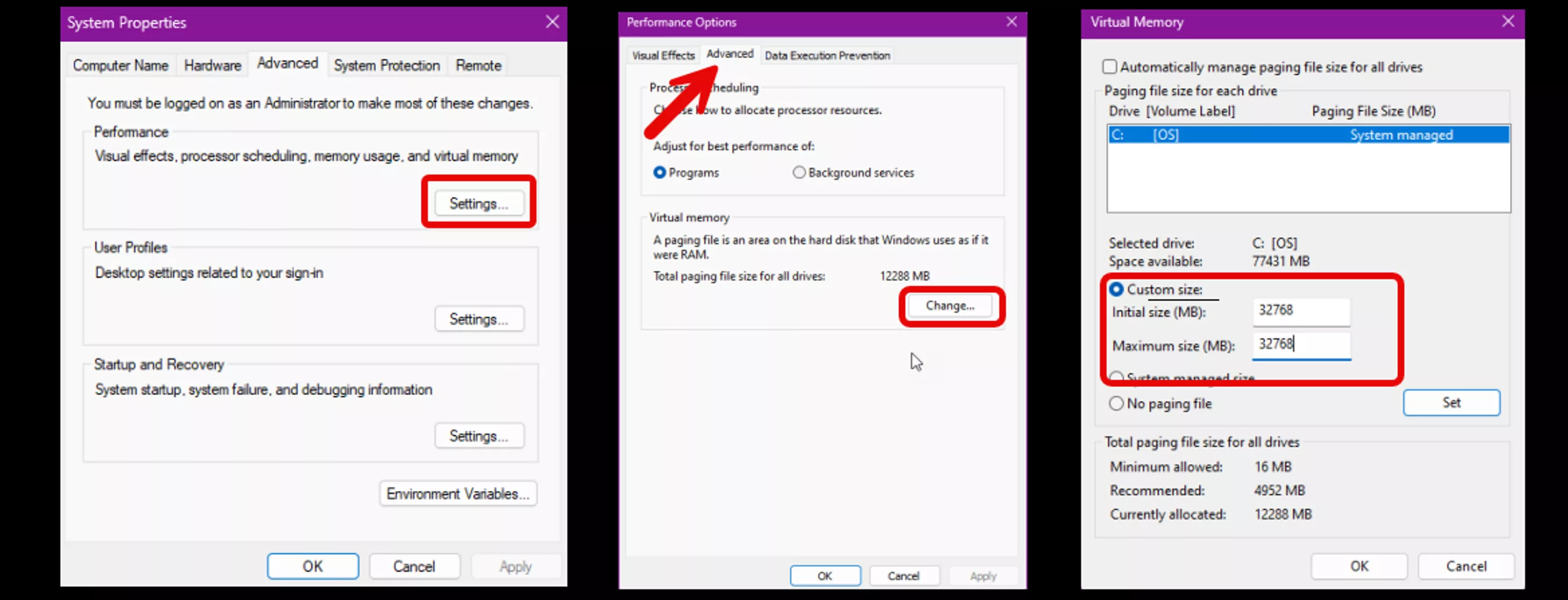

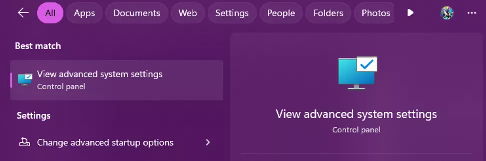

The swap file, or paging file, is an area on your hard disk that Windows uses as virtual memory when physical RAM is full. Increasing its size can prevent slowdowns during memory-intensive tasks.

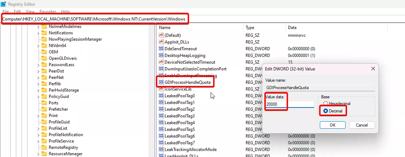

GDI (Graphics Device Interface) objects are used by Windows to draw user interface elements. Complex SOLIDWORKS assemblies can exceed the default limit per process, leading to graphical glitches or performance degradation.
Warning: Editing the Windows Registry can cause serious system instability if done incorrectly. Proceed with caution and only change the specified value.
