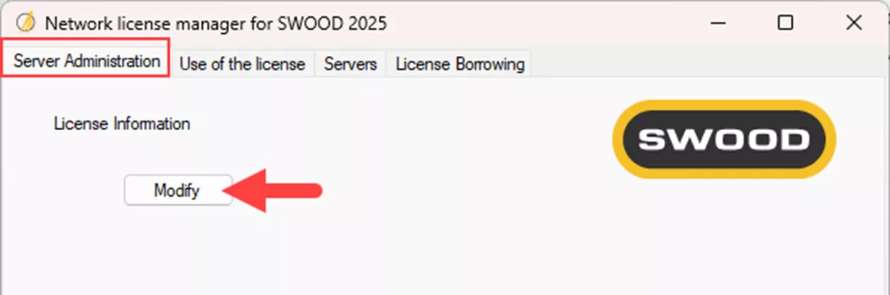

  4. On the Server Administration tab, click Modify.

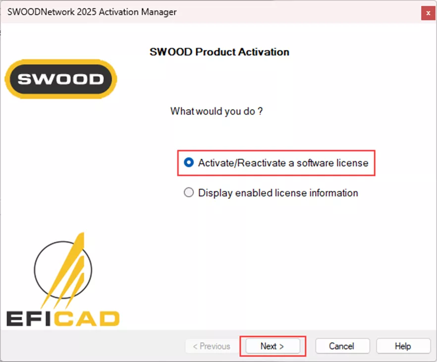

  5. Choose Activate/Reactivate a software license and then click Next.

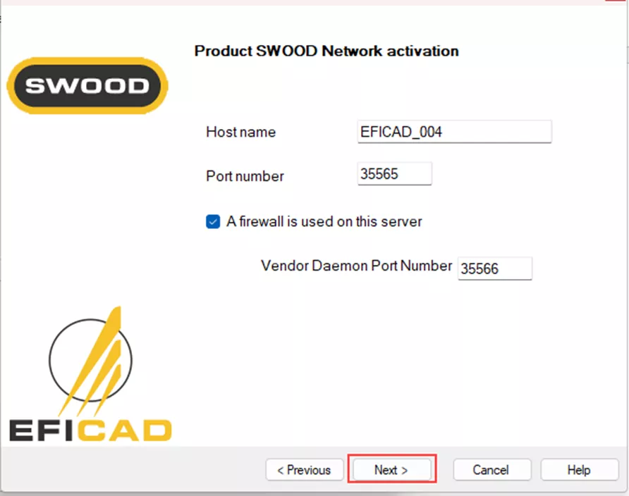

  6. Ensure your server name is correct and that the 35565 port number is not in use. Change the port number if it is. If a firewall is used on the server, click the firewall checkbox to allow the 35566 port number. Click Next.

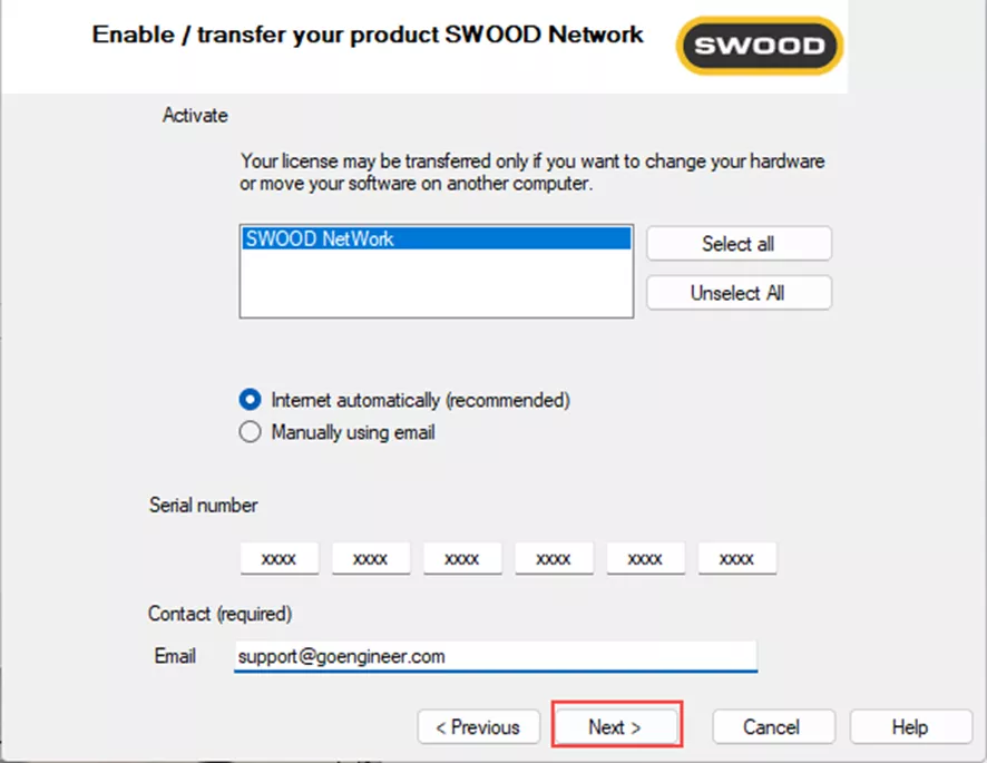

  7. Enter the SWOOD Network Serial Number provided by GoEngineer, as well as a valid e-mail address. Click Next.
    Enable / Transfer Your Product SWOOD Network

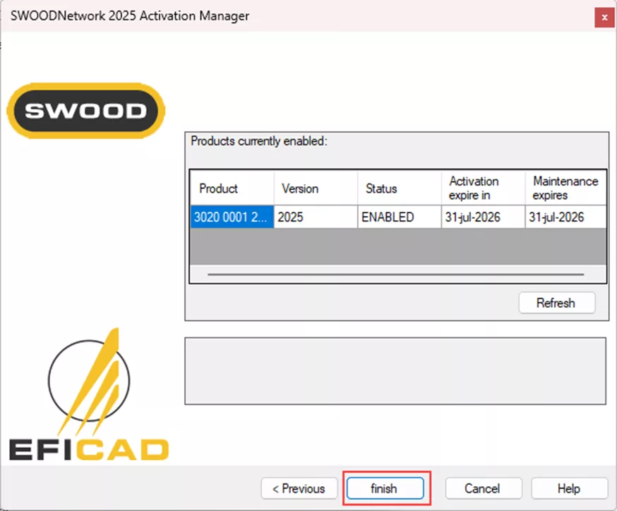

  8. When the license is activated, you will see ENABLED under the Status tab. If this does not show, please close the License Manager, open it with admin privileges, and try the activation process again.
    Enable SWOOD Network License Activation
  9. Click Finish to complete the activation.

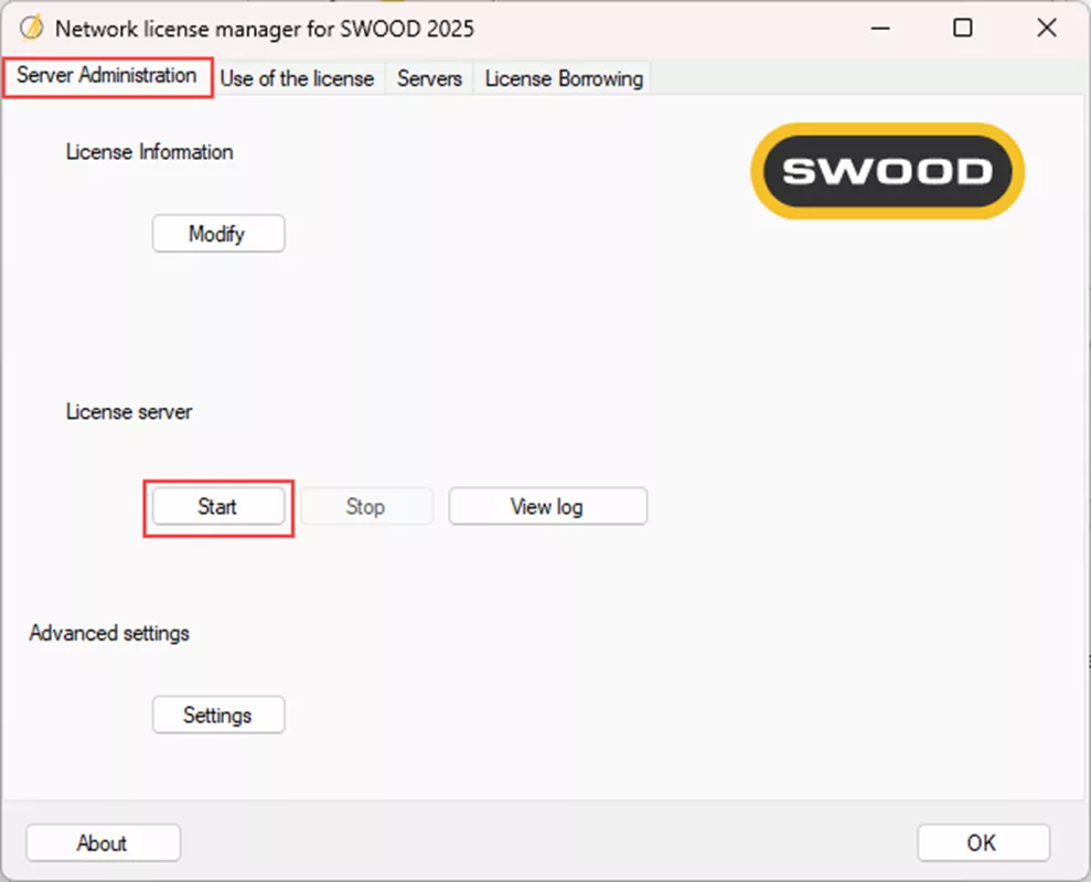

  10. This will take you back to the Network License Manager. Ensure you are on the Server Administration tab. Click Start to start the service.
    SWOOD Network License Manager Start License Server

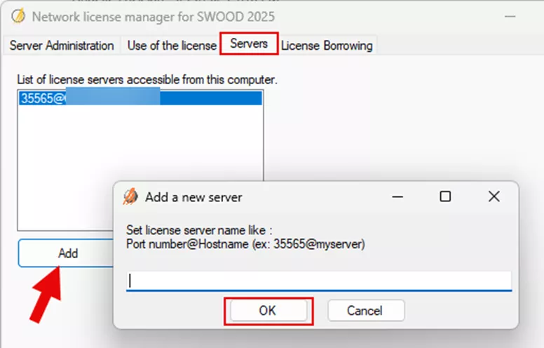

  11. Select the Servers tab and choose Add. Type in the port number with an @ symbol, and your server name ex. 35565@SERVERNAME. Click OK when you are done.
    Add New Server SWOOD Network Activation Guide

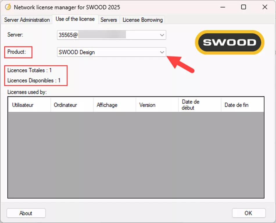

  12. Once the license server has been started, click on the Use of the license tab. Use the Product dropdown and ensure the correct number of licenses is available for each product you own.
    SWOOD Use of the License
  13. Make note of the Server name (e.g., 35565@EFICAD_004) for use on the client computer. Click OK to close the License Manager.

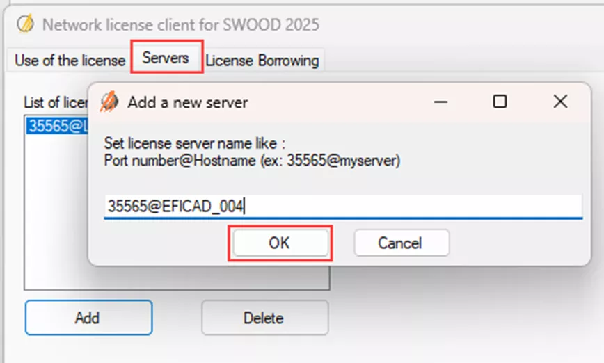

  2. Select Server tab and choose Add. Type in the server name from the Network License Manager installation. Choose OK to add the server.
    SWOOD Network Client Servers

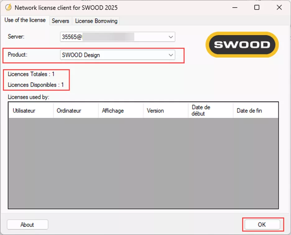

  3. Select the Use of the License tab and confirm the products available.
    SWOOD Design Activation
  4. Once connected to the server, close SOLIDWORKS and re-open to activate the SWOOD add-ins. Your usage should now show in the Network License Client.

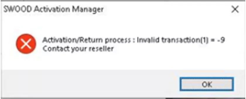

  1. If you are activating SWOOD for the first time, or during an update of SWOOD with a year version, you might receive a pop-up like the one below or with a different ID (-3, -5, -9).
    SWOOD Network License Activation Troubleshooting
    In this situation, it is suggested to try the activation at least 2 more times.
