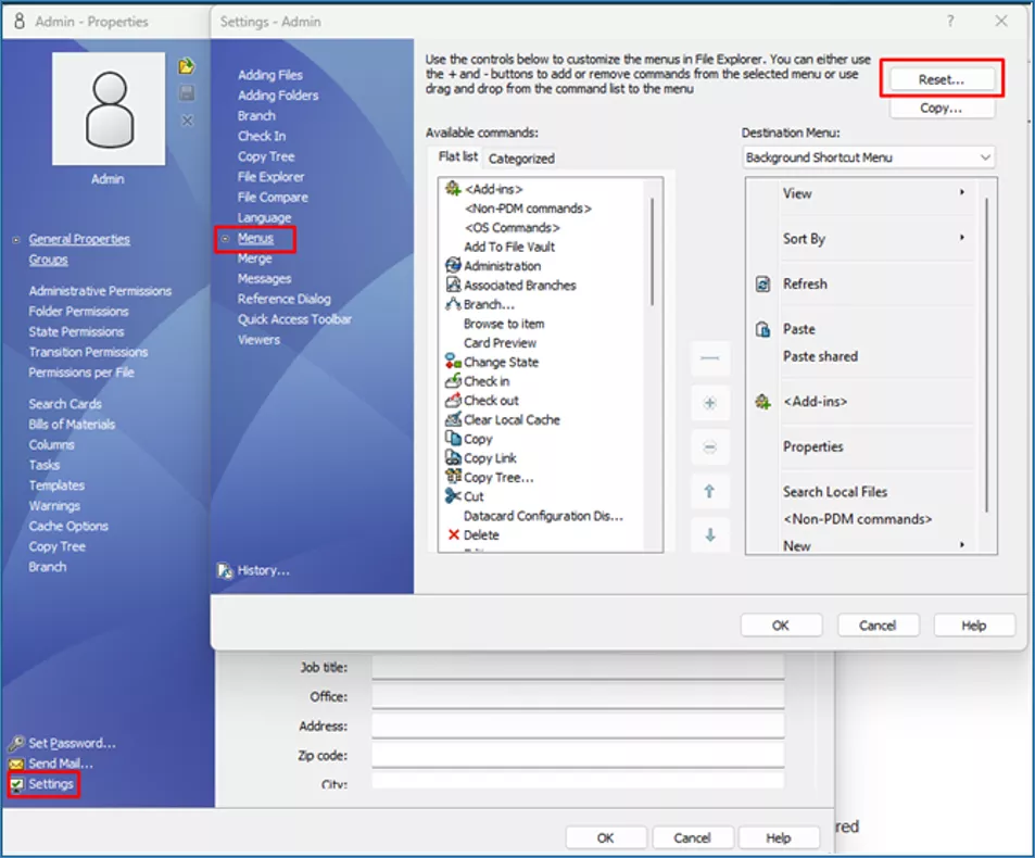

  1. Log into the administration tool as admin.
  2. Expand Users and Groups Management > Users > double-click the affected user.
  3. Go to Settings > Menus.
  4. On the menu page, click the Reset… button to set the user’s menus back to default.
    Fix SOLIDWORKS PDM Crashes by Resetting Menus
  5. Reboot the user’s computer and log back into PDM.

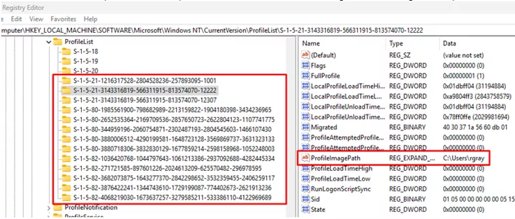

    • If you have to log into the machine for admin rights or otherwise launch the registry editor as an admin user other than the PDM user, then you will need to go to the user’s profile registry rather than HKEY CURRENT USER. You can figure out which ID is here like so:
      • Navigate to this key: Computer\HKEY_LOCAL_MACHINE\SOFTWARE\Microsoft\Windows NT\CurrentVersion\ProfileList.
      • There should be several IDs (all will start with “S-1-5”) listed, and each will have a ProfileImagePath value listing the user’s profile. Find the one matching your user’s profile, and take note of the SID.
      • Then you would go to the same PDMWorks Enterprise key to delete it, but for the path to her profile, replacing [SID] with the one you just confirmed: Computer\HKEY_USERS\[SID]\Software\SolidWorks\Applications\PDMWorks Enterprise.

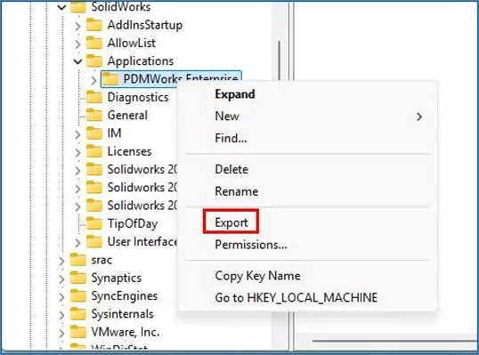

  4. Right-click PDMWorks Enterprise > Export.
    Export PDMWorks Enterprise
  5. Save the .reg file somewhere easily accessible, like your desktop.

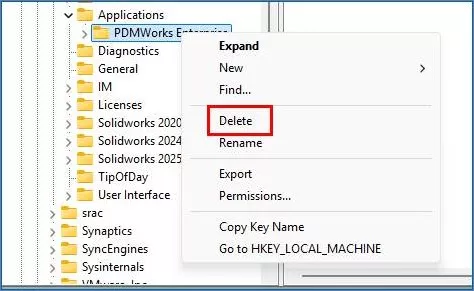

  6. Right-click PDMWorks Enterprise again > Delete.
    Delete PDMWorks Enterprise

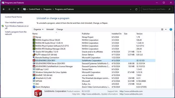

  3. Go to the Windows Start menu > search for and open Control Panel > Programs and Features > Uninstall a program.
    Windows Control Panel Uninstall a Program
  4. Select SOLIDWORKS 20XX SPX and then click Uninstall at the top of the list.

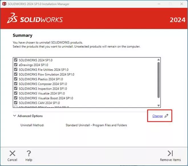

  5. This will open the SOLIDWORKS Installation Manager to the Summary page. Select Change to the right of the Advanced Options section.
    Change Option in SOLIDWORKS Installation Manager

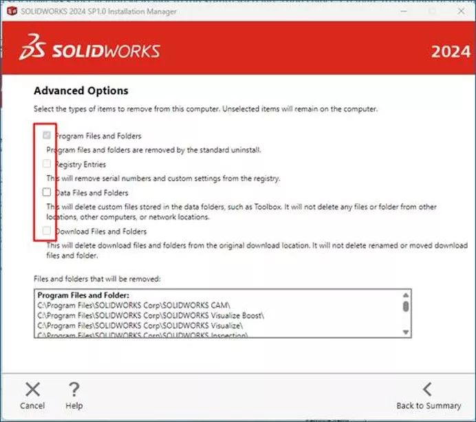

  6. In the dialog that appears, select the boxes for the items you want to have removed from the system.
    1. If you have multiple versions installed and you are not uninstalling the latest version, some boxes will not be available.
      SOLIDWORKS Installation Manager Advanced Options

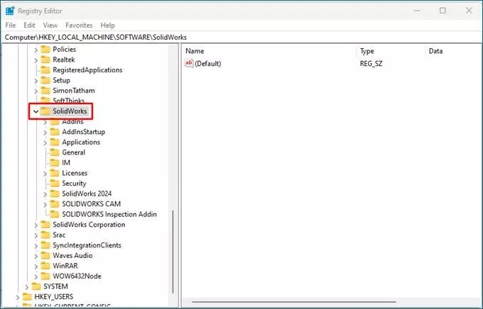

  10. Navigate to the following registry keys and right-click > Rename them to “[original name]_old”:
    1. HKEY_LOCAL_MACHINE\SOFTWARE\SolidWorks
    2. HKEY_LOCAL_MACHINE\SOFTWARE\Wow6432Node\SolidWorks
    3. HKEY_CURRENT_USER\Software\SolidWorks
