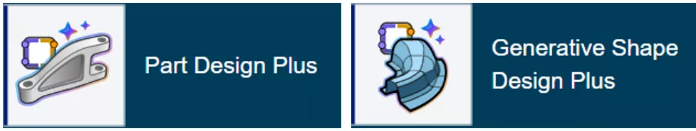

Most of these capabilities are part of the CATIA Mechanical and Shape Engineer role (2026x) and can be accessed through the new Part Design Plus and Generative Shape Design Plus apps.
These are not available in previous versions of 3DEXPERIENCE CATIA, nor in CATIA V5. These AI features are based on AI trained on thousands of models and techniques drawn from over 40 years of CAD data.

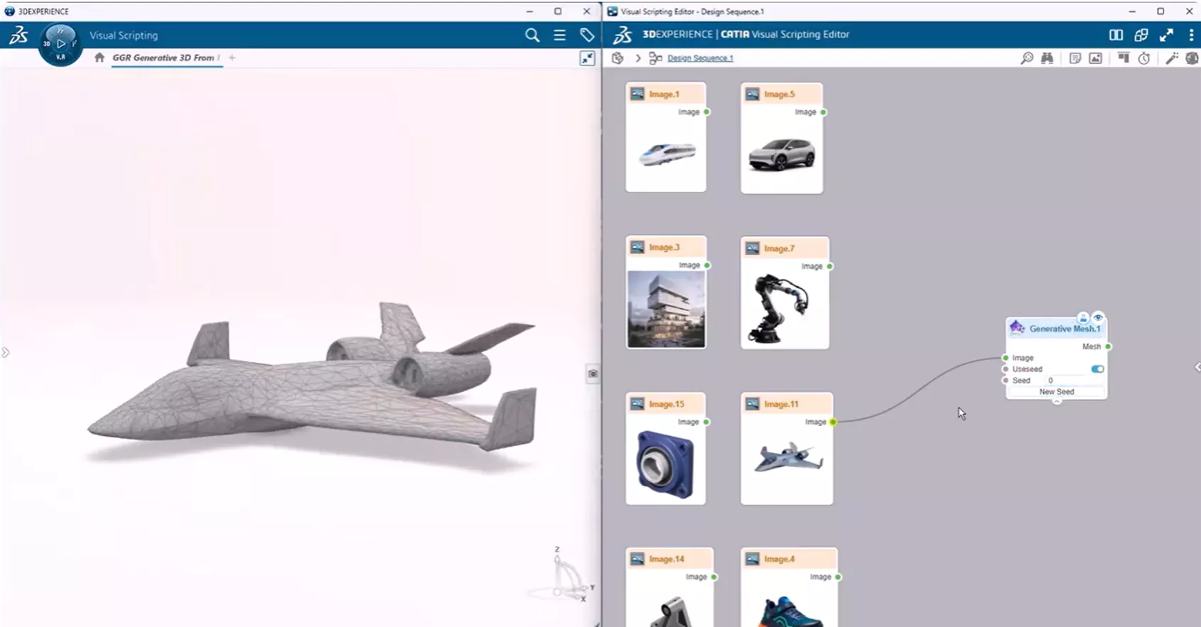

Generative Mesh from Image (Beta): This feature is part of the Visual Scripting app. You can upload one or multiple 2D images or sketches of a model, and the AI in Visual Scripting will generate a 3D mesh based on your input. Currently in beta, this capability allows you to create up to 10 models per day using this technology.

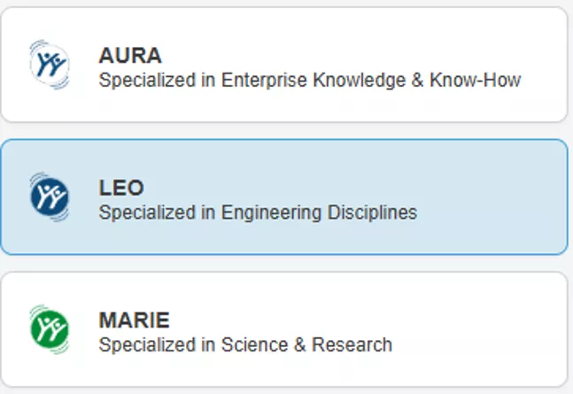

AURA, LEO, and MARIE are three virtual AI companions on the 3DEXPERIENCE platform available to assist users in various areas. These are not generic AI agents, but agents specific to Dassault Systèmes that have been trained on 40+ years of industry expertise and models. They'll help you perform many tasks in a conversational format and are available in 3DEXPERIENCE 2026x.
AURA is focused primarily on business and enterprise knowledge, helping users find and understand information contained within the 3DEXPERIENCE environment. You can also implement company standards and documentation for it to reference. As examples, AURA can be used to:
LEO is an engineering-focused companion that can work directly with models and processes and can perform tasks in your engineering workflow. Some examples of tasks LEO can assist with:
MARIE is the scientist of the group. Although it is not specifically a CATIA design assistant, it is important in the overall 3DEXPERIENCE platform and workflow. It is directed at BIOVIA users for scientific workflows. Here are some of MARIE’s capabilities:
