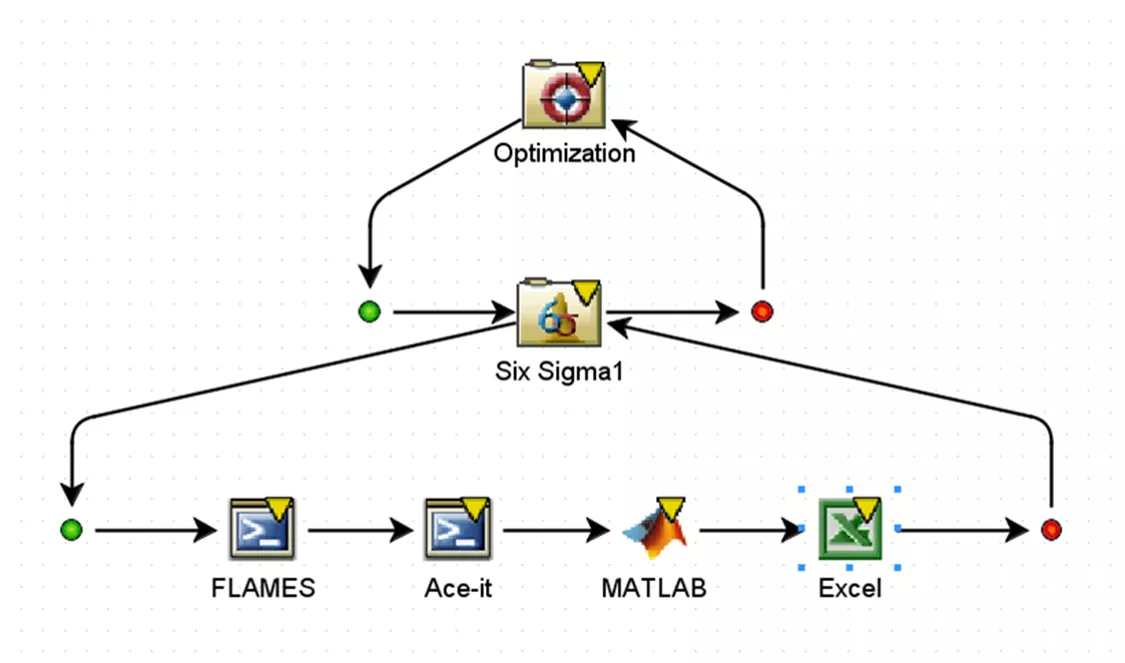

    Isight with Optimization and Six Sigma driving a simflow with a mix of internal and commercial simulation codes
    Figure 1: Isight with Optimization and Six Sigma driving a simflow with a mix of internal and commercial simulation codes

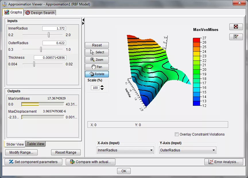

All model order reduction methods in Isight support automatic generation and cross-validation of approximation models with easy-to-understand visual error analysis. The approximation creator/viewer interface in Isight allows users to visualize approximation surfaces in 2D and 3D. (Figure 2)
Interactive Approximation Viewer in SIMULIA Isight
Figure 2: Interactive Approximation Viewer in Isight

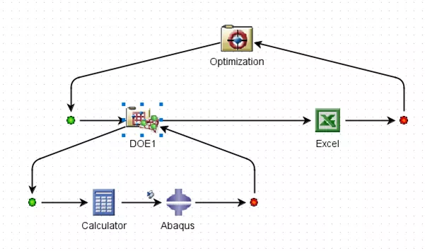

Shown below in Figure 3 is a typical Isight workflow that incorporates an approximation model. As noted above, an approximation can be dropped on an entire process, sub-process, individual component, or dropped on the workflow as a stand-alone component if the model had been previously saved or data exists to create the model. If the approximation model is dropped on a process, sub-process, or individual component and has no data for it to be initialized, Isight will automatically run the process until it gets the minimum number of points to initially create the approximation.
It will then automatically run an error analysis by running a design point with the approximation model and then running the simulation for which it is approximating. If the results between approximated and actual run differ by a specified percentage, Isight will continue to add more runs of the actual simulation to the approximation model until the error tolerance has been satisfied.
Typical Isight workflow using an auto-generated approximation to replace a sub-process
This automatic generation/initialization of an approximation model can be part of any design exploration technique: DOE, Optimization, Monte Carlo, Six Sigma, etc. The final “best” design from the approximation can then be automatically rerun with the actual simulation tool, so you have the full simulation results of your tool of choice.
