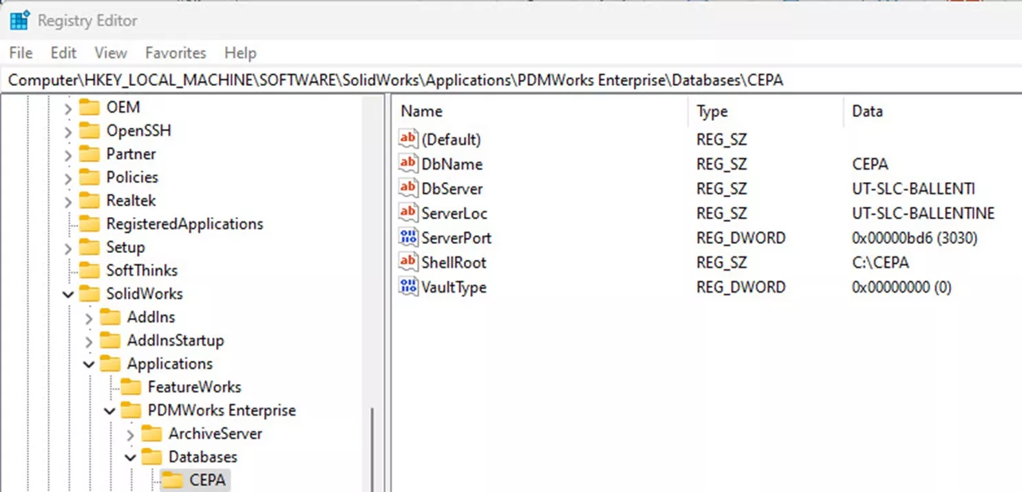

The Registry Keys in Question
When a vault view is shared among all Windows users on a PC, the relevant information is shared in the following registry locations:
HKEY_LOCAL_MACHINE\SOFTWARE\SolidWorks\Applications\PDMWorks Enterprise\Databases\[Vault Name]
HKEY_LOCAL_MACHINE\SOFTWARE\Wow6432Node\SolidWorks\Applications\PDMWorks Enterprise\Databases\[Vault Name]

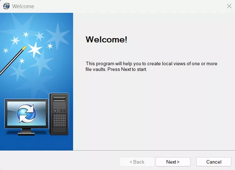

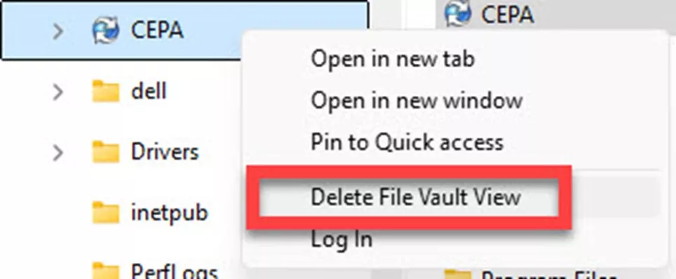

Deleting the Vault View and Adding it Back Again
Sometimes, resolving this error is as easy as deleting and reinstalling the vault view. This generally works when the view is set to be private when it shouldn’t be, or is missing the registry information necessary to make it visible to other users. The standard process for this should work, and is as simple as right-clicking the view, deleting it, and re-installing as per the instructions found here: SOLIDWORKS PDM Local Vault View Deletion and Creation.
Delete File Vault View Option in SOLIDWORKS PDM
Adding the SOLIDWORKS PDM Vault View Back Again After Deleting It

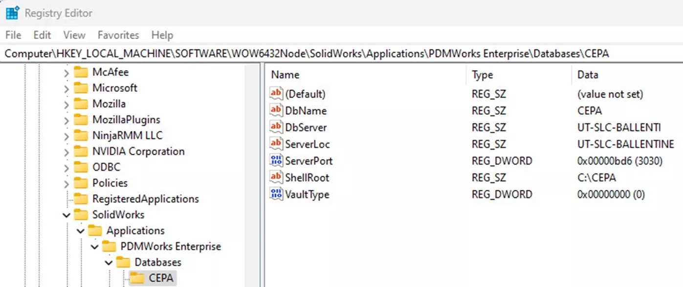

Copying Registry Keys from a Different PC
If reinstalling the vault view doesn’t resolve the issue, the next easiest strategy is to copy these registry keys from a PC with a working vault and import them to the PC that is giving the error message. Using File > Export and File > Import in the Windows Registry Editor will accomplish this.
Copying Registry Keys from a Different PC for SOLIDWORKS PDM
SOLIDWORKS PDM Copy Registry Key from a Different PC
After importing these registry keys, verify the following values are now populated:
DbName REG_SZ - Name of the file-vault database
DbServer REG_SZ - Name of the SQL server
ServerLoc REG_SZ -Name of the archive server
ServerPort REG_DWORD - Archive server port; by default, the decimal value is 3030
ShellRoot REG_SZ - Full path to the file-vault view folder, including the vault name

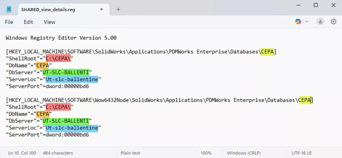

Manually Re-Create the Registry Keys

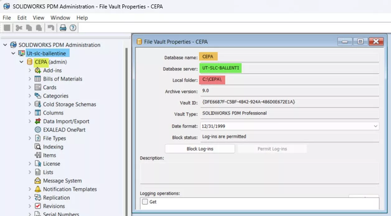

If importing registry keys from another PC doesn’t work or isn’t an option, you can re-create them manually. To do this, first open the attached registry file SHARED_view_details.reg or PRIVATE_view_details.reg using Notepad in Windows. Which one you open depends on whether you have a private or shared vault. Edit the open file with the correct vault information (shown below). The information entered manually will be specific to your vault and can be found in the PDM Admin tool (right-click the vault > Properties) or from the registry of another PC with a working vault.
Manually Re-Create the Registry Keys in SOLIDWORKS PDM
Why Manually Re-Create the Registry Keys in SOLIDWORKS PDM
The final step is to import the updated registry file using the registry editor. The vault view should now work, but if it doesn’t, you can try troubleshooting SOLIDWORKS PDM vault connection issues or contact our Technical Support team for more help if GoEngineer is your SOLIDWORKS partner.
