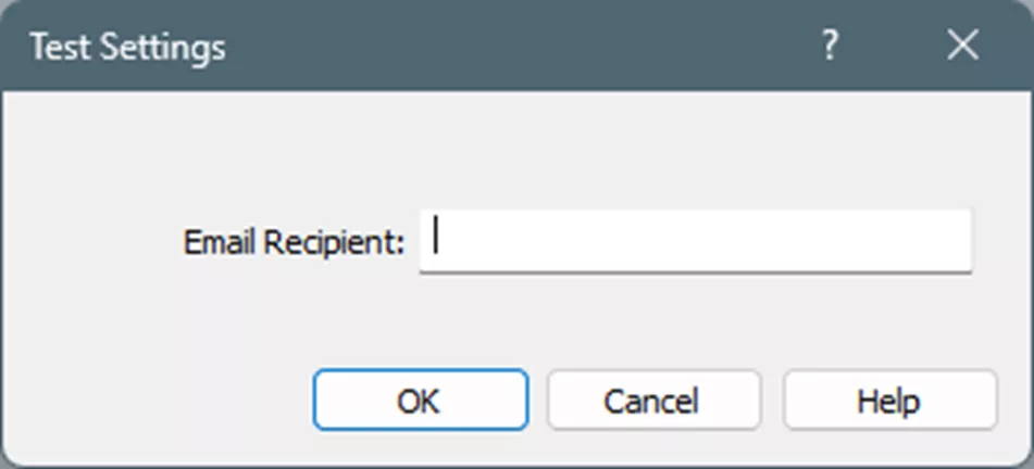

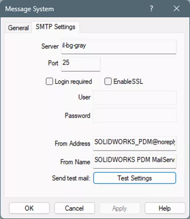

Test notifications
In the PDMAdministrationtool, log into the vault.
Open theMail Systemsettings.
Go to theSMTP Settingstab.
Click theTest Settingsbutton and enter an email to send a test notification to.
If you receive aServer not founderror, the server it’s referring to is actually the database server. You’ll want to review the configuration once more in the section above.

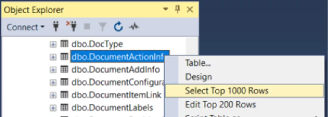

Log into SQL Server Management Studio.
From Object Explorer on the left, expand the database for the vault in question.
Expand Tablesand finddbo.DocumentActionInfo.
Right-click the table and chooseSelect Top 1000 Rows.

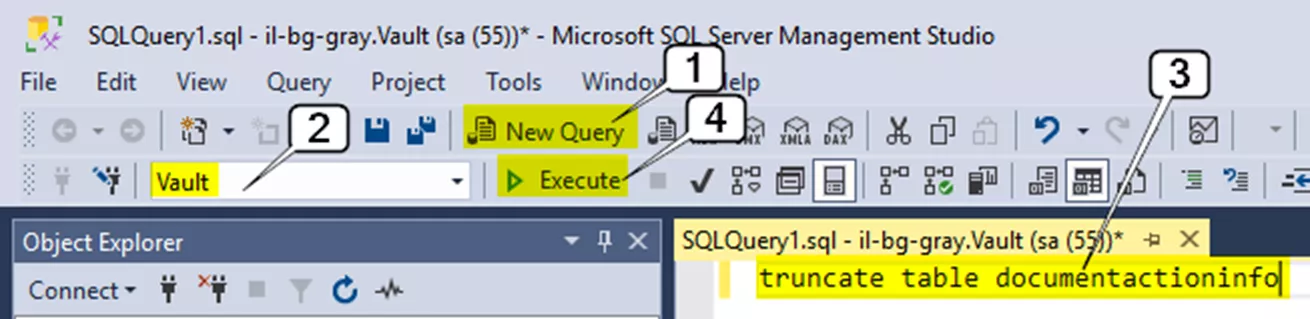

When notifications aren’t sent out for a while, you can sometimes have several built-up entries in this table over time. If that number gets too high, the system can get “stuck” and notifications won’t send. Clearing out the prior notifications can help this. To do so, you’ll need to truncate the table.
Before doing this, be sure to take a backup of your database!You can find instructions for thathere.
ClickNew Queryat the top of SSMS.
Ensure the dropdown in the toolbar of SSMS is set to your vault’s database.
Enter the following text in the query field:tuuncate table documentactioninfo

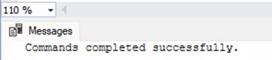

Hit theExecutebutton.
You should receive a message in the results window saying it ran successfully.

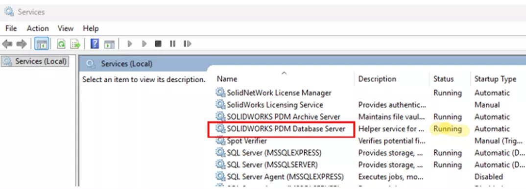

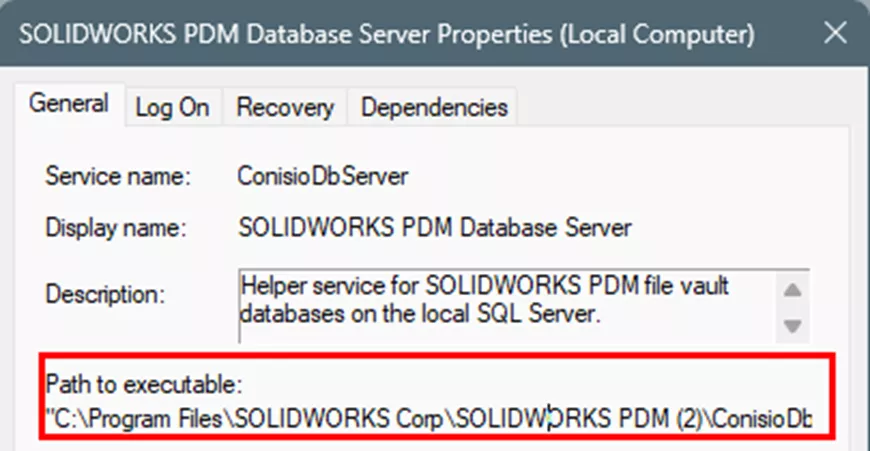

Open theWindows Servicesapplication and look for theSOLIDWORKS PDM Database Serverservice.
If this service is not present, install it using the installation media for your version and service pack of PDM.
If the service is present and not running, start it.

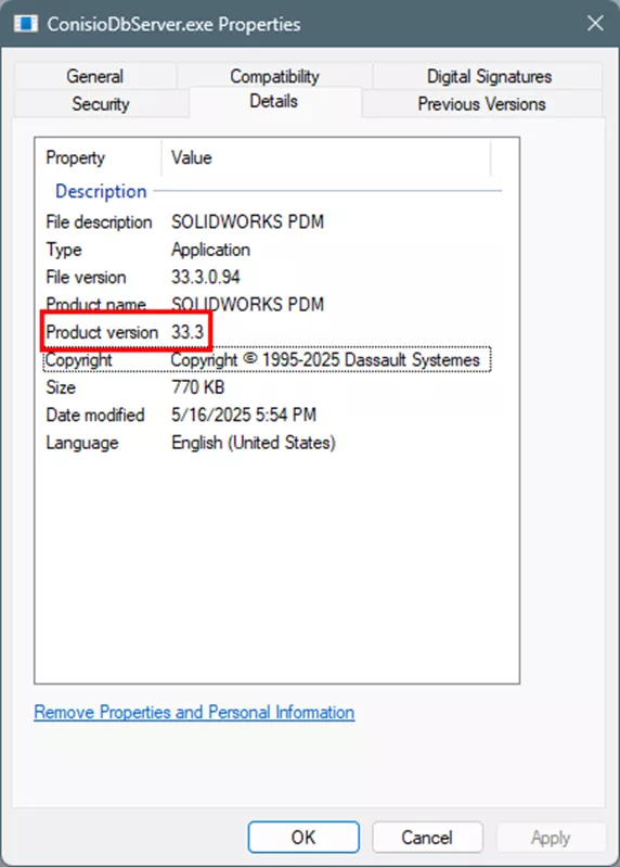

Right-click the service >Properties. Take note of thePath to executableshown there.
In File Explorer, locate the Database Server Service executable (ConisioDbServer.exe) based on the path you found above.
Right-click ConisioDbServer.exe >Properties. Go to theDetailstab and locate the Product Version.

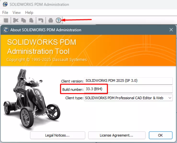

Open the PDM Administration tool.
Click the "?"button in the upper left to open the about information.
Take note of the Build Number.
In this example, the vault version is 33.3. The Database Service should also be 33.3. If these versions do not match, uninstall and reinstall the correct major year version of the SOLIDWORKS PDM Database Server product.

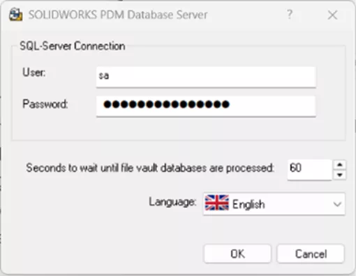

Once you’ve confirmed that the password for the ‘sa’ login works to log into SSMS, you can re-enter it in the Database Server configuration tool.
Open theDatabase Server Configurationtool. You can find it by searching ‘database’ from the Windows Start menu.
Ensure you’ve confirmed the SQL ‘sa’ password by logging into SSMS with it, and then re-enter the same password here.
Also, make sure that the wait time is not too high or low. This is the database polling time (the frequency PDM’s database service connects with the SQL database to grab new info), and the standard value is 60 seconds. It should not be lower than 30 seconds.
Restart theSOLIDWORKS PDM Database Serverservice from the Windows Services menu.

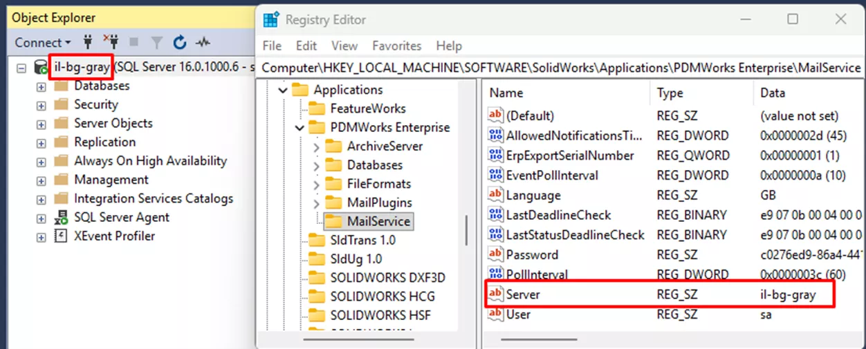

MailService Registry
Open the MicrosoftRegistry Editor.
Navigate to this key:Computer\HKEY_LOCAL_MACHINE\SOFTWARE\SolidWorks\Applications\PDMWorks Enterprise\MailService.
TheServerneeds to match the name found for the database in theSSMSexactly.
An easy way to confirm that the correct hostname and instance are being used is to log into SQL Management Studio for the correct database and see what is listed inObject Exploreron the left.
If no instance name is present after the server name, the PDM database is located on the default SQL instance and is just the server name. If PDM is using a named SQL instance, you’ll see the server name followed by a \ and the instance name, such as “PDMServer\SWPDM”.
SMTP Settings
Open theMessage Systemsettings.
On the SMTP Settings tab, ensure all the information is correct.
If a login is required, be sure the username and password are correct.

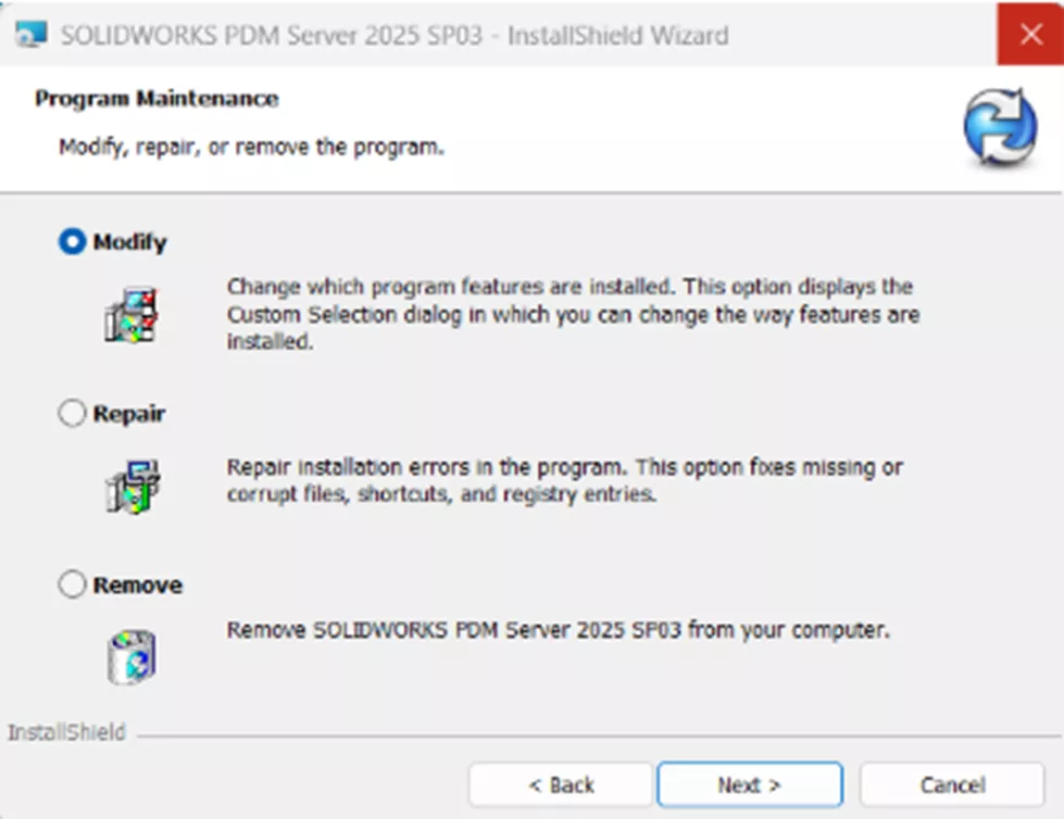

These steps will fix 90% of issues with the notifications, but sometimes you’ll go through every step and still have issues. If you still haven’t been able to figure out what is causing the issue, uninstalling and reinstalling the Database Server may resolve the issue.
Open thePrograms and Featuresapplication.
Find the PDM Server installation, right-click, and chooseChange.
Choose toModifythe installation.

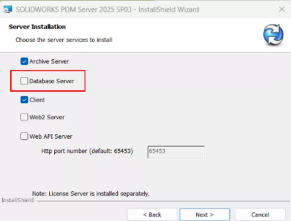

Deselect the Database Server.
Finish the Wizard to remove the product.
Open theRegistry Editorand delete this key: Computer\HKEY_LOCAL_MACHINE\SOFTWARE\SolidWorks\Applications\PDMWorks Enterprise\MailService
Reinstall the Database Server by modifying the installation again.
