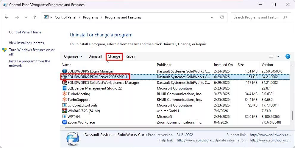

Install Web2 on an Existing PDM Server
If the PDM server components are already installed on the server where you'd like to host Web2, then you'll need to modify your existing install via Windows Control Panel to add the Web2 component after you've installed IIS.
In Windows Control Panel, find "SOLIDWORKS PDM Server 20## SP0#" and click Change.

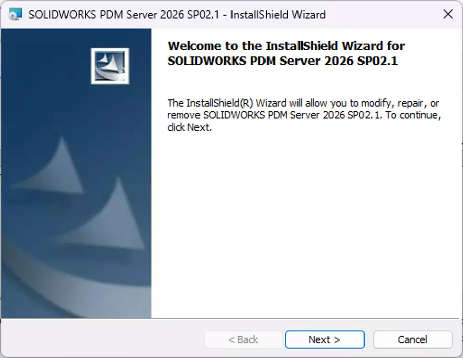

The PDM Install Wizard will pop up. Click Next.

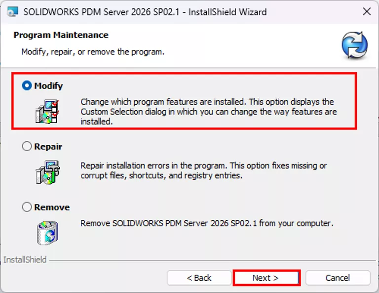

On the Program Maintenance page, select Modify and then click Next.
Modify Option in SOLIDWORKS PMD Install Wizard Program Maintenance

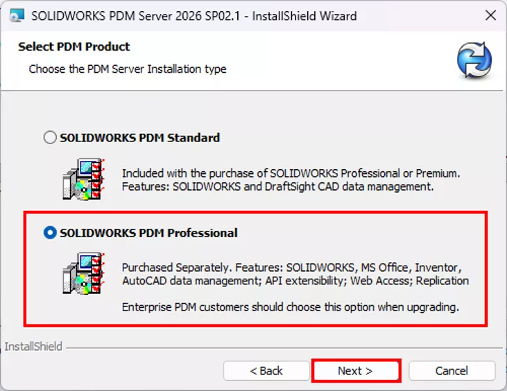

On Select PDM Product, leave the selection on SOLIDWORKS PDM Professional and click Next.

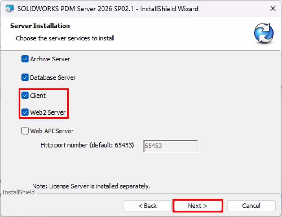

On Server Installation, check the box for Web2 Server. If "Client" is not checked, check it. Click Next

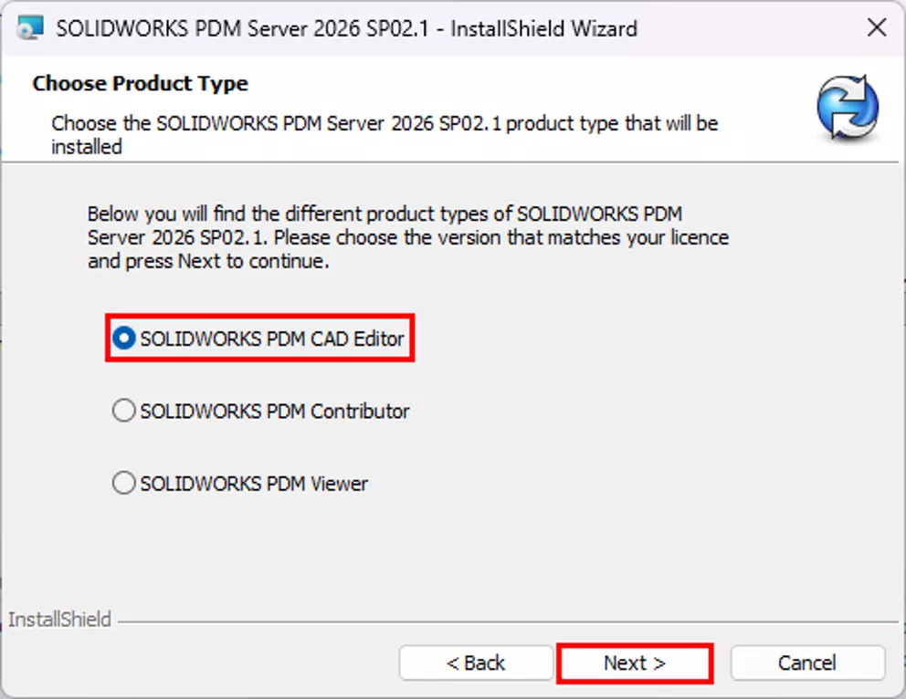

On Choose Product Type, ensure it's set to SOLIDWORKS PDM CAD Editor and click Next
SOLIDWORKS PDM CAD Editor Option in the Install Wizard

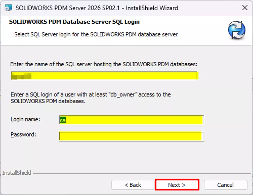

On SOLIDWORKS PDM Database Server SQL Login, the SQL server name and user should already be populated. If not, please enter the name (and instance, if applicable) of your SQL server. Enter the SQL 'sa' credentials and click Next
Select SQL Server Login for the SOLIDWORKS PDM Database Server

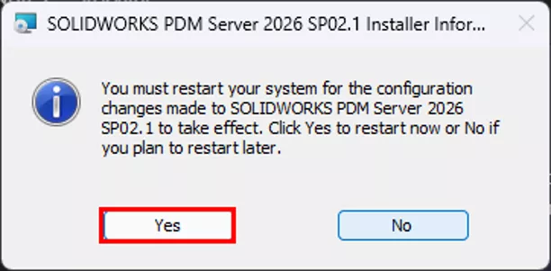

The system will run through the installation and finish any checks before coming up with a "InstallShield Wizard Completed" screen. You can click Finish to close out.
You will get a reboot pop up. Be sure to reboot the server before proceeding with further setup.
SOLIDWORKS PDM Server Reboot Message
