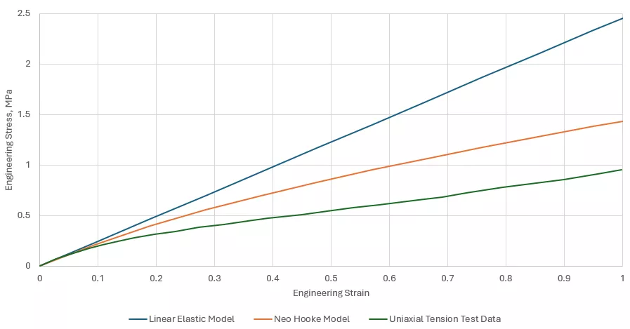

If all that is available is the shore value, the elastic modulus can be calculated by the Gent Relation. This resultant elastic modulus could then also be converted into a Neo Hooke material model by further calculating the shear and bulk moduli. When you compare the linear elastic and Neo Hooke models to the uniaxial tension test data below, you can see that they correlate only with very small strain levels - up to 5% in this example. If your application only considers small strains, these readily available and easy-to-calculate options may be a good choice. However, if you need to evaluate larger strains for your application, you will want to consider a more detailed material model.

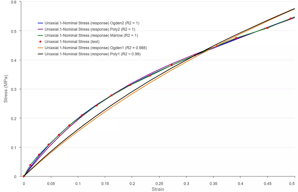

Let's take a look at an example. We will take only uniaxial tension test data and generate a Marlow, 1st/2nd order Ogden, and 1st/2nd order Polynomial material models. We will then compare the material models’ biaxial response of this data to the actual biaxial tension test data.
Uniaxial tension test vs response
Above, you can see that the Marlow and 2nd order Ogden and Polynomial models have a perfect fit, R2=1, to the uniaxial tension test data. The 1st order Ogden and Polynomial models also have an excellent fit of R2=0.99 to the data. Without considering the biaxial data, it can be tempting to select the 2nd order Polynomial or Ogden models if those are the models you typically work with. However, we do have the biaxial test data; let's plot these material models that have not been calibrated with respect to the biaxial test data to the actual biaxial test data.

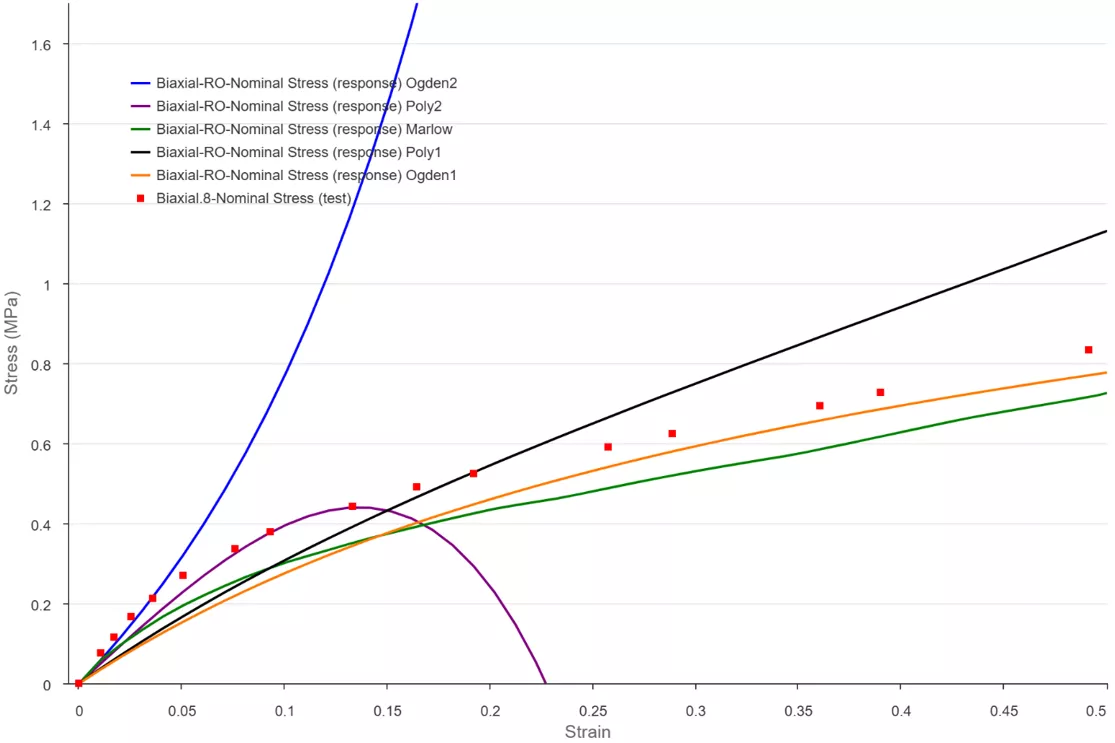

Biaxial tension test vs response
When we compare the Marlow, 1st order Ogden, and 1st order Polynomial to the test data, we see relatively good correlation for the biaxial response to the biaxial test data. However, when we up the Ogden and Polynomial models to 2nd order functions, the biaxial response becomes unstable and unusable. Therefore, it is highly recommended to avoid 2nd order or higher models when only having uniaxial test data. The Marlow model typically has the best performance and is recommended, as it utilizes the test data directly (perfect correlation for the uniaxial response) and will always generate a reasonable and stable biaxial/planar response.

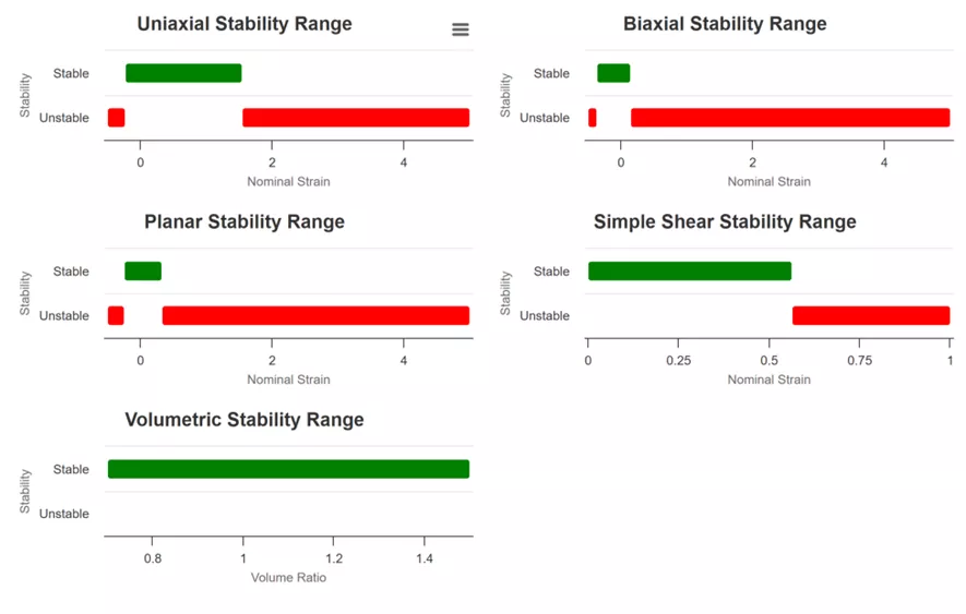

These instabilities can cause a plethora of issues in your model, such as convergence failures, mesh anomalies that dominate the result, and unpredictable stress or strain results. Materials strained beyond their stability limit in any modes of deformation should not be used for engineering decision-making. It is recommended to work with a 1st or 2nd order model whenever possible, even if the fit is not perfect. You can always check the stability of your material model using the Abaqus Material Evaluate option or in the 3DEXPERIENCE Material Calibration tool, as shown below.
Material displaying poor stability metrics

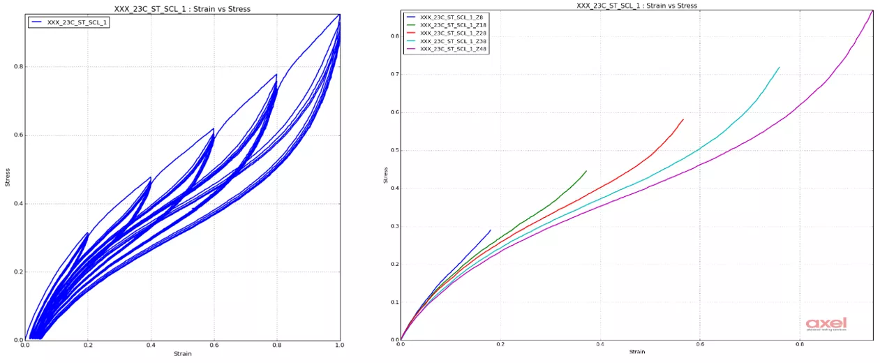

When simulating elastomers, we always need to consider the loading state of our application. The material response can have a significant difference if we are interested in the initial loading versus a subsequent or cyclic loading. This phenomenon is called the Mullins effect. In the example below, the elastomer is loaded up initially with Curve 1 and unloaded along Curve 2. When it is loaded again, it will load up along Curve 2, up to Curve 3, and then unload with Curve 4, etc.
Elastomer Mullins effect example
This is a critical effect because it may be important for your application to consider the initial (first cycle) loading versus subsequent loading in a conditioned state. To illustrate, imagine wanting to understand the performance of a rubber bushing in its regular, cyclically loaded use case.
This can only be done accurately if you account for the effects of its installation in the manufacturing process (i.e., a preceding load cycle). Abaqus and most nonlinear structural codes allow you to include the Mullins effect in your hyperelastic material models. A user can first load the model to obtain the initial structural response and then subsequently load it in the software to see the conditioned response. Another popular technique is to take the conditioned stress strain test data and treat it as the initial response. Then the user could see the conditioned response in their analysis with a single load case.
Left: Cyclically loaded uniaxial tension. Right: Single loading simple tension curves generated from extracting and zeroing the cyclically loaded uniaxial tension data
