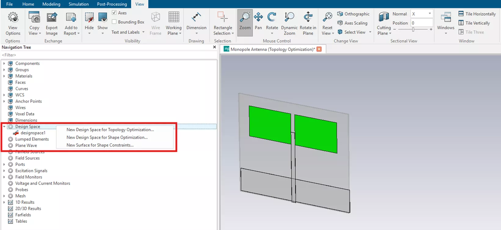

To access non-parametric optimization in CST Studio Suite, the first step is to define a Design Space, which is accessed through the navigation tree. The design space is a list of volumes or surfaces for topology or shape optimization, respectively. In the case of topology optimization, each tetrahedral of a finite element mesh of the design space corresponds to a design variable. The design variable interpolates the original and fill material.
After defining the design space, we can configure several movement constraints, such as symmetry and shape. A movement constraint is a limit that restricts how much and in what manner a design variable or an entity can change or "move" during a single optimization step. For this scenario, we set a mirror symmetry constraint.

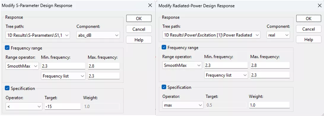

The next step is to define the Optimizer Goals. These are accessed through the Non-Parametric Optimizer feature in the Home tab of CST Studio Suite. In this example, the frequency range is 2.3-2.8 GHz, with return loss (S1,1) magnitude constrained to below -15 dB and radiated power set to maximize, targeting 0.5 W.
Radiated Power and S-parameter design responses are set as shown below.

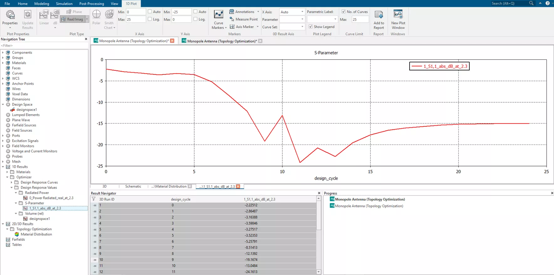

After starting the optimizer, all steps and design cycles will be visible in the CST message window. While the simulation is running, you can check the progress and obtain results using the Tosca GUI.
Back in the CST window, the working project optimization results will allow us to check radiated power and S-parameter values for each design cycle.

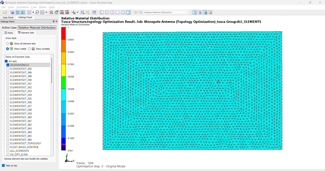

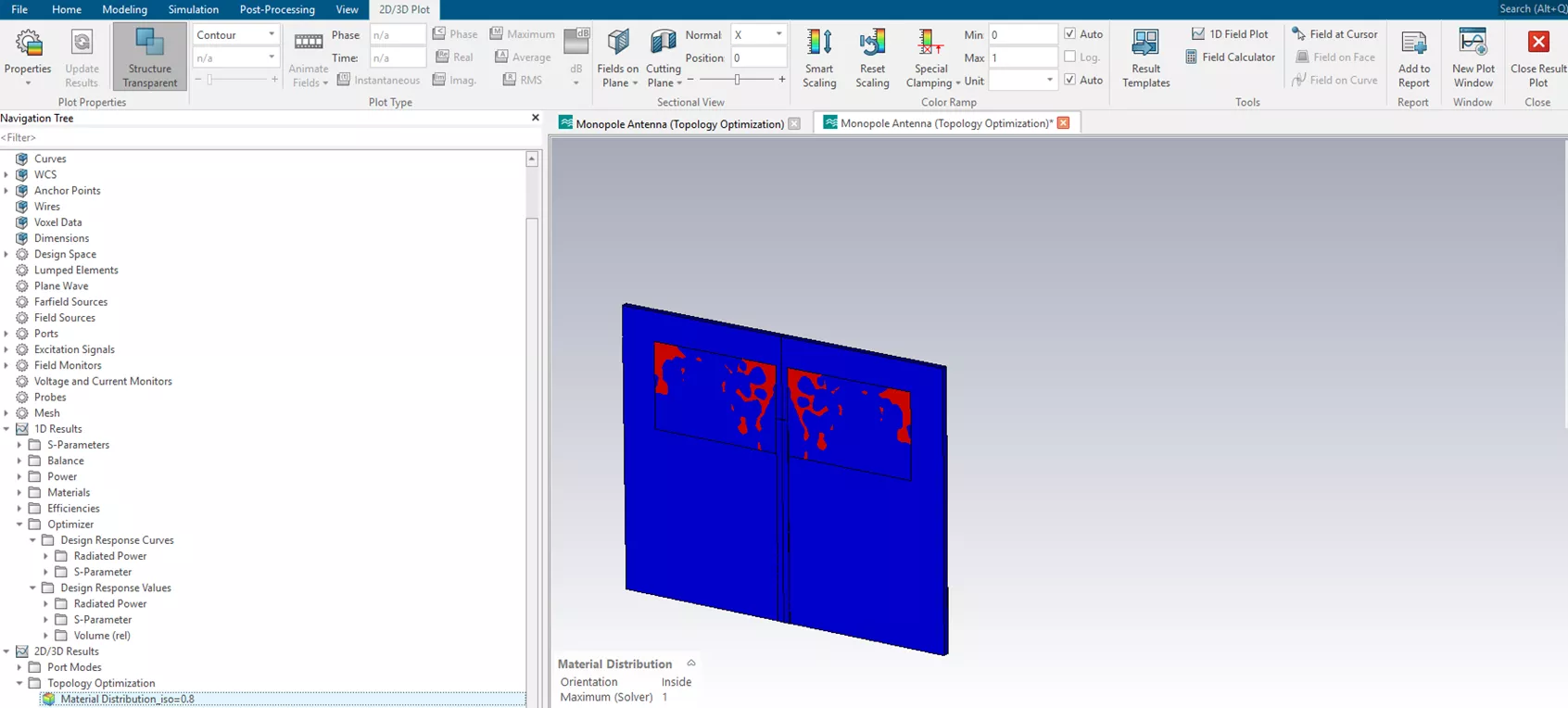

While the non-parametric optimization is running, CST creates a separate folder containing CST files for each iteration. By opening a CST file of an iteration, you can view the material distribution (i.e., the partially optimized design) by going to the Non-Parametric Optimizer Settings to select a value for the iso-cut threshold. Then, apply the changes and click the Verify button.
The material distribution is mapped on a 0 to 1 scale, as shown below. 1 (Red) refers to the conductivity value from the original material (ohmic sheet), and 0 (Blue) refers to the conductivity of the filled material (vacuum).

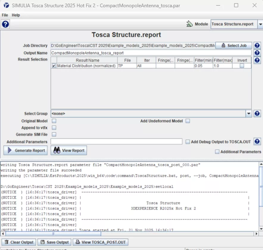

Different iso-cuts will result in different responses. This is simply due to the difference in topologies. If the topology has edges in the metal traces, it will have low conductivity, which will result in dissipation and will also load resonant modes. When an iso-cut is done, the topology’s contour requires smoothing of the mesh nodes. This routine differs between CST and Tosca, and we should expect differences in the EM results. After CST results verification, we can export the optimized design as a CAD file through Tosca.
