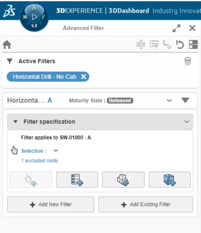

Selective Loading will also let you isolate to a specific system within your design by filtering on custom properties, maturity states, or even physical volumes/areas. This allows you to quickly zero in on relevant components. This targeted approach eliminates all the noise, so you can work with precision.
What's New 3DEXPERIENCE 2026 Selective Loading for Large Assemblies
Finally, Selective Loading supports the creation of filters that can represent different variations of your design. These can be saved, reused, and even released as part of your design documentation. These filters act as a saved version/view of your assembly and can be referenced directly by drawings. This means your documentation stays accurate and aligned with the exact representation you intended.

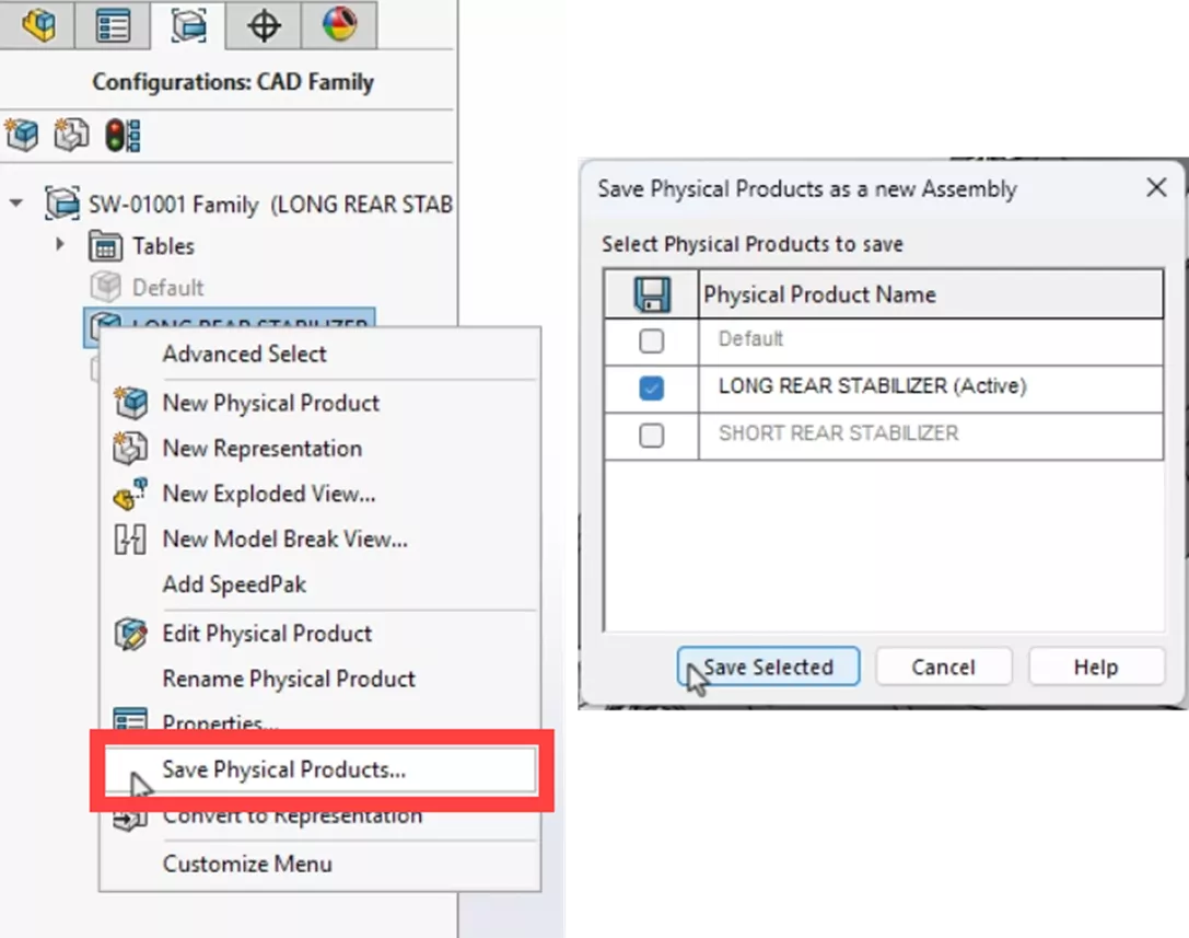

Save Configuration as New Physical Product
With SOLIDWORKS Design 2026, you can save configurations as a new, individual physical product. This allows for greater flexibility in how you structure your designs and provides full control over managing the associated references on the platform when saved.

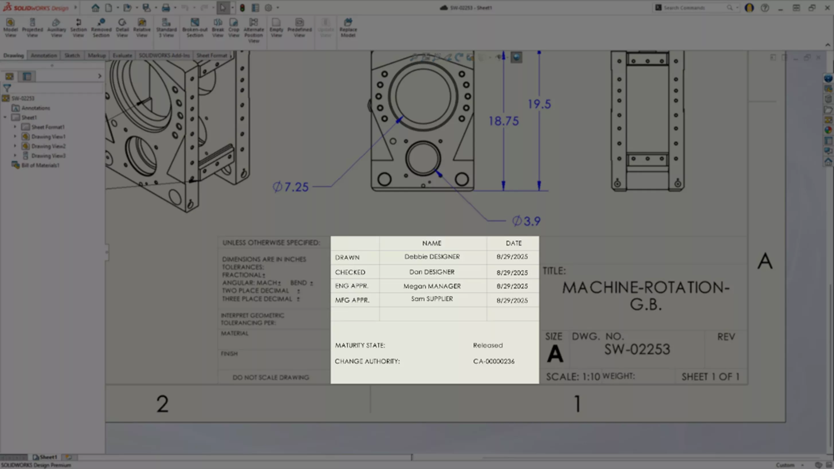

Drawing Stamping
User names, approval dates, and maturity status are all important parts of the change process. With SOLIDWORKS Design, drawing stamping now happens automatically as each change action task is completed, providing a final drawing that’s complete and accurate.

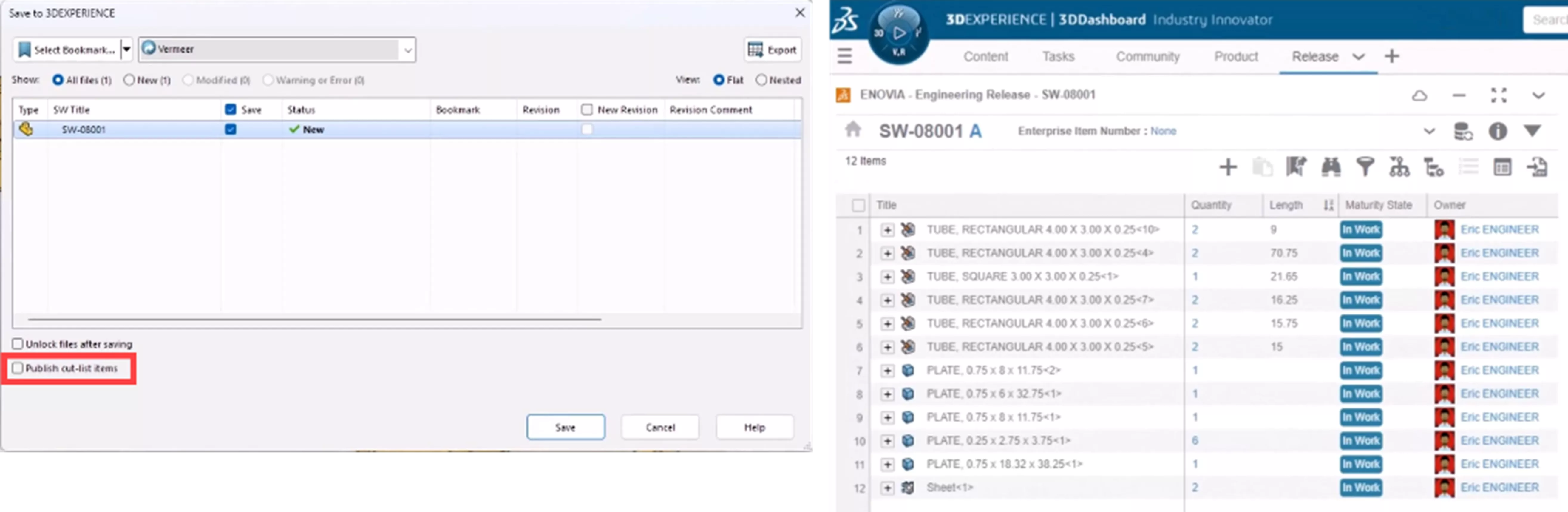

Weldment Cut Lists
SOLIDWORKS Design now provides support for saving weldment cut lists to the 3DEXPERIENCE platform. As you save your design, use the checkbox on the Save As menu to indicate that you want the cut list items published. Weldments that contain structural, sheet metal, and plates are all supported. Once saved, the cut list items will be reflected in the task pane and accessible on the 3DEXPERIENCE platform, allowing you to build a more accurate engineering bill of materials.

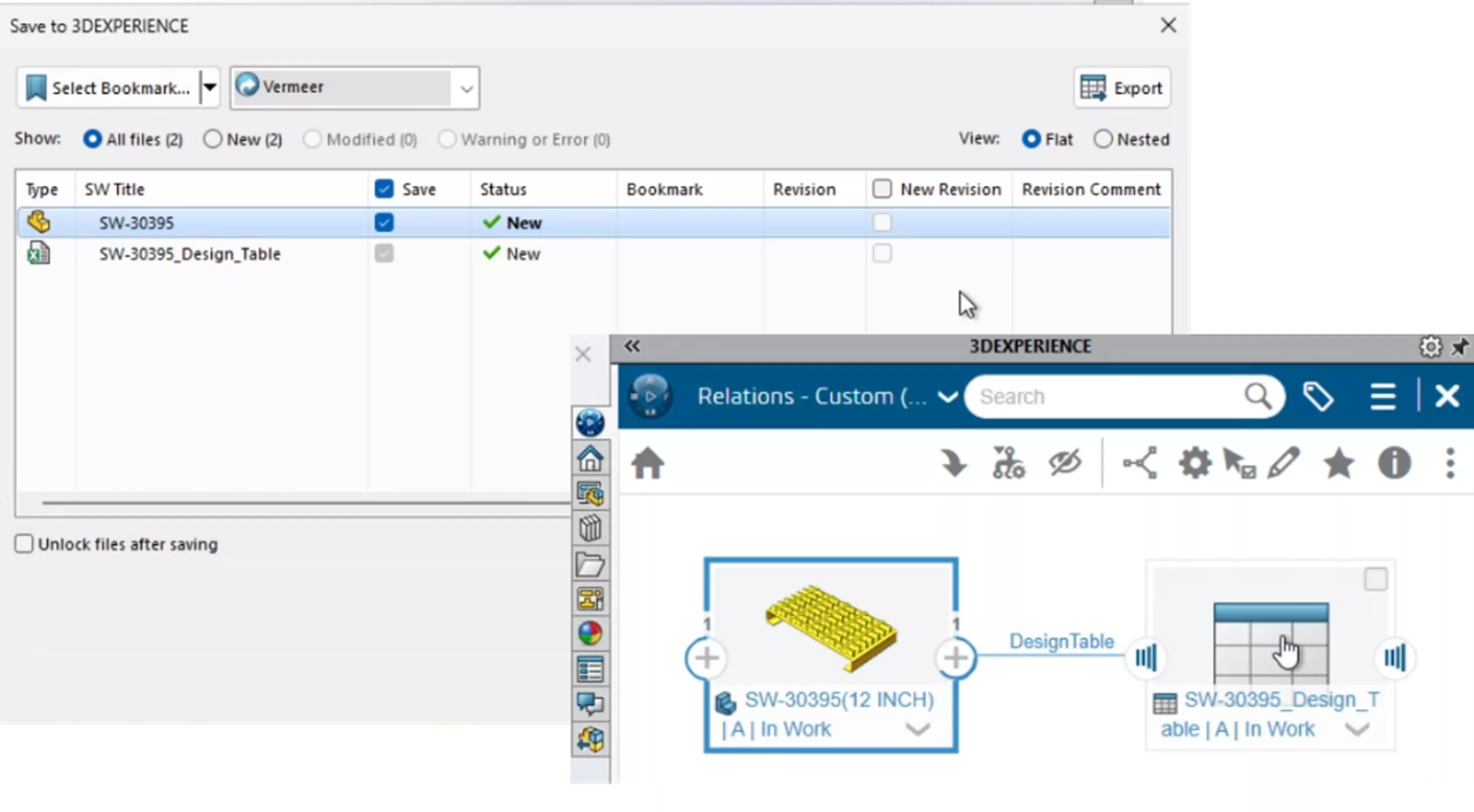

External Design Table Support
Now, when you save your components to the 3DEXPERIENCE platform, any links to external design tables are recognized. The external table file will be stored with the part in the platform, and you will see the reference relationship between the two items.

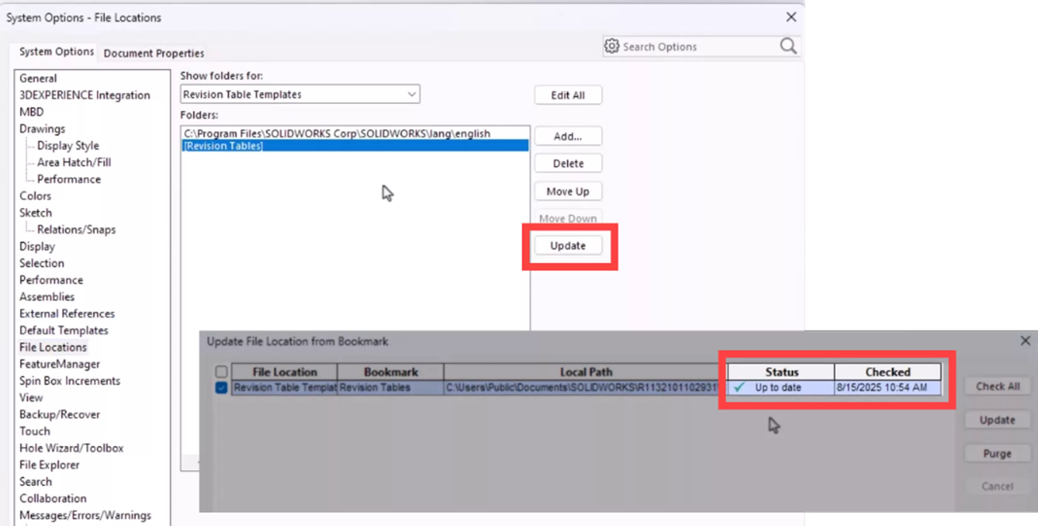

System Options – File Locations – Bookmark Update
SOLIDWORKS Design now provides the ability for System Options – File Locations that reference a 3DEXPERIENCE platform bookmark to update automatically, ensuring you always have access to the latest content.
