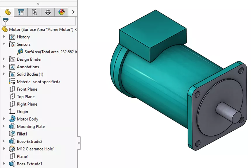

In a previous blog post, Using Sensors to Monitor Surface Area, I had the idea of using SOLIDWORKS Sensors to track the surface area of certain exposed faces of a guide rail assembly. I would then use this surface area information to determine how much stain I would need to apply two coats to my guide rail.  Furthermore, if my design dimensions changed, my surface area sensor would immediately update, and I could quickly (and more accurately) figure out the new amount of stain required. The process was as simple as using the Measure tool, selecting all exposed faces, and then using the Create Sensor option within the Measure tool window. This would then track my surface area.

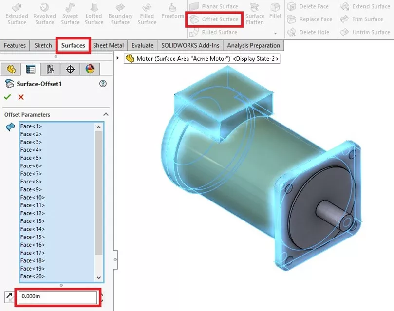

After creating a configuration, the first step in this workaround is extracting all the faces from which you're trying to calculate the surface area. For this example, I’m looking to extract all the turquoise-colored faces of the motor below. I want to calculate the total surface area of all the surfaces that will get painted.
Extracting Surfaces in SOLIDWORKS
We can accomplish this using the Offset Surface command on the Surfaces tab/toolbar. In the PropertyManager, select the desired face.  Here, after setting a 0.000 in. offset distance, I'll hit OK and get a single surface body that represents the area of the surfaces that I want painted.

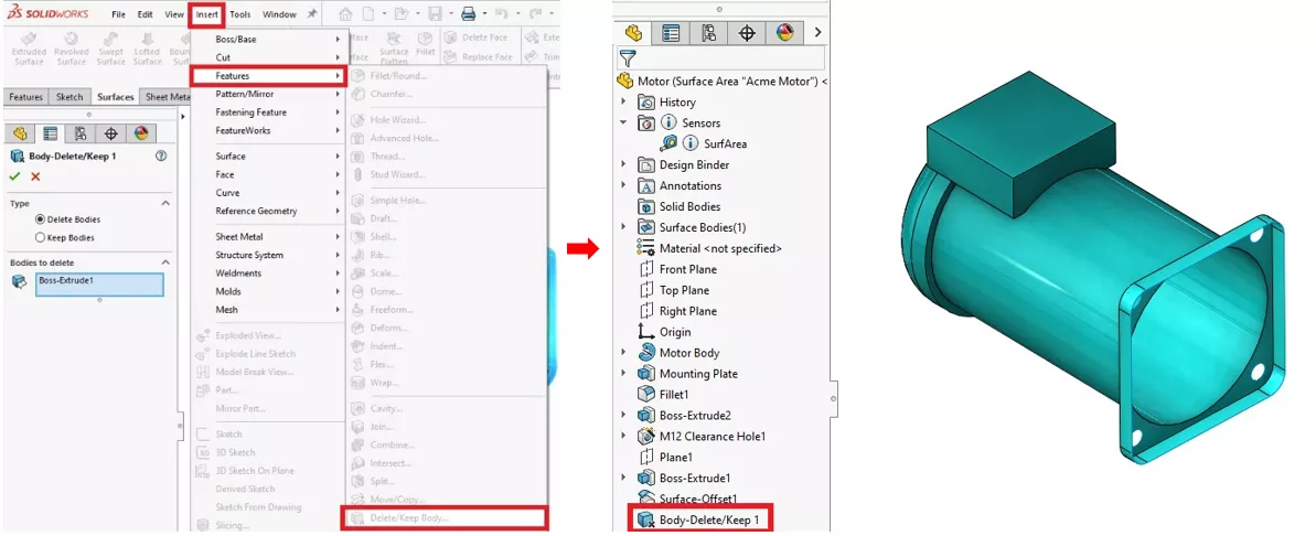

After creating the surface body, I then need to delete the solid body for this configuration. This is important because I don’t want it to interfere with my surface area calculation. The Delete/Keep Bodies feature, located under the Insert > Features pull-down menu, is used to accomplish this.
Use the SOLIDWORKS Delete/Keep Bodies Feature under the Insert > Features pull-down menu.

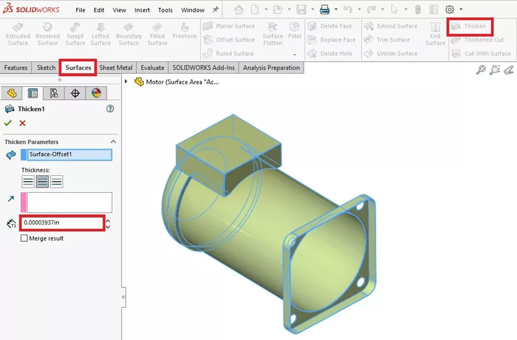

Once I have my surface body, I can use the Thicken feature on the Surfaces toolbar (to get back to a solid body). But the key is to make sure the thickness value is as small as possible. This is done so that the wall faces of the thickened body actually become negligible in the total surface area calculation.
Calculate Surface Area in SOLIDWORKS

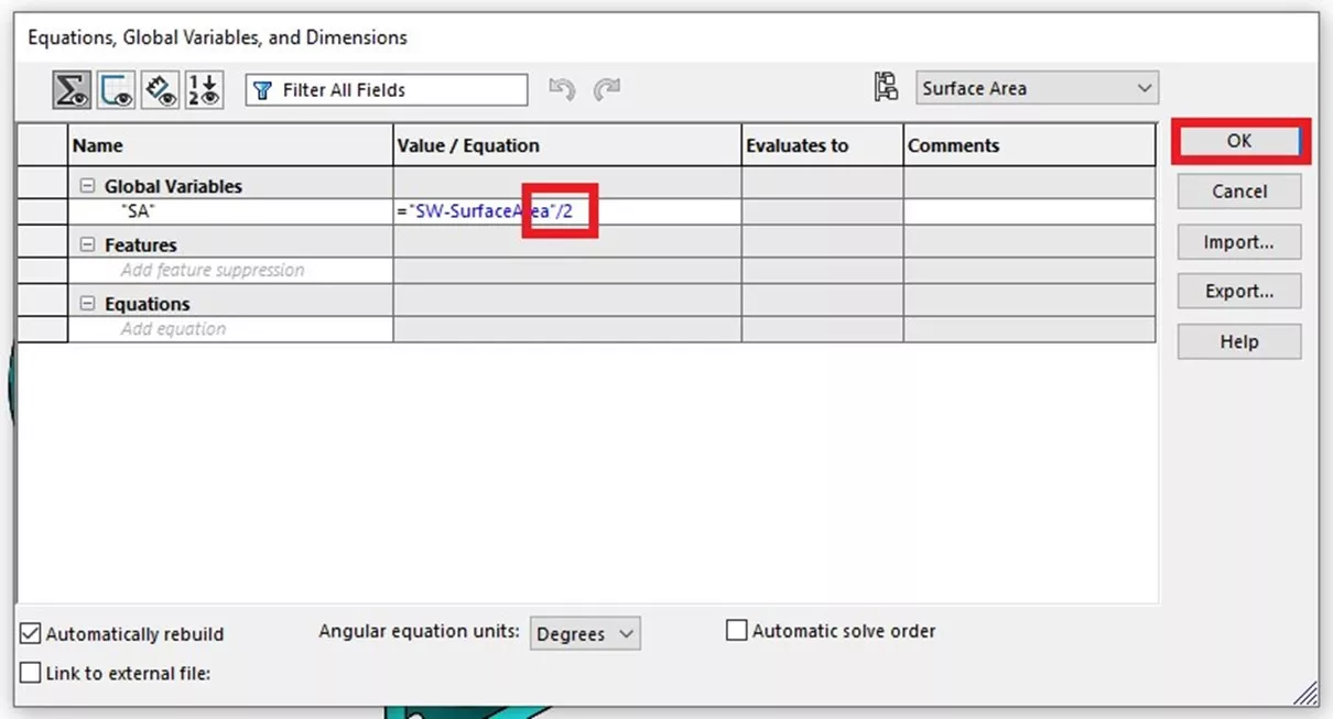

Now, to get the surface area of just the turquoise-colored faces as seen in my first image, I will set up an equation and take the total surface area of this newly created body and divide by two. With my wall thickness set so small, I can pretty much ignore the surface area of this thickened region. This area is negligible, and I have found that it only differs by about a thousandth of a square inch.

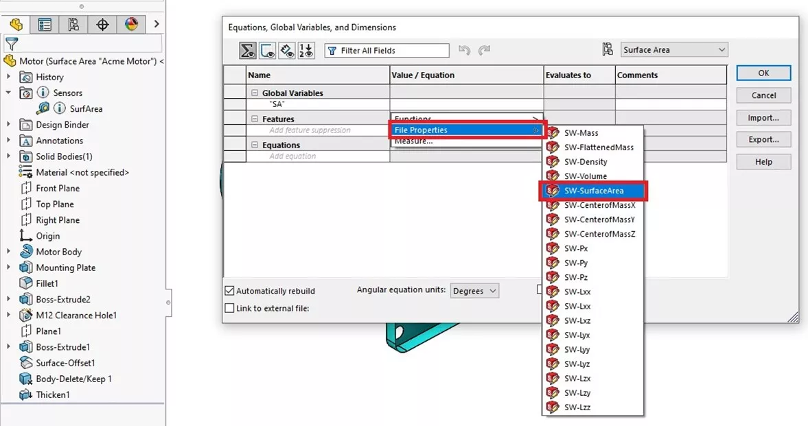

To create an equation, use the Equations editor found under the Tools pull-down menu. Here, I created a global variable called SA. In the Value/Expression column, I start the equation by selecting the SW-SurfaceArea property from the File Properties pull-down menu. This, again, is the total surface area of the whole solid body, including the inside and outside surface areas.
Create an Equation in SOLIDWORKS
Next, I will complete the equation by typing / 2 and clicking OK. This will then evaluate to 232.663 in^2

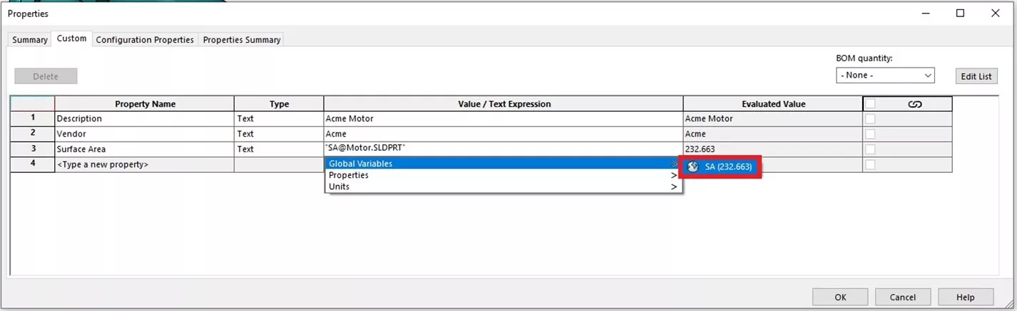

At this point, we now have a global variable that can be added to our Custom Properties, which can then be used in title blocks, Bill of Materials, or Data Cards within SOLIDWORKS PDM.

I now have the surface area of just the turquoise-colored faces, and can include that information in my Custom PropertyManager. The total coverage for one motor is approximately 232 in^2, and, upon multiplying that by the total number of motors, I can get the total amount of paint needed for this project. This workaround is also great for those looking to extract the surface area of one side of their sheet metal parts. This was another request I received that utilizes this same process.
