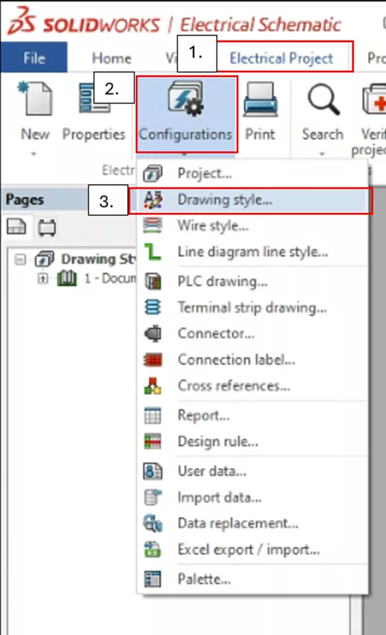

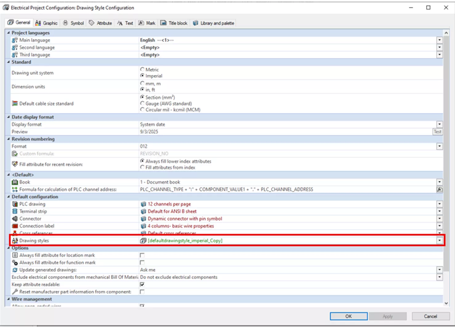

Under the Electrical Project tab, select the down arrow under Configurations and click Drawing styles...
SOLIDWORKS Electrical Drawing Style Option

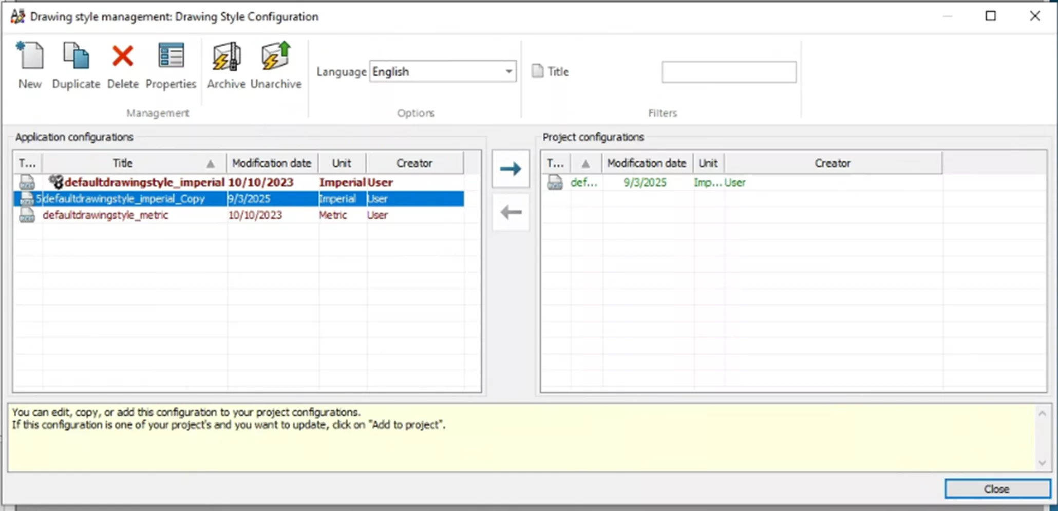

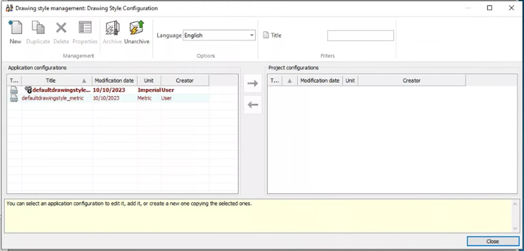

This will open the Drawing Style Manager. From here, you can see several commands and two sets of lists: Application configurations and Project configurations.
The Application configurations contain any custom-made drawing styles or the two default configurations. This is the main list of drawing styles, and can be accessed from any project. The Project configurations are drawing styles that have been added to the current project.
SOLIDWORKS Electrical Drawing Style Manager
This command lets you control the Application Configurations. First, there is the option to create a new configuration from scratch, adding exactly what you want for your projects.
Another option is to create a duplicate of the currently selected Application Configuration.
The third option is to delete, which, as stated, allows you to delete the currently selected configuration.
The properties command lets you modify the currently selected configuration.
The ability to archive and unarchive configurations is also available. This process lets you save and share configurations, much like an Environment archive.

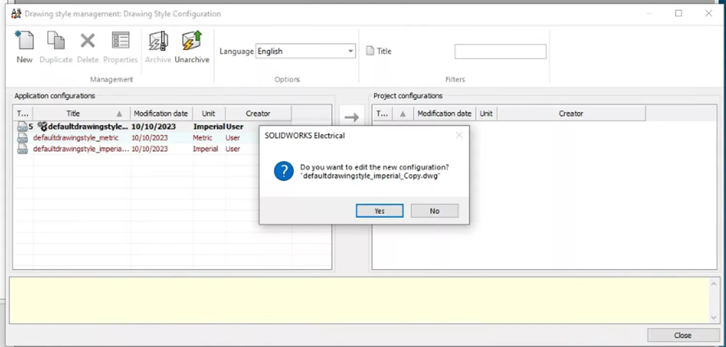

Now that we have a handle on the commands we can use, let's go over an example and start by duplicating the Defaultdrawingstyle_imperial configuration.
A prompt will appear with the option to edit the new configuration. For this example, we'll select Yes.
SOLIDWORKS Electrical Message Do You Want to Edit the New Configuration?

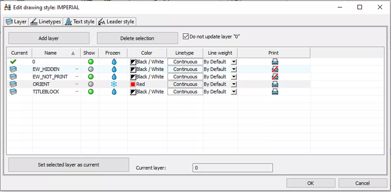

Here, a new menu, named Edit drawing style: IMPERIAL, includes several tabs. Starting with the Layer tab, you can see the default layers and their settings.
Layer
Layer Tab in SOLIDWORK Electrical
The Current column lets you control which layer is the current layer. Select a layer and click the Set selected layer as current button in the bottom left corner.
In the Name column, you can change the name of the current layers and set the name of new layers.
The next column (Show) indicates whether a layer is set to show (green circle) or is hidden (grey circle). Hidden items will not be printed.
The Frozen column is visually similar to the show column. If we were looking to improve performance, using the show and hide column is the better option.
The next three columns pertain to how items on a layer will appear, such as color, line type, and weight.
Lastly, the Print column determines whether items on this layer will show when you print the drawing.

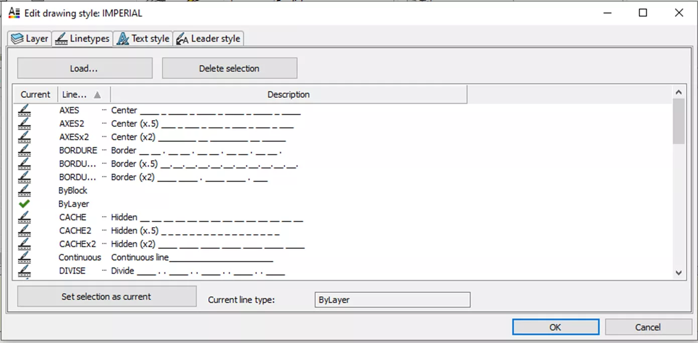

Linetypes
SOLIDWORKS Electrical Linetypes Tab
The Linetypes tab contains various line styles that can be accessed in the drawings for wires, cables, etc. In this tab, you can load new line styles from XLIN files or delete the current selection. You can also select the current line style to be the currently active line style in your project.

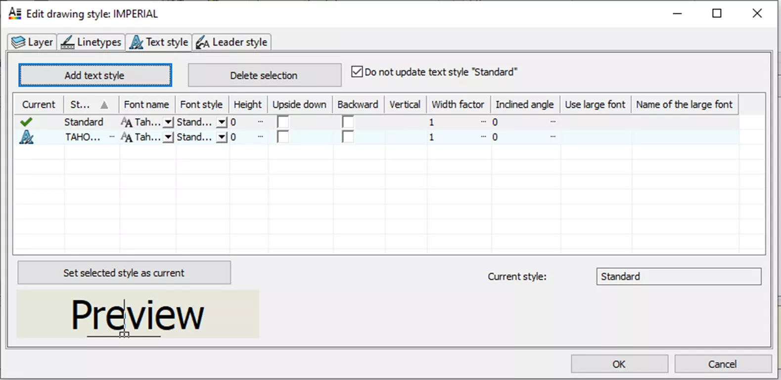

Text Style
SOLIDWORKS Electrical Text Style Tab
In the Text style tab, you can add and delete text styles and set the current selection as active. Unlike the Linetypes tab, there is plenty of control over these styles, for example, changing the font and its parameters.

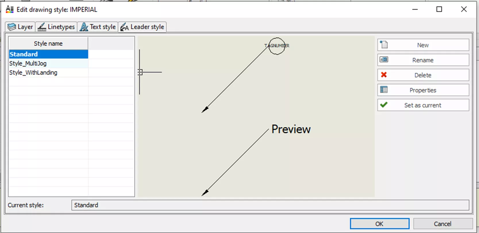

Leader Style
SOLIDWORKS Electrical Leader Style Tab
The Leader Styles tab contains a list of your existing Leaders, a preview, and commands.
These commands are similar to the commands we have seen before.
  • New creates a new leader style. This leader style starts off as a copy of the selected leader that can then be modified.
  • Rename allows you to rename the selected leader.
  • Delete allows you to delete the selected leader style.
  • Properties allow you to modify the settings of the selected leader.
  • Set as current sets the selected Leader Style as active.

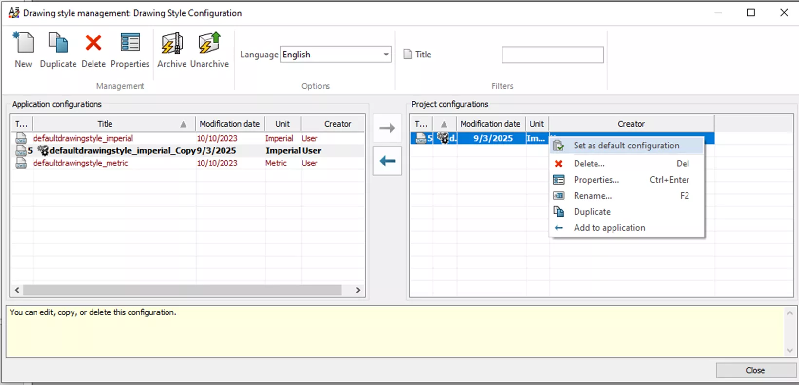

Once all modifications have been made to your Drawing Style, hit OK. This returns you to the Drawing Style Management menu. With the new Drawing Style selected, select the right arrow to add your Drawing Style to the Project.
SOLIDWORKS Electrical Set as Default Configuration
Right-click on the Project Configuration and select Set as default configuration. This replaces the current drawing style in the Configurations Project Menu.
Set as Default Configuration Option in SOLIDWORKS Electrical
