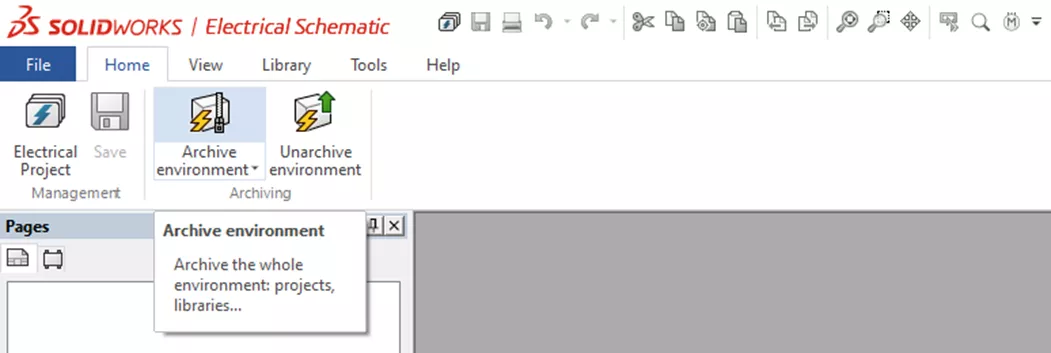

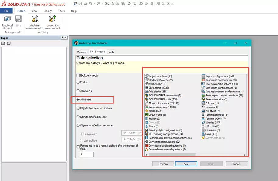

For proper archiving of all objects, there should be no open projects. To this end, it is suggested that this part of the process be scheduled for off-hours when there would normally be no user activity. Open SOLIDWORKS Electrical on any client machine that is connecting to the existing server and run the environment archive command, selecting to archive all objects.
From the SOLIDWORKS Electrical Home tab, select Archive Environment.

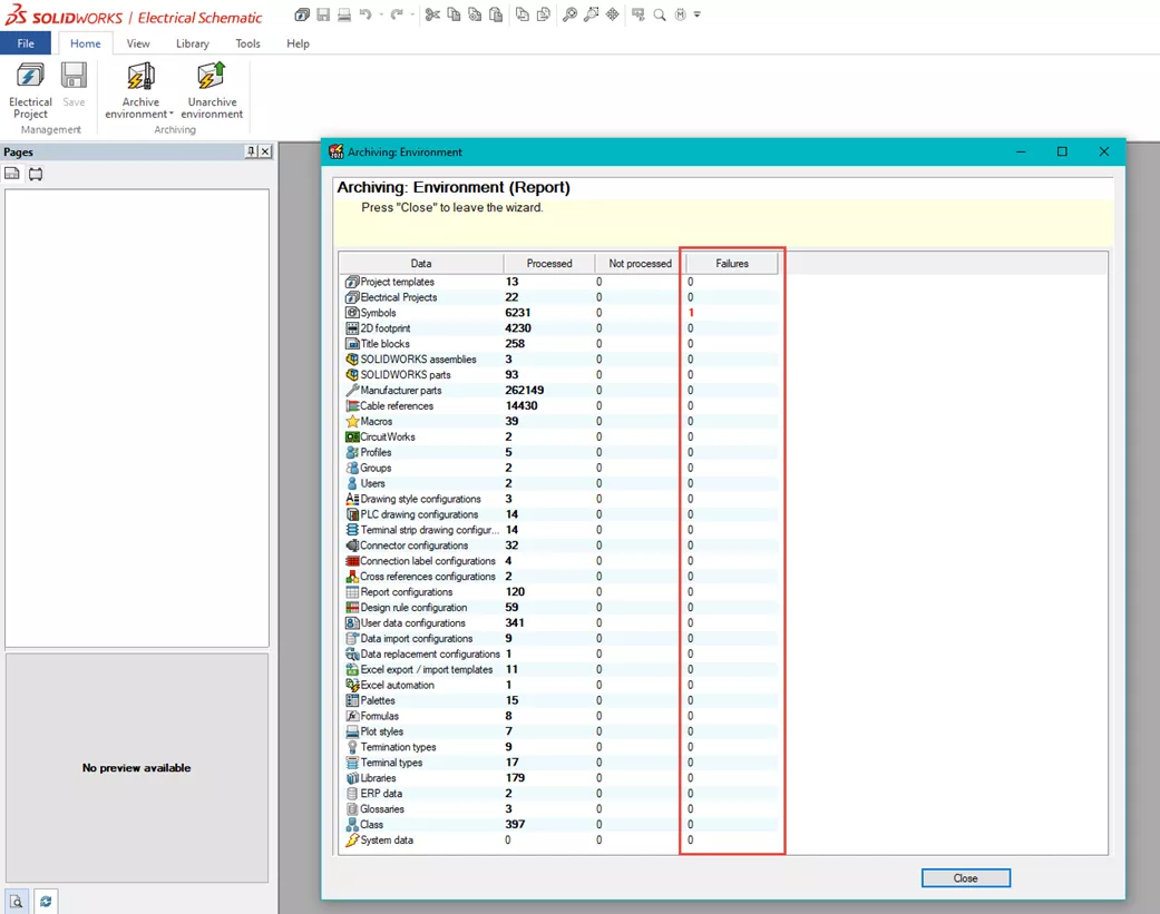

Within the Archive Wizard, select the option for All Objects. This ensures that all the data is captured in the archive.
The time it takes to complete this varies, depending on the size of your libraries and the number of projects. When the Archive Wizard has been completed with no failures, you can proceed.

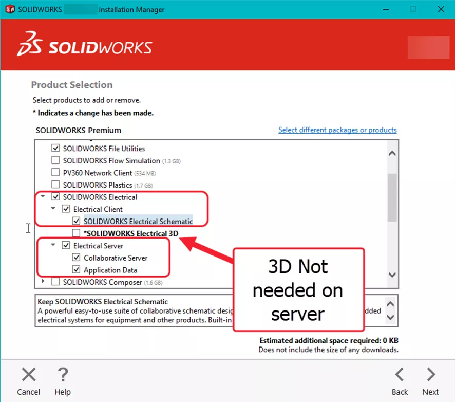

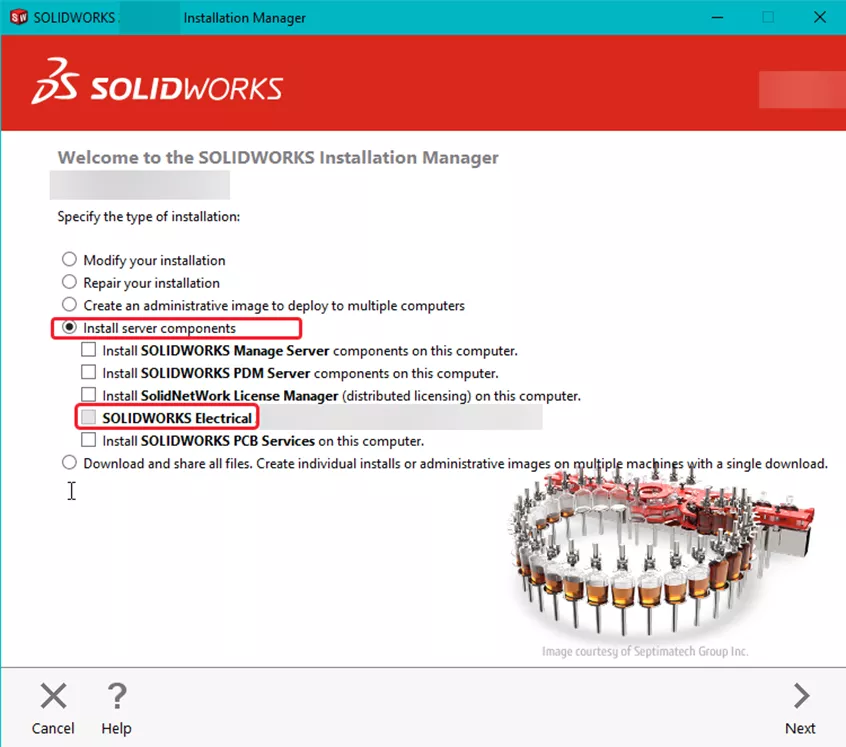

On the destination server, you must install the following components:
Although not required, it is recommended to install the 2D client on the server if possible. This is invaluable in troubleshooting problems.

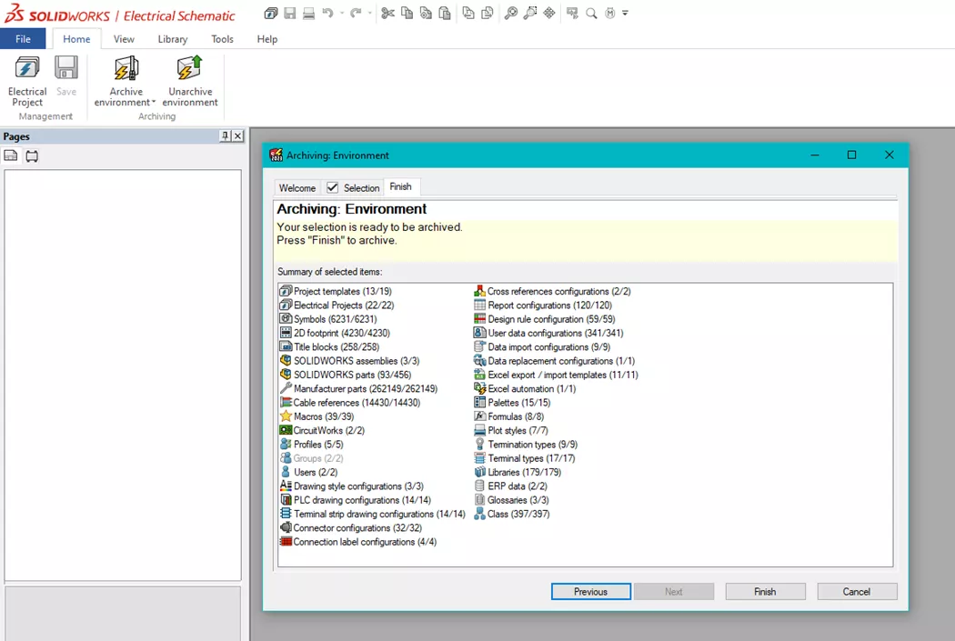

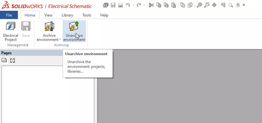

From the 2D client on the server, run the SOLIDWORKS Electrical application.

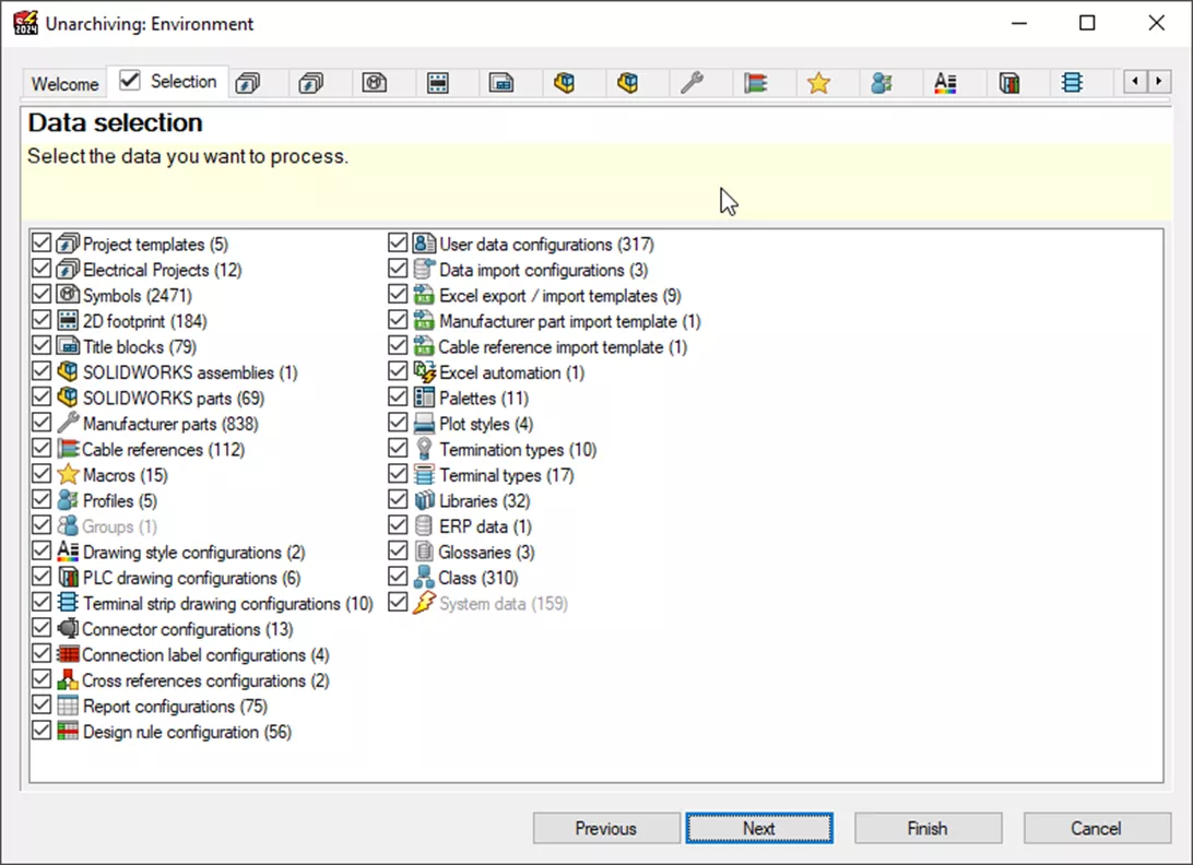

On the Home menu ribbon, select Unarchive environment, browse to your archive file, and select it.
When the Unarchiving Environment display opens, leave all objects selected and click Finish.

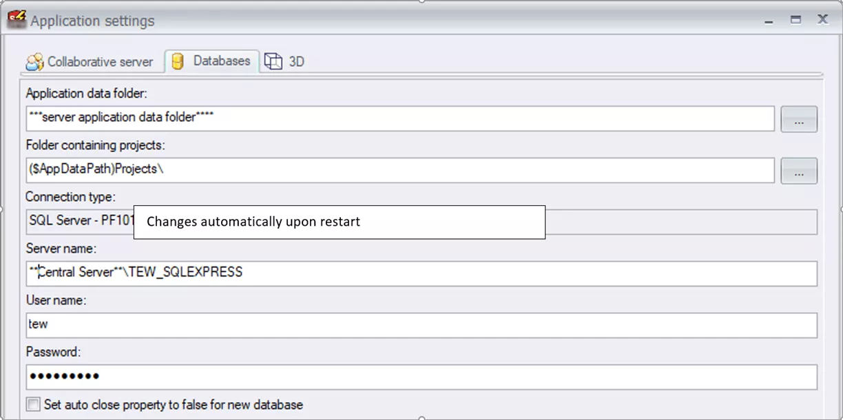

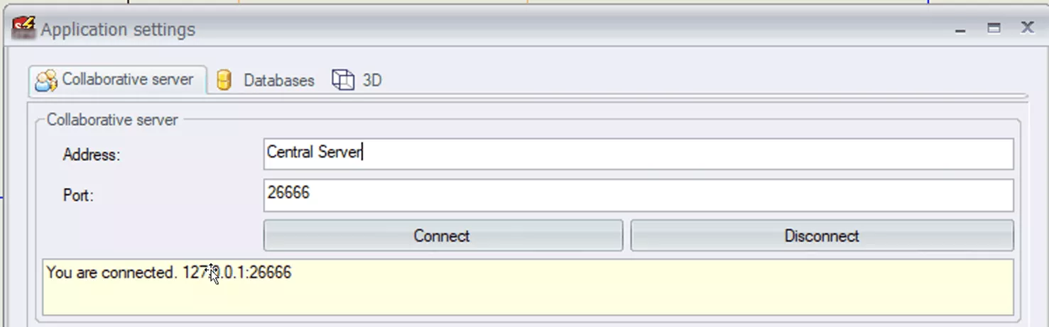

Once that is complete, or if the client software does not require an update, open the software and navigate to Tools > Application Settings.
Change the Collaborative server tab and the Databases tab (SQL Server) to point to the new server, as shown below.
The collaborative server’s name or IP address can be used for the address. The port number is the default SOLIDWORKS Electrical collaborative service communication port. Unless it has been specifically changed, leave the default.
On the Databases tab, you will need the path to the Application data folder. This is the folder on the server that contains the SOLIDWORKS Electrical data.
The Folder containing projects field shown indicates that it is a subfolder of the SOLIDWORKS Electrical Application data folder.
The Connection type will continue to list the old server until you restart the software. After restarting the software, check that the setting changes were retained. If they were not, you may need to launch the software as an administrator and try again, so that the software will be allowed to make the necessary registry changes. The Server name field is the server and SQL instance for SOLIDWORKS Electrical on the host server. The User name should always be tew, and the password is what was established during the server installation.
