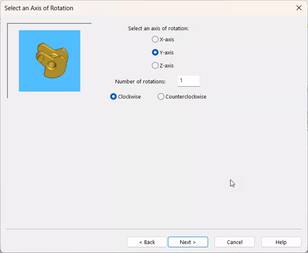

If you select Rotate model, click the Next button, and you'll be taken to a page with settings that control how the model will rotate. You can choose to rotate about the assembly-level X, Y, or Z axes. An animated preview on the left shows a preview of how that will look. On this page, you can also change the number of rotations and whether they are clockwise or counterclockwise.
Figure 3: Animation Wizard Select an Axis of Rotation page

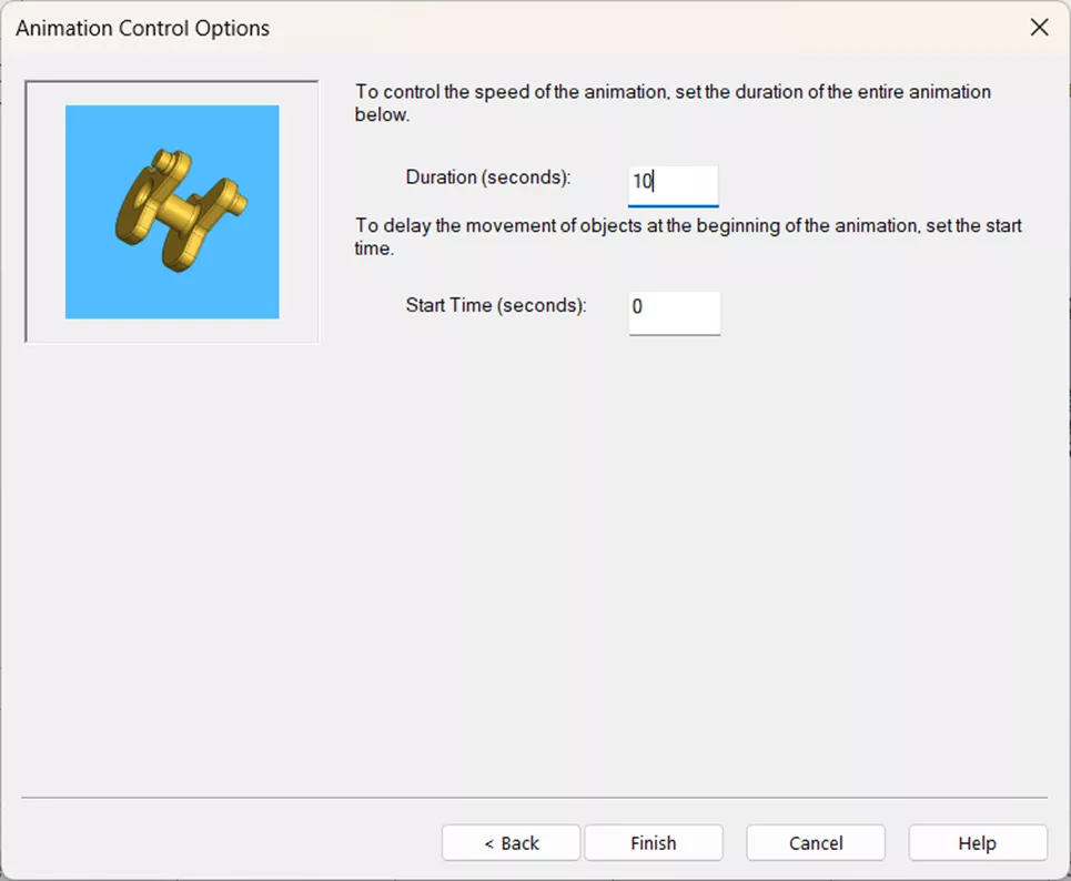

On the next page, you can set how long it takes the model to rotate the number of rotations specified. By default, the animation will start wherever your time bar is currently, but if you want to change it to a different time step, here's the place to do it.
Figure 4: Animation Wizard Animation Control Options page

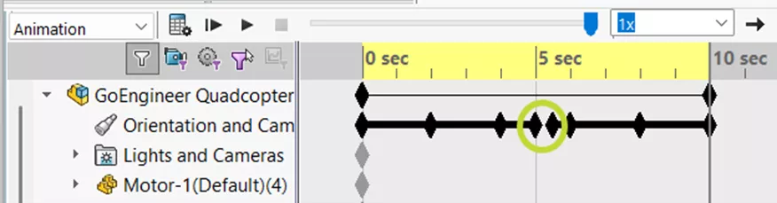

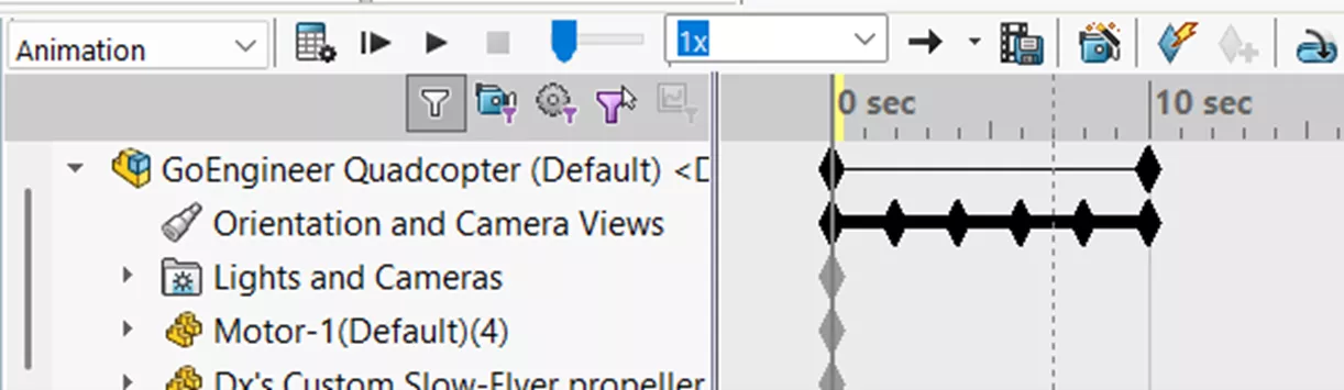

If we examine the timeline after using the Animation Wizard, we can see that for Rotate, keys are created in the Orientation and Camera Views row. The view orientation is changing, which is giving the appearance of the model rotating. Explode and Collapse, on the other hand, both create keys for the components that are being exploded. Keys represent positions, and the changebars between them represent movement. In this kind of animation, the components are actually moving.
Figure 5: Timeline after Rotate model
Figure 6: Timeline after Explode
While the Animation Wizard is a great tool for simple animations and can serve as a starting point for more complicated ones (as we’ll discuss), it doesn’t cover everything. One simple way to create your own custom animations is to create view orientation key points in the Orientation and Camera Views row of the timeline. The Animation will interpolate between them, transitioning from one to the other. Looking again at Figure 5, we can see that this is what the Animation Wizard is doing when we use it to rotate the model.

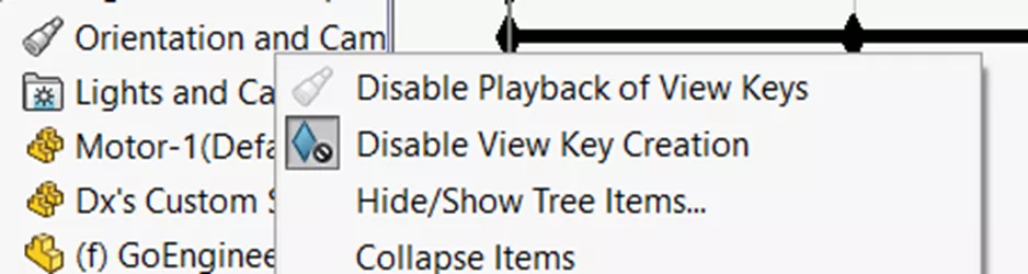

At this point, it is helpful to pause and consider the options available in the in-context menu when right-clicking different places in Orientation and Camera views. This will give you a better idea of what you can do when animating view orientations.
Figure 7: In-context menu when right-clicking the Orientation and Camera Views folder
To start, if you right-click on Orientation and Camera Views in the Motion Study FeatureManager Design Tree (Figure 7), you’ll only see two Motion Study-related options:

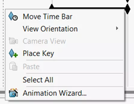

If you right-click in the Orientation and Camera Views row in the timeline where there is not already an existing key, you’ll see the following options:

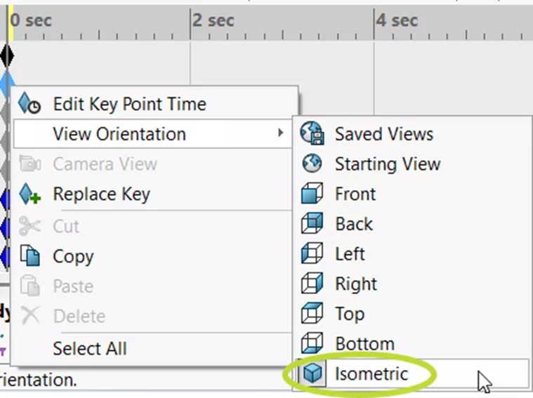

Here, we want the animation to start in the standard, Isometric view orientation. To ensure that, right-click on the key at 0 sec and select View Orientation > Isometric.
Figure 10: Right-click menu for view orientation key at 0 sec

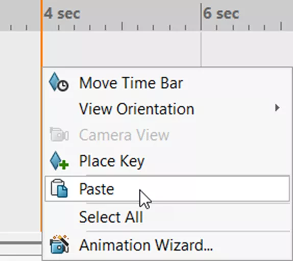

To stay zoomed in for 2 seconds, we need a copy of the key we just created. If you have two keys with the same view orientation one after the other, the effect is that the view won’t transition to anything different; it just stays on that view orientation for the duration. Right-click the key that was just created and select Copy. Then, right-click at 4 seconds and select Paste.
Figure 12: Copy option
Figure 13: Paste option

Click on the Animation Wizard. In it, select Rotate Model and, on the next page, pick the axis of rotation. For this model, we are using the Y axis. Set the number of rotations to 1 and the direction to clockwise. The duration is 10 seconds, and the start time is 0 seconds. Click Finish to create a series of view orientation keys at 2-second intervals.
Figure 14: View orientation key points created by Animation Wizard
At the 5-second mark, we want to pause rotating to zoom in on a detail on the back of the model. Click and drag the time bar to the 5-second mark, then right-click and Place Key. Right-click the new key and copy it. Then, paste the key next to it.
Figure 15: Circled are the new key and its copy. Note the gap between them
