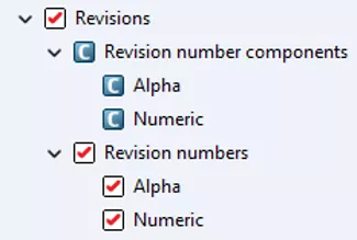

The SOLIDWORKS PDM Administration tool’s expanded Revisions node
Image A: The PDM Administration tool’s expanded Revisions node
When you define a component, you give the database a known string with sequential values, whether that be a pre-built format string or a custom-defined list of values. The most common components are numeric and alphabetical, meaning your revision values consist of 1, 2, 3… or A, B, C… so on and so forth.

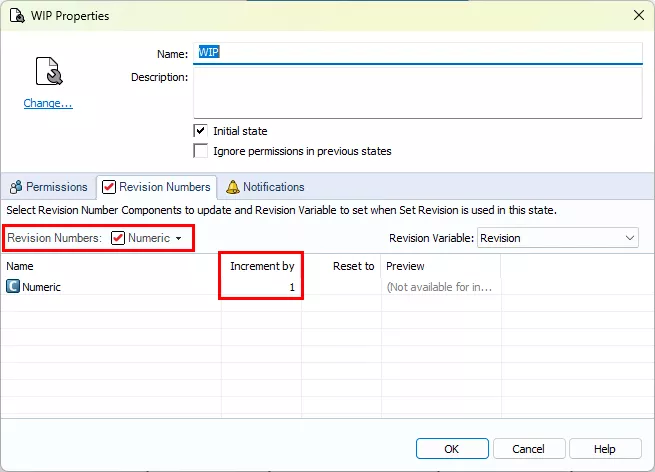

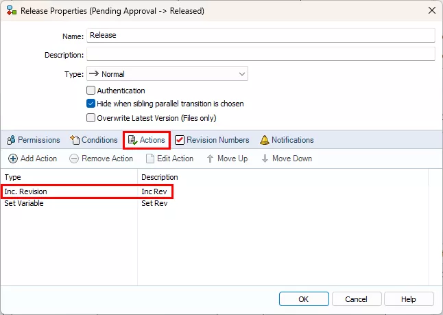

Incrementing the database revision is done as part of a workflow, using the Increment Revision action in a Transition or the manual Set Revision tool via the State.
The “Inc. Revision” action in a workflow Transition
[Image B: The “Inc. Revision” action in a workflow Transition]
A workflow State showing the components of a State Revision Schema
[Image C: A workflow State showing the components of a State Revision Schema]

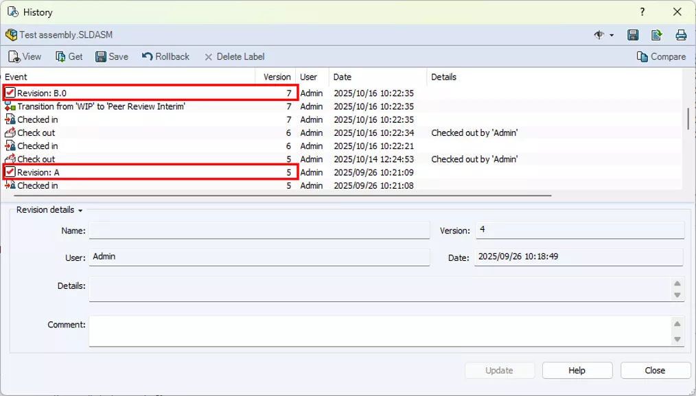

This is more easily visualized in the History dialog. As you can see, version 5 is assigned Revision A, version 6 has no revision, and version 7 is assigned Revision B.
The History dialog for a file, showing the version-specific revisions as separate line items
[Image E: The History dialog for a file, showing the version-specific revisions as separate line items]

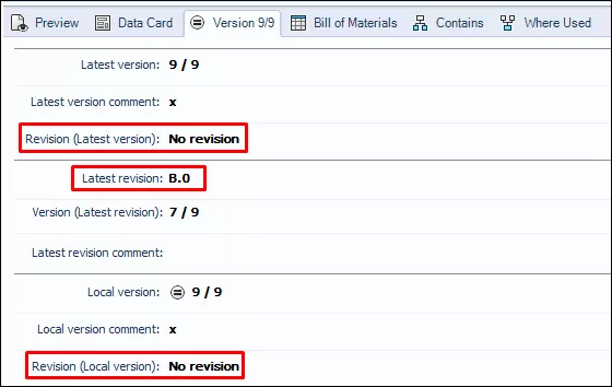

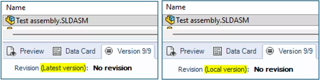

Using the same example as above, the “Test Assembly” shown below is on version 9, and no new revision has been assigned since version 7. So, if you have the latest version of the file (9) cached on your workstation, Latest and Local will both show “No Revision”.
Comparison of the Version tab for the same assembly file showing version 9/9 with both “Revision (Latest Version)” and with “Revision (Local Version)” showing “No Revision
[Images F.1 & F.2: Comparison of the Version tab for the same assembly file showing version 9/9 with both “Revision (Latest Version)” and with “Revision (Local Version)” showing “No Revision”]

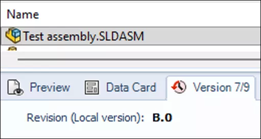

If you do a “Get” on version 7, you’ll see that change. Latest remains “No Revision” because version 9 has no revision assigned, but your local file is version 7, which does have a revision assigned.
Comparison of the Version tab for the same assembly file from Image F showing version 7/9 with “Revision (Local Version)” showing “B.0
[Image G: Comparison of the Version tab for the same assembly file from Image F showing version 7/9 with “Revision (Local Version)” showing “B.0”]

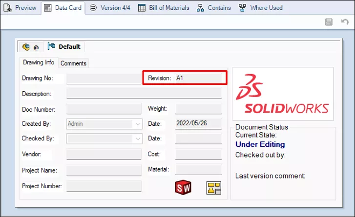

Now that you understand the Database Revision and how to read it, we can explain the Revision Variable (and how it differs). First and foremost, this is the Revision value you’ll see on the data card. It’s what a lot of people view as the default, or ”true” revision, though realistically the database revision is always going to be the most accurate since the variable is based on that database value.
PDM has a variable built into the default vault called “Revision”; this is provided as a default, generic template you can choose to use or not. You don’t have to use this variable if it doesn’t work for your needs – in fact, many companies have custom Revision variables, or even use more than one.
The Data Card for a file, showing the populated Revision variable
[Image H: The Data Card for a file, showing the populated Revision variable]
The revision variable is no different than any other variable, and when mapped to a data card it’s just a container for any text you put into it. Theoretically, you could even type whatever you wanted in that data card field - it’s static and considered nothing more than a “string” of characters that can be mapped to custom properties and displayed on the data card. Things can feed into it, or it can be manually updated - but it’s ultimately still just a container for text.

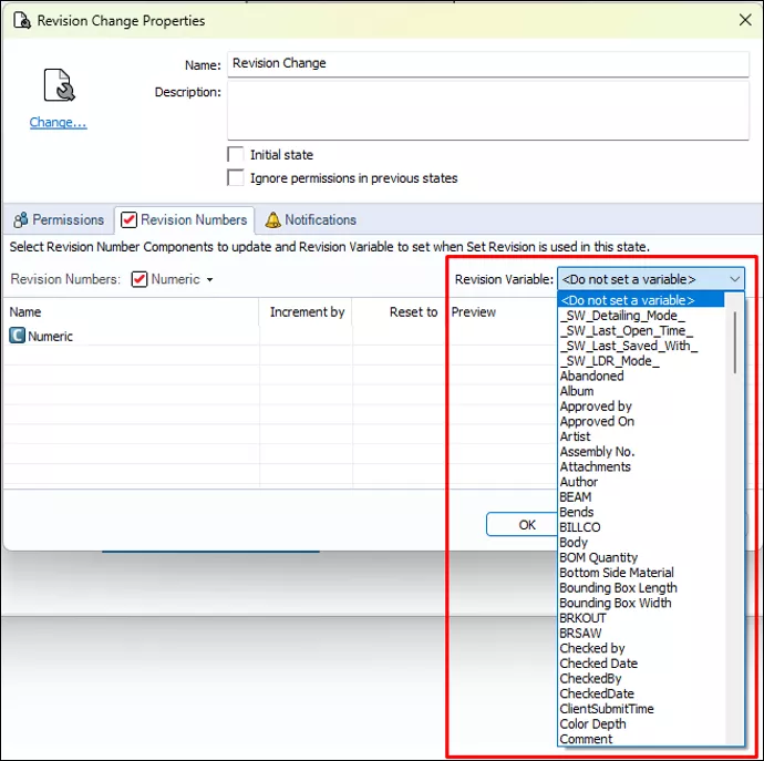

The properties for a workflow State, showing the expanded “Revision Variable” dropdown where you can assign the variable you want to use for Revisions
[Image I: The properties for a workflow State, showing the expanded “Revision Variable” dropdown where you can assign the variable you want to use for Revisions]
While some companies treat the SOLIDWORKS file as the one source of truth, it’s best to have PDM manage your revisions through your workflow. Then you can feed those values to the data card and finally the custom properties. This reduces the potential for human error and ensures proper permissions, approvals, and workflows are followed. We recommend setting up a revision component and number as mentioned above, assigning them to your workflow’s designated transitions and states, and setting up transition actions to Increment Revision and Set Variable in a pair.

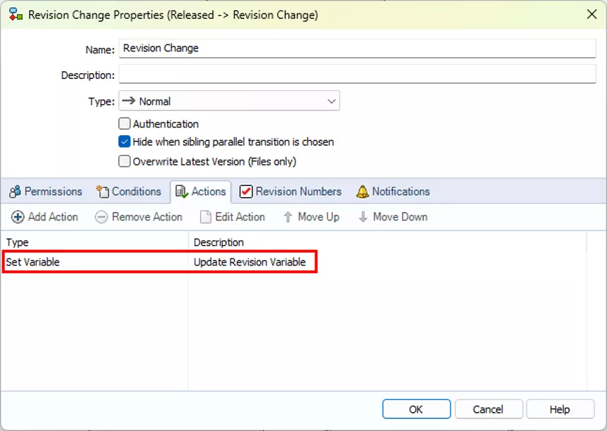

The Revision Variable populates from the Set Variable action in a workflow transition…
The properties of a workflow Transition, showing the Set Variable action with a description of “Update Revision Variable
[Image J: The properties of a workflow Transition, showing the Set Variable action with a description of “Update Revision Variable”]
…or the Update Variable checkbox in the manual Set Revision tool. (Though both of these feed from configuration done in the workflow.)

The Revision variable will never update on its own – even if the database revision changes. The values are not linked, so you have to configure your workflow to update the variable with the database revision using the aforementioned methods. If you’re not careful about pairing the “Increment Revision” and “Set Variable” actions together in your workflow, they can easily become mismatched.
The nice part about the revision variable (as with any other variable) is that it persists across versions, unlike the database revision. You can still see “Revision: B” on the data card whether it was set on the latest version or not. It won’t update until someone changes it, either by manually typing into the data card, using the Set Revision tool, or via workflow transition.
You can also map variables to custom properties on your files so they can be added to a Drawing’s title block, BOMs, synced to ERP systems, etc. It’s the “visible” portion of the revision outside of PDM. If you’re looking to learn more about how to do that, we recommend reading our blog on mapping variables to SOLIDWORKS file custom properties.
