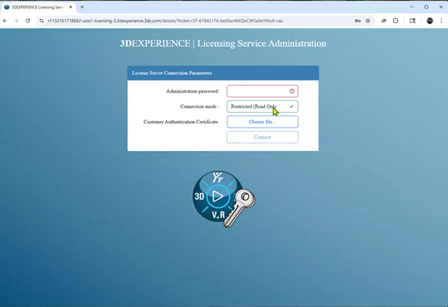

      Managed DSLS (Cloud‑Hosted by Dassault Systèmes) First Time Setup
Password Setup

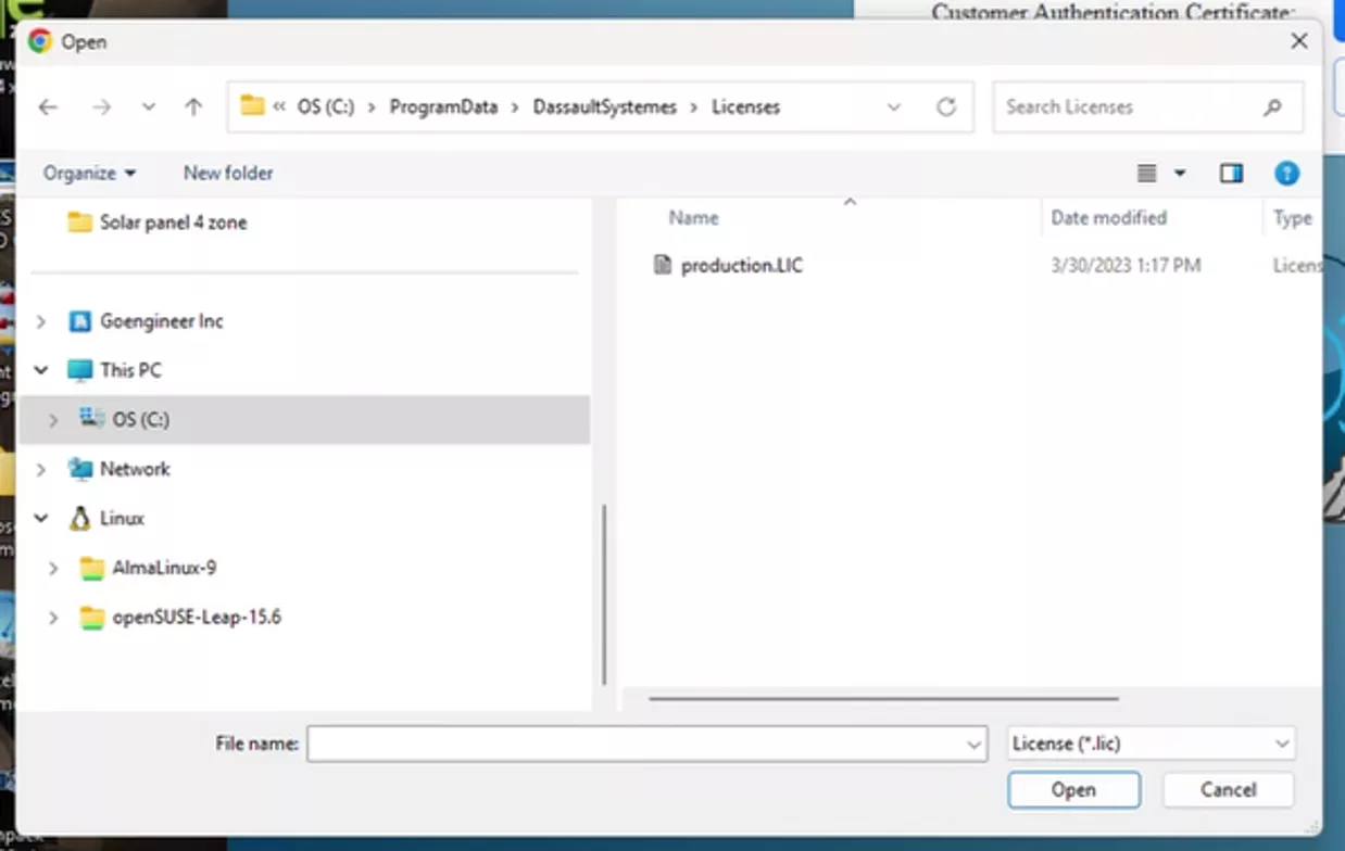

  1. Create passwords:
    • Upload the .LIC file when prompted
      • If needed, you can also find it locally at:  C:\SIMULIA\ProgramData\DassaultSystemes\Licenses\*.lic
        Managed DSLS (Cloud‑Hosted by Dassault Systèmes) Password Setup
Note: Use DassaultSystemes (one word), not Dassault Systemes.
    • Create a primary login password.
    • Create a secondary admin password.
      Create Secondary Admin Password 3DEXPERIENCE Licensing Service Administration

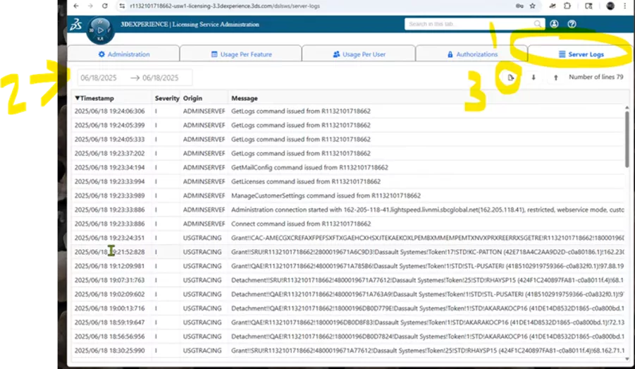

Exporting the Usage Log
  1. Log in to the Managed DSLS portal:
    • Navigate to Server Logs.
    • Select the desired date range.
    • Click CSV Export.
    • Email the exported file to your GoEngineer Abaqus Account Manager.

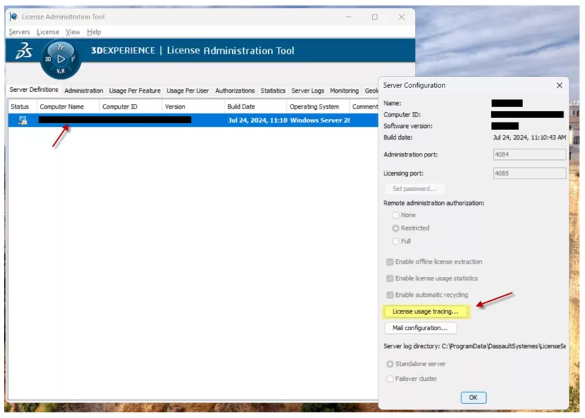

  1. Open DS License Administration Tool.
  2. Double‑click the computer name to connect.
  3. Navigate to License Usage Tracking.
    Abaqus License Usage Tracking
  4. Select the license(s) to track and enable tracking.
    Select Abaqus license(s) to track and enable tracking
Once enabled, DSLS will begin recording usage data, which is saved in the log files.
