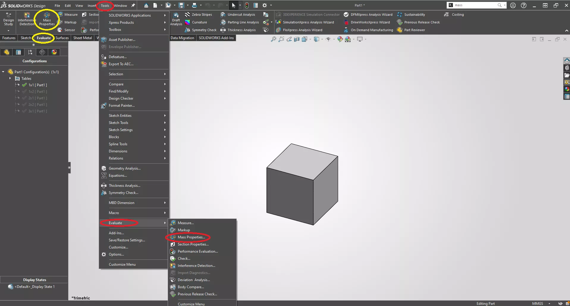

Once created and set up with the configurations, you will want to override the Mass Properties. Click the Evaluate tab and then Mass Properties. Optionally, go to Tools > Evaluate > Mass Properties.

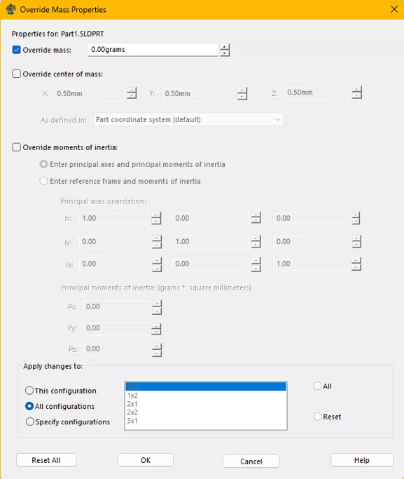

Once in the Mass Properties, click Override Mass Properties. This will open the Override window. Check the Override Mass box, but don’t worry about putting in a number. The most important part is to make sure that the Apply Changes To section at the bottom is set to All Configurations. Once set, hit OK.

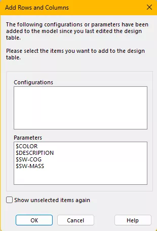

Right-click on Excel Design Table and choose Edit Table. A small window should appear where you can choose different parameters, select $SW-MASS, and press OK.  If this window does not appear, you can manually add the column to the table by clicking an empty Column Header and typing $SW-MASS.

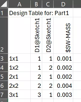

The final step is to add your values for the mass of each configuration. If the Add Rows and Columns window appeared and you added the $SW-MASS that way, then you will see values already populated. Simply remove the value that shows for each configuration and add your own.  Once finished, click out of the table to have it close and update. You can also press the green check in the upper right of the graphics area.
If you had to manually add the $SW-MASS, then no values will be present. Simply enter your values for each configuration, then click out of the table to have it close and update. You can also press the green check in the upper right of the graphics area.
SOLIDWORKS Design Table Add Mass Properties
And that’s it! Upon closing the table, the mass properties of each configuration will update to show the new values entered. You will then be able to update the values as needed using the single table, instead of manually changing each configuration.
