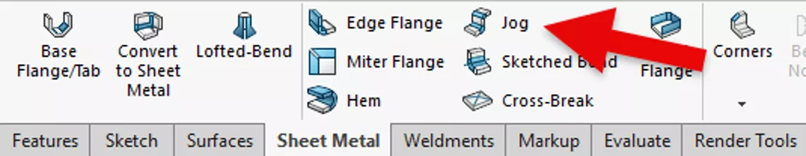

Accessing the Jog Command
Before creating a jog, we'll first need to locate the command in the SOLIDWORKS interface. The Jog feature is available in the Sheet Metal CommandManager tab. Alternatively, it can be accessed by selecting Insert > Sheet Metal > Jog from the menu bar.
SOLIDWORKS Jog Feature Location

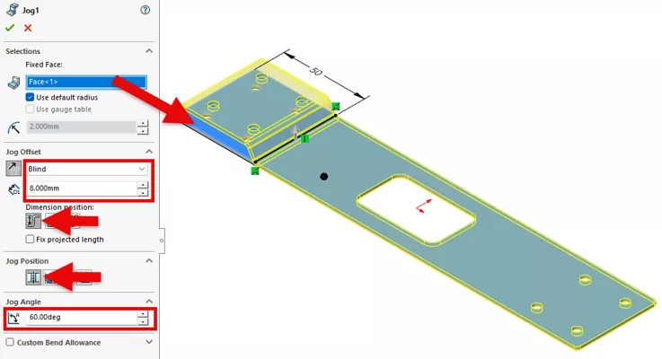

We will begin with a flat sheet metal part that does not contain any existing bends. The first jog will be created on the left side of the part. To define the location of the jog, start by creating a sketch on the top flat face of the sheet metal body. Draw a sketch line across the part and dimension it 50 mm from the left edge, as shown in the image below.
Creating a SOLIDWORKS Sheet Metal Jog Feature
With the sketch still active, launch the Jog feature and select the top flat face of the sheet metal part as the Fixed Face. Under the Jog Offset section, set the end condition to Blind and define the offset distance as 8 mm. For the Dimension Position, select Outside Offset. Next, we'll set the Jog Position to Bend Centerline, enter a Jog Angle of 60 degrees, and click OK to complete the first jog.

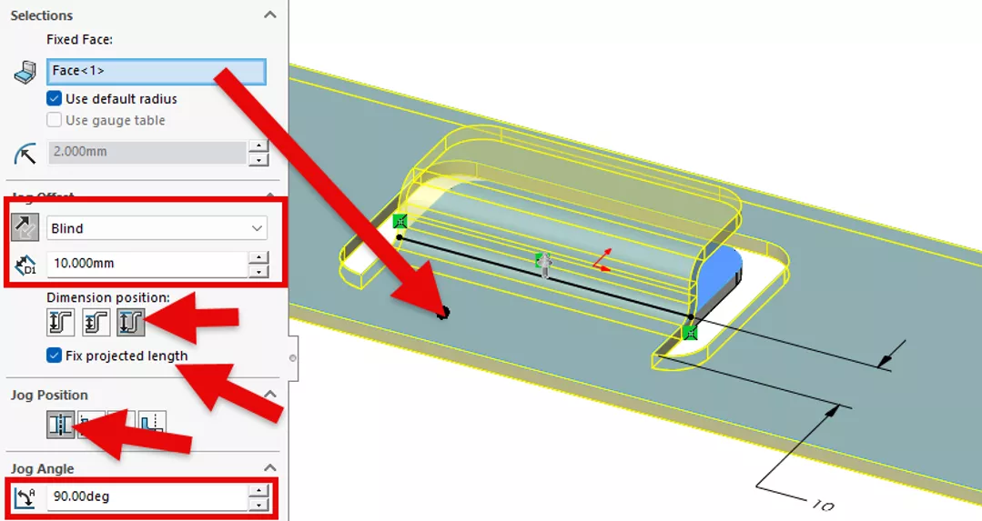

With the sketch still active, launch the Jog feature and select the top face of the part as the Fixed Face. Under Jog Offset, set the end condition to Blind, make sure the jog is going up, and enter 10 mm.
For the Dimension Position, we'll select Overall Dimension and enable Fix projected length. The Jog Position will remain set to Bend Centerline, and we'll set the Jog Angle to 90 degrees. Once the settings are defined, click OK to create the second jog.
SOLIDWORKS Jog Feature Dimensions, Position, and Angle

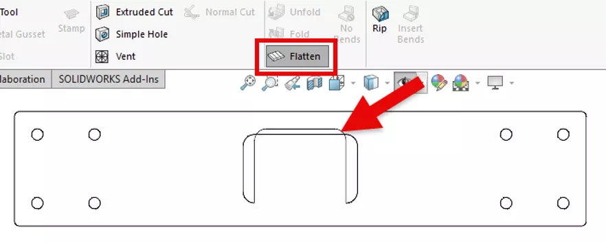

If we look at the flat pattern, we can see there is a problem with the jog we just created. The jog material extends into the rest of the flat pattern, meaning the jog operation added more material to the tab in the middle of the cutout.
Flatten Tool in SOLIDWORKS Sheet Metal

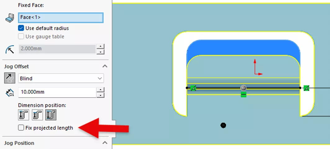

The jog's overall dimension needs to remain unchanged while ensuring the tab length is maintained. This allows the sheet metal part to unfold correctly when creating the flat pattern. To achieve this, we'll edit the newly created Jog feature and disable the Fix projected length option.
Fix Projected Length Checkbox in SOLIDWORKS Sheet Metal
When enabled, this option maintains the projected length of the part based on the entered jog values. With the option cleared, the feature instead preserves the actual length of the existing tab geometry, which, in this case, maintains the length of the tab when flattened.
Fix Projected Length Results in SOLIDWORKS Sheet Metal

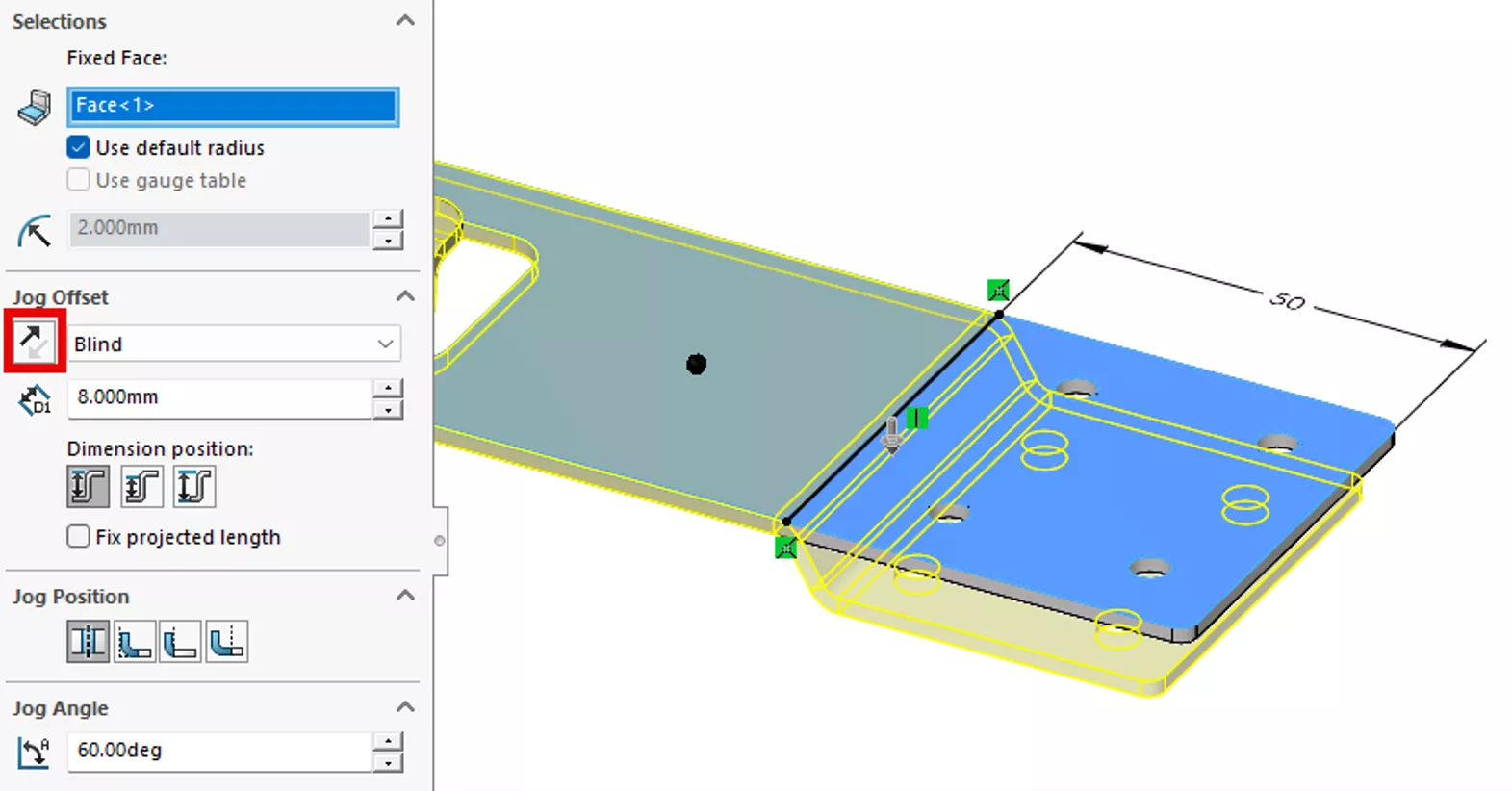

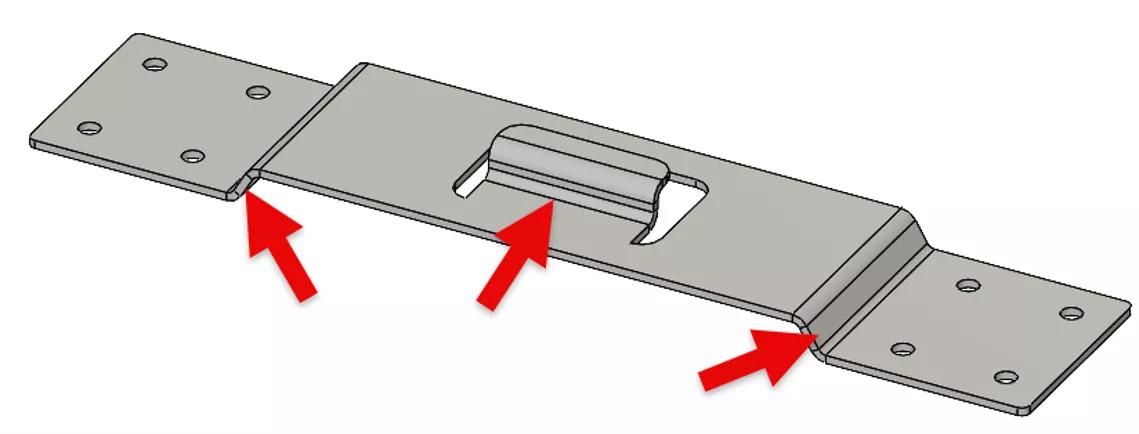

For the final jog, we'll create the feature on the right end of the sheet metal part using the same process as the first jog. Let's begin by creating a sketch on the top face and adding a sketch line to define the jog location. Once the sketch is complete, use the Jog feature to create the offset, applying the appropriate jog settings to match the desired geometry. This will complete the three jogs demonstrated in the example part.
Jog Offset Option in SOLIDWORKS Sheet Metal

The Jog feature in SOLIDWORKS provides a simple and effective way to create offset bends in sheet metal parts while maintaining control over the resulting geometry. By adjusting options such as jog direction, offset distance, bend position, and projected length settings, we can create precise features that meet design requirements while ensuring the part unfolds correctly in the flat pattern.
