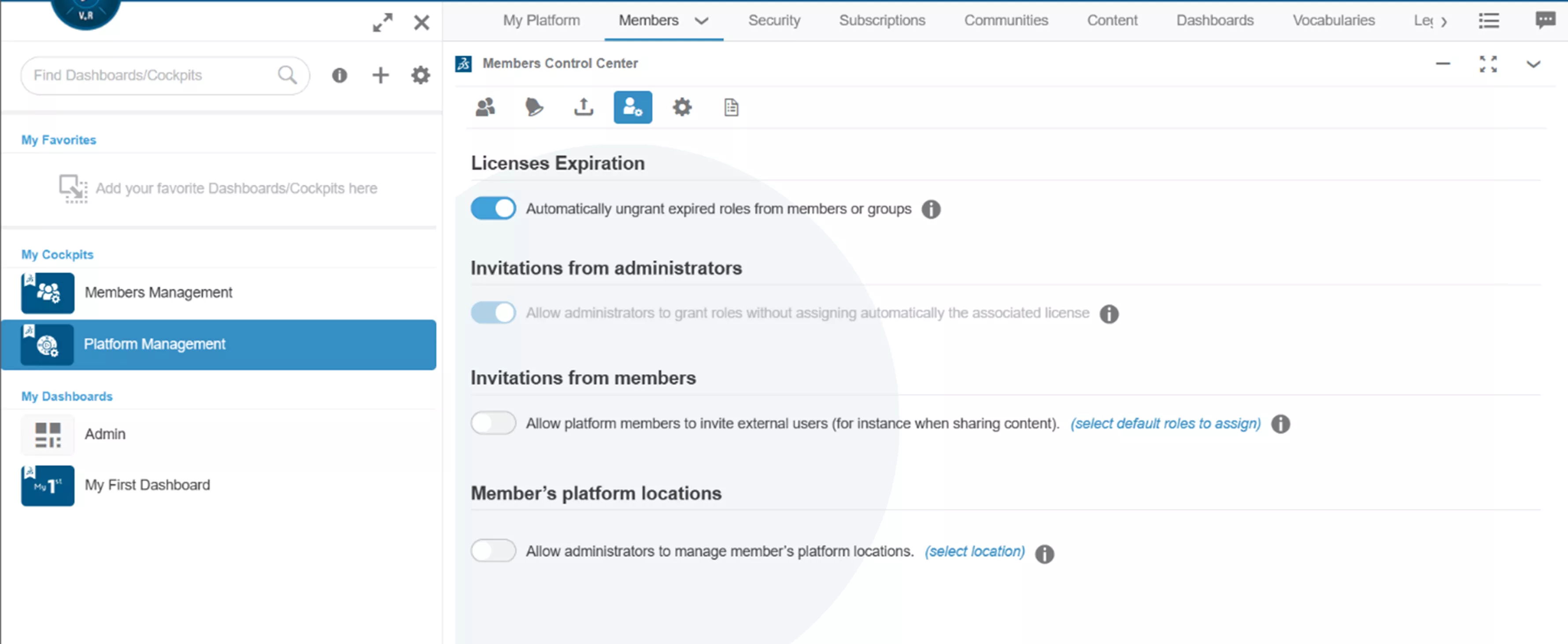

While logged in as admin, go to Platform Management > Members Control Center, and under the Members tab, you will see Automatically ungrant expired roles from members or groups. Once this toggle is turned on, the issue of not having access after a renewal will no longer occur.
3DEXPERIENCE Lockout Due to Platform Management Toggle

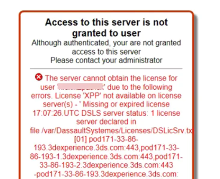

Roles are important when it comes to 3DEXPERIENCE. Your role determines what you have available within the tenant. Having too many users and not enough roles will prevent users from gaining access to the platform, resulting in the error below.
Locked out of 3DEXPERIENCE Due to Not Enough Roles

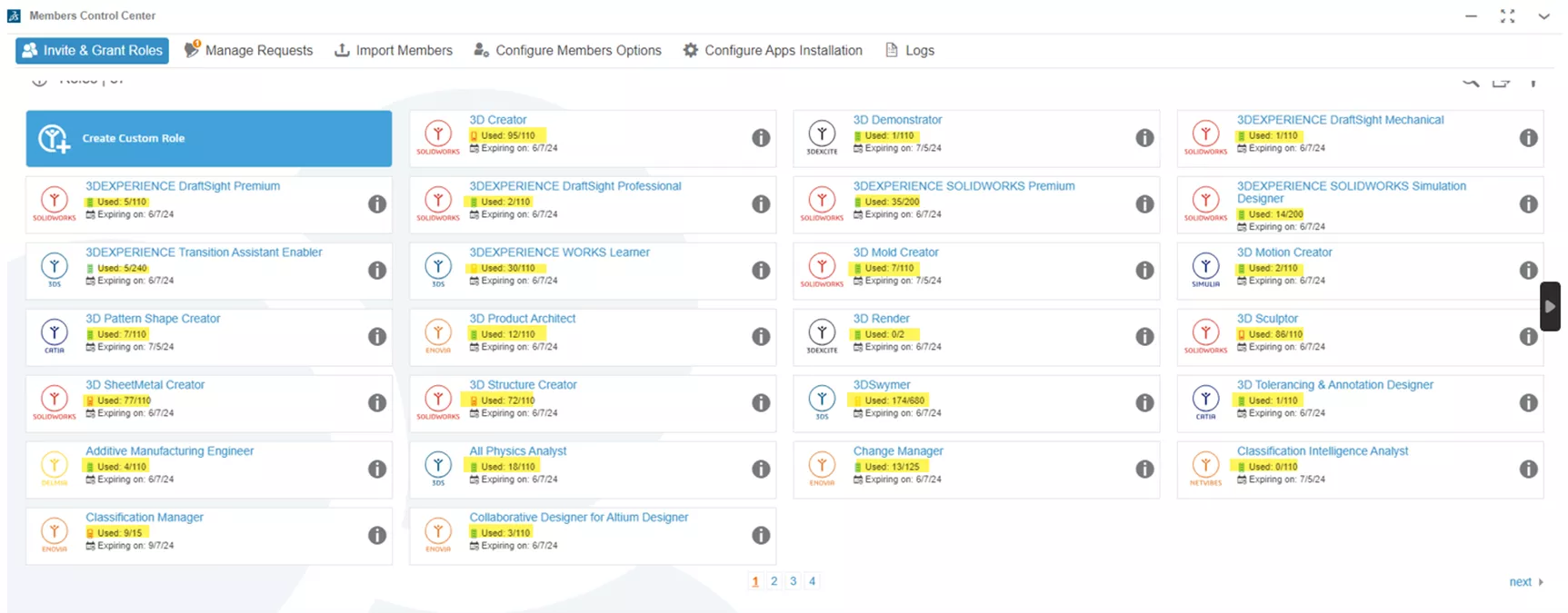

It is recommended to go through and remove any users from the list who are no longer with the company or should no longer have access to the tenant. You want to make sure your license count matches the number of users who will be using the tenant. As seen below, the Invite and Grant Roles page shows all available roles and how many of those roles can be given out.

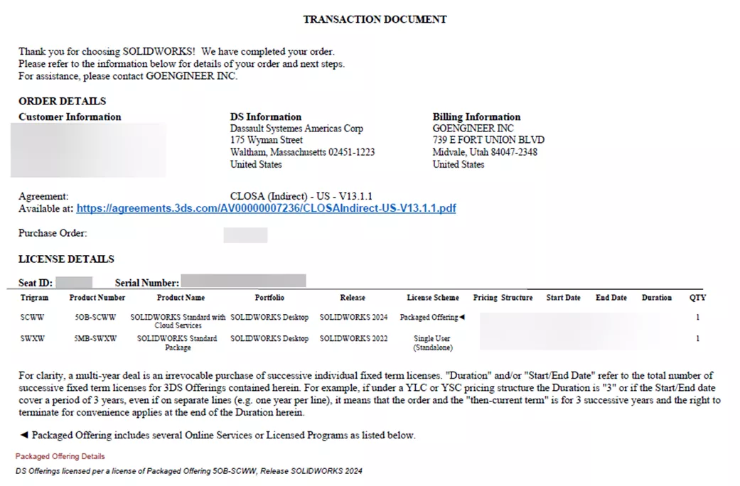

Another scenario that can prevent you from gaining access to the 3DEXPERIENCE platform is if you haven’t signed the most recent CLOSA agreement. So, where does one find this agreement? When the transaction is complete from the purchase, you’ll receive a PDF document (sometimes called the Transaction Document) from DS SolidWorks Corporate. Within it, you’ll see a link that says Agreement Available at with a link.
3DEXPERIENCE Lockout Due to Unsigned CLOSA Agreement
Once this agreement is signed, you should then have access to the tenant and can begin to hand out roles. Once you gain access to your tenant, we recommend joining the Success Hub for further information and understanding of the 3DEXPERIENCE platform.
