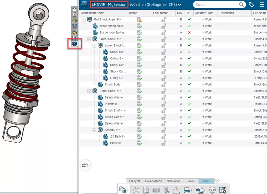

  1. Open the Assembly inside SOLIDWORKS and connect to your 3DEXPERIENCE platform (MySession) in the right task pane.
    Connect a SOLIDWORKS Assembly to 3DEXPERIENCE Platform (MySession)

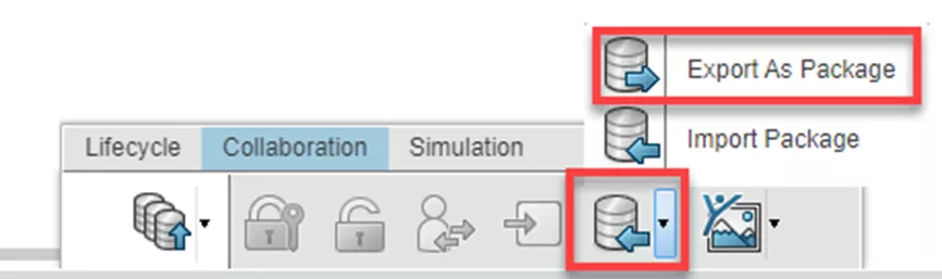

  2. Inside the same 3DEXPERIENCE tab, navigate to the Collaboration tab and select Export as Package.
    3DEXPERIENCE SOLIDWORKS Export as Package Option

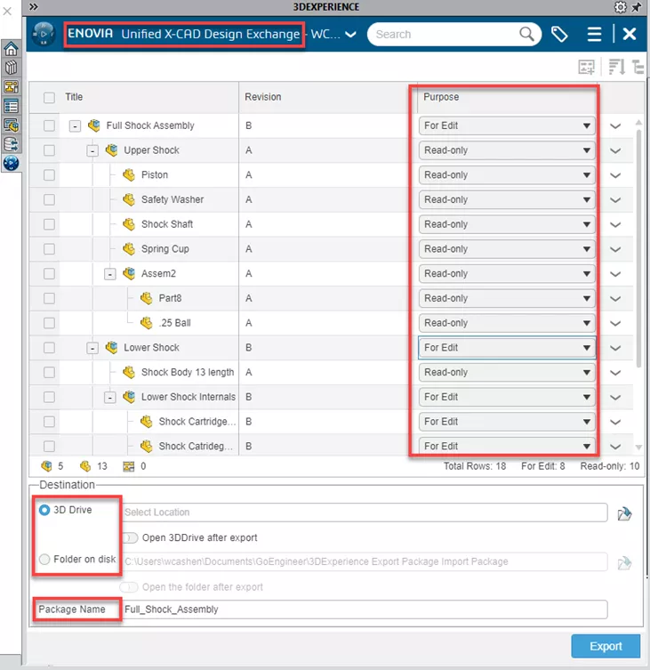

  3. This opens the Unified X-CAD Design Exchange app inside the right task pane. Review and configure…
    1. Files to include (Parts, Assemblies, Drawings)
    2. Read/Write Permissions for each individual file
    3. Destination
    4. Package Name
      3DEXPERIENCE Unified X-CAD Design Exchange App
  4. Click Export and locate the .SLDPKG file locally or inside 3DDrive. (There’s an option when saving to directly open the save folder or the 3DDrive.)

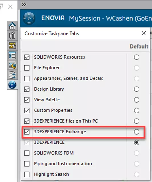

  1. Inside SOLIDWORKS, navigate to the right task pane, right-click on the 3DEXPERIENCE tab, and select Customize.
  2. Inside the window that popped up, turn on the tab called 3DEXPERIENCE Exchange. This tab will allow us to import the shared package into SOLIDWORKS. Things to note…

    2. In the same location where the initial user exported the package, in the collaboration tab, you can import using the dropdown carrot.

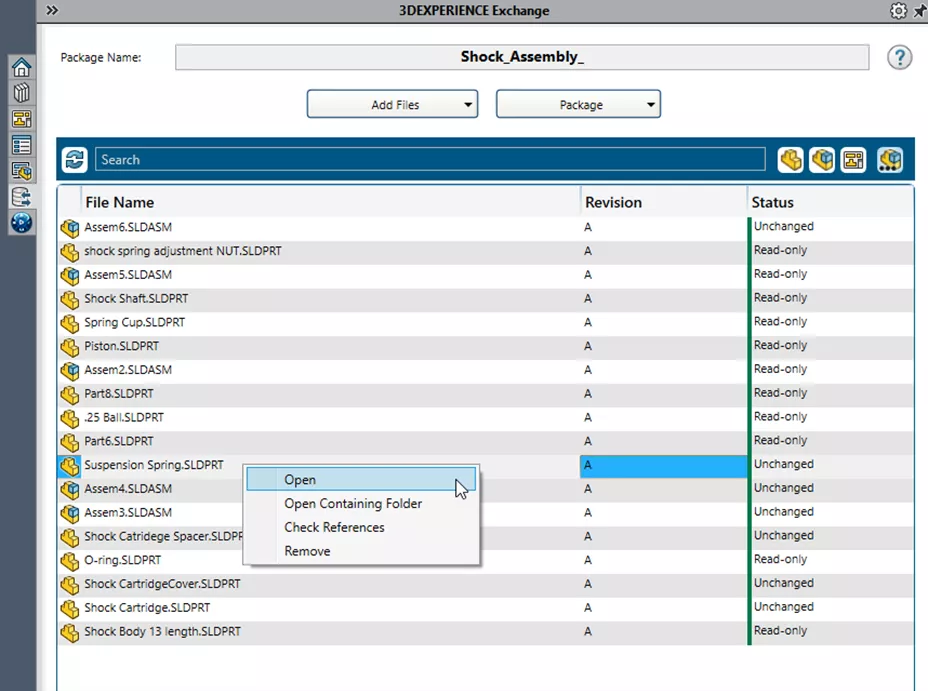

  5. The Exchange tab lists all the files included in the package with their respective Revision and Status (Read/Write Permissions).
  6. Right-clicking on a file will provide a list of options that are described here:
    1. Open – Open the selected File.
    2. Open Containing Folder – Opens the File Explorer Folder where the file is stored.
    3. Check References – Opens the Check for References dialogue box that finds references for the file and indicates the path.
    4. Remove – Removes files that you added to the package and deletes them from the workspace. (You can remove multiple with a Shift + select.)
      3DEXPERIENCE Exchange Package Name File Options

  2. At the bottom, select the Collaboration tab and find the dropdown menu for exporting/importing packages. Choose Import Package and locate the shared updated package.

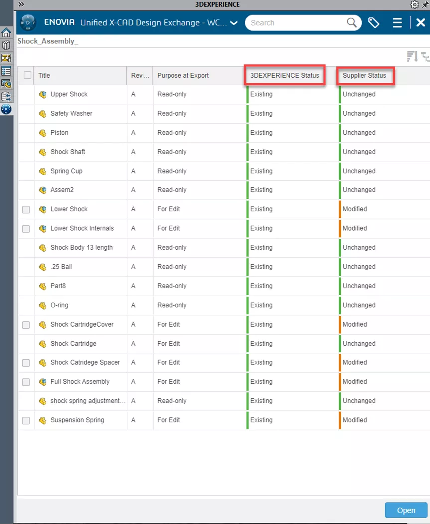

  3. This will open the Unified X-CAD Design Exchange. Inside this window, it will display:
    1. Filename
    2. Revision
    3. 3DEXPERIENCE Status – Describes whether the file exists on the platform.
    4. Supplier Status – Describes whether the file is new to the package, unchanged, or modified.
      3DEXPERIENCE Status and Supplier Status Columns

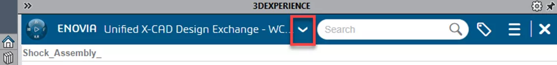

  5. Inside the 3DEXPERIENCE tab in the task pane, drop down the top ENOVIA bar and select MySession. This will bring us back to the PLM view.
    ENOVIA Unified X-CAD Design Exchange Dropdown Carrot

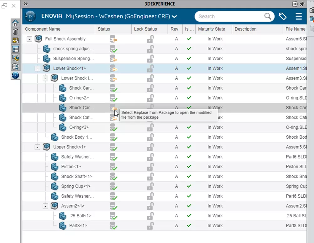

  6. In the status column, are stacked puck symbols with a green check or an orange outlined arrow. The green represents that it's saved and up to date. The orange indicates that a change to the file that exists in the package.
    ENOVIA Unified X-CAD Design Exchange Status: Orange vs Green
  7. To see the change inside the opened model, right-click the changed file in the MySession Pane. Inside the menu, click Replace from Package.
    Replace from Package Option in 3DEXPERIENCE SOLIDWORKS
  8. Once it has been replaced and the model has been rebuilt, the orange arrow will switch from outlined to solid orange. You can choose to save and upload this to the platform, or if the changes do not fulfill requirements, you can reload the part from the server and revert the changes made.
