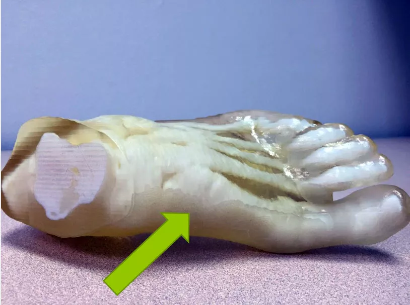

PolyJet 3D printing is a process that employs a UV-cured thin film, it has a very high resolution and can create stunning visual results. In general, PolyJet prints are superior when it comes to visual quality, but they suffer from one fatal flaw: the glossy PolyJet finish becomes a cloudy matte finish when it comes in contact with support material. Because of this, any surface that points downward is going to result in this rougher finish.
PolyJet print showing line where the finish goes from glossy to matte

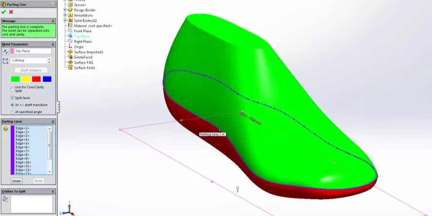

The first step to achieving this is to create the proper parting lines on your part. This is done using the Parting Lines tool on the Mold Tools tab of the CommandManager. When using this tool, you will want to choose a direction of pull that is going to give you the cleanest split of your part.
In this example, the Top Plane works well. We will also want to make sure that the Split Faces (At +/- draft transition) option is enabled in case the parting line isn’t clearly defined in your part.
Parting Line creation via SOLIDWORKS Parting Lines tool

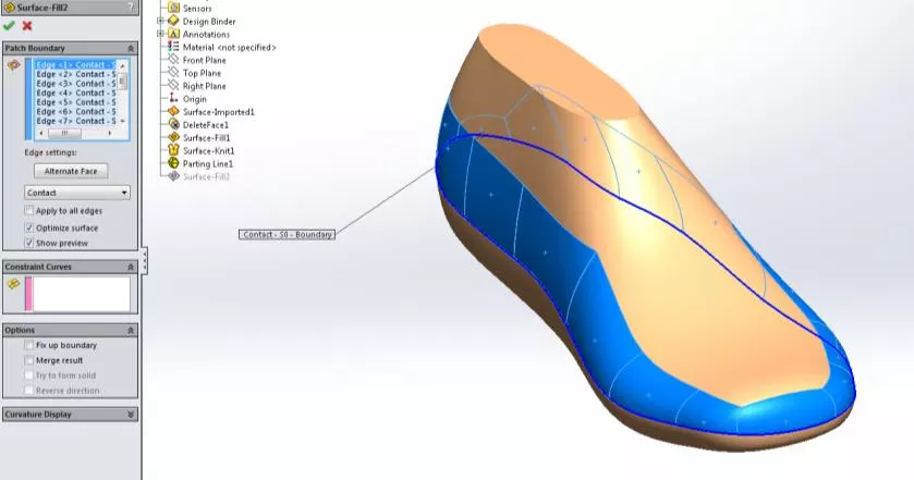

Once we have established a parting line, we can use this parting line to create a parting surface. In this case, I created a filled surface (CommandManager: Surfaces > Filled Surface) from the edges created by the parting line.
Parting Surface creation via SOLIDWORKS Filled Surface

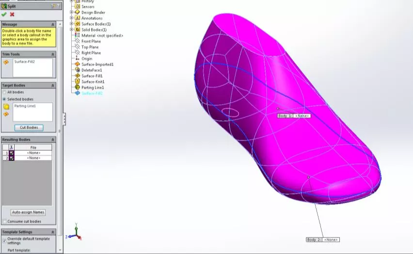

After creating the filled surface, we will need to split our part with that surface. This can be done using the Split feature (Insert > Features > Split) and using the Filled Surface as the cutting tool. You will want to make sure that you keep both of the bodies after the split.
Splitting of the part into two bodies in SOLIDWORKS

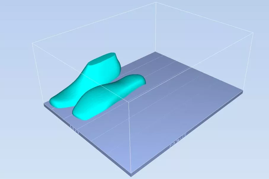

After we have split our part, we can either orient it within SOLIDWORKS or orient it in the 3D printing software like GrabCAD Print. Either way, we will want to make sure that the lower halves are flipped 180 degrees so the part that was facing downward is now facing upward. In this case, we are using Objet Studio to orient our parts before printing (seen in the picture below).
PolyJet 3D Printing Using SOLIDWORKS Mold Tools
After printing in this orientation, the parts can be assembled and adhered with CA glue so that the matte surface created by the support material will be internal to the part. The end result is a glossy finish around the entire outer surface of the part.
