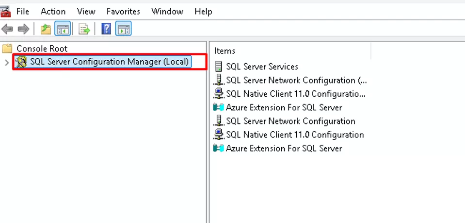

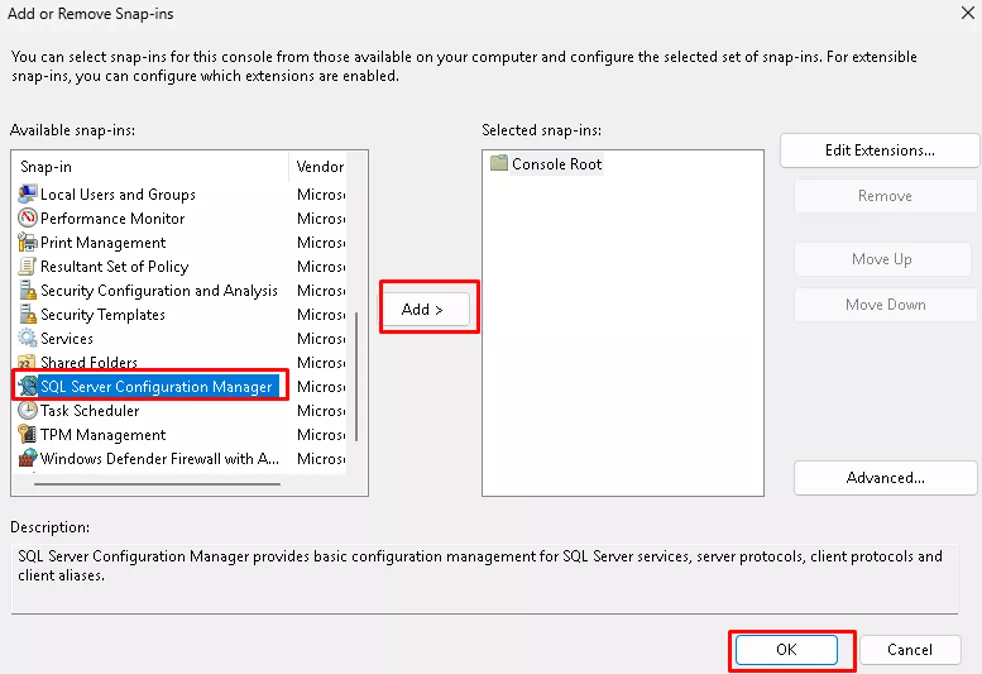

  1. From the Windows Start menu, click Microsoft SQL Server version > SQL Server version Configuration Manager.
    1. We've recently received reports that SQL Server Configuration Manager has been “disappearing” from user’s computers either directly after an install/version update, or after a Windows update.  If you’re unable to find SQL Server Configuration Manager in your start menu, press WIN + R and type the appropriate version in to run from the list below.
      Version Value typed into Run
      SQL Server 2025 SQLServerManager17.msc
      SQL Server 2022 SQLServerManager16.msc
      SQL Server 2019 SQLServerManager15.msc
      SQL Server Run Prompt
      If, for some reason, the steps above do not bring up the SQL Server Configuration Manager, please read the additional instructions for adding SQL Server Configuration Manager to the Microsoft Management Console.

  4. In the Application window that appears, select File Add/Remove Snap-in.
  5. Select the appropriate snap-in: SQL Server Configuration Manager  > Add > OK.
    SQL Server Configuration Manager Available Snap-ins
  6. The console should appear in the left-hand pane as an available application and can be used as normal.
    SQL Server Configuration Manager Console
If you would like to save this console for easier access, you can save it to the desktop and run it like any other program
