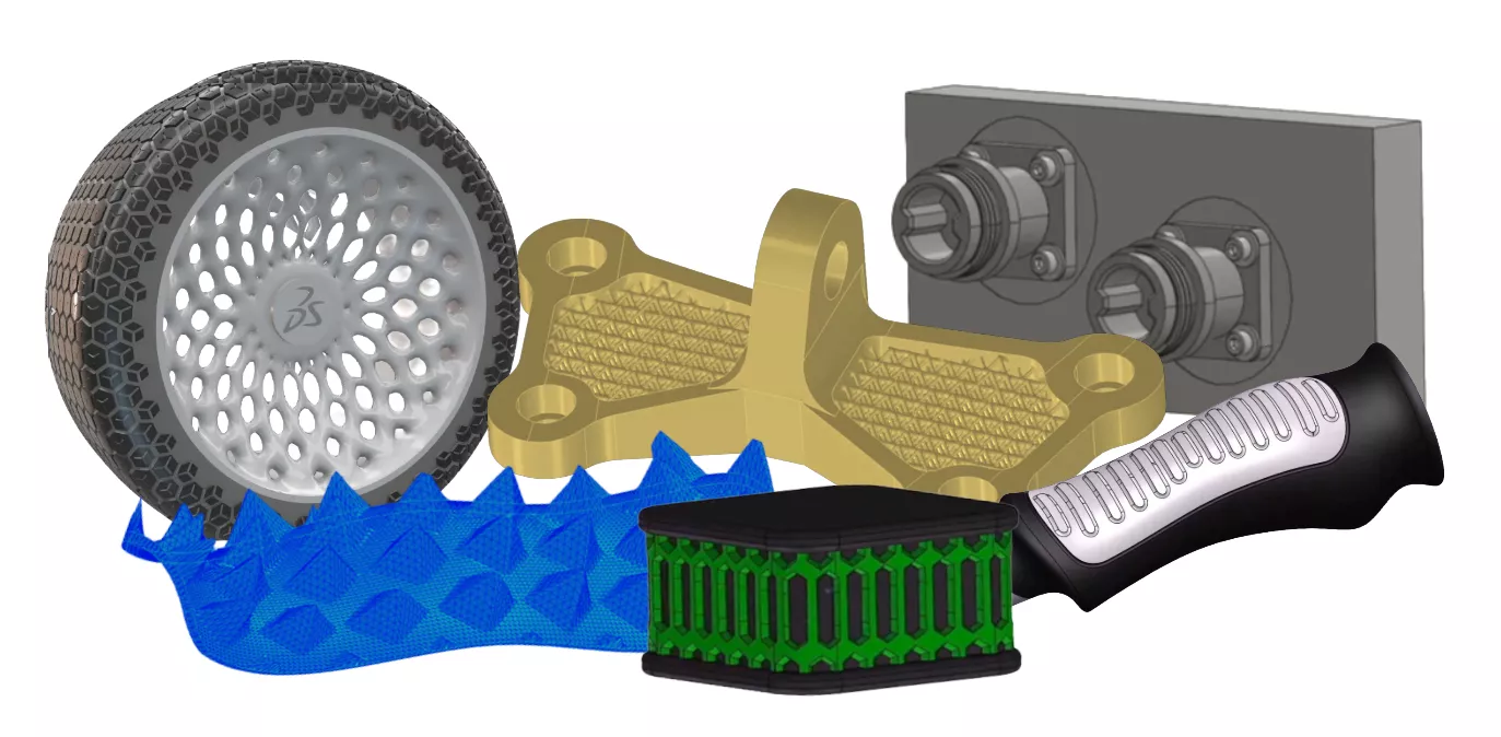

#4. Lattice Structures for Additive Manufacturing
For industries requiring lightweight, high-strength components, such as aerospace, medical devices, or performance sports, lattice structures are a game-changer.
Tools like Lattice Designer allow for the rapid generation of these complex internal structures. What would take hours of manual patterning in traditional CAD can be accomplished in minutes. These structures are optimized for 3D printing, enabling the creation of parts that use minimal material while maintaining structural integrity and advanced thermal properties.
