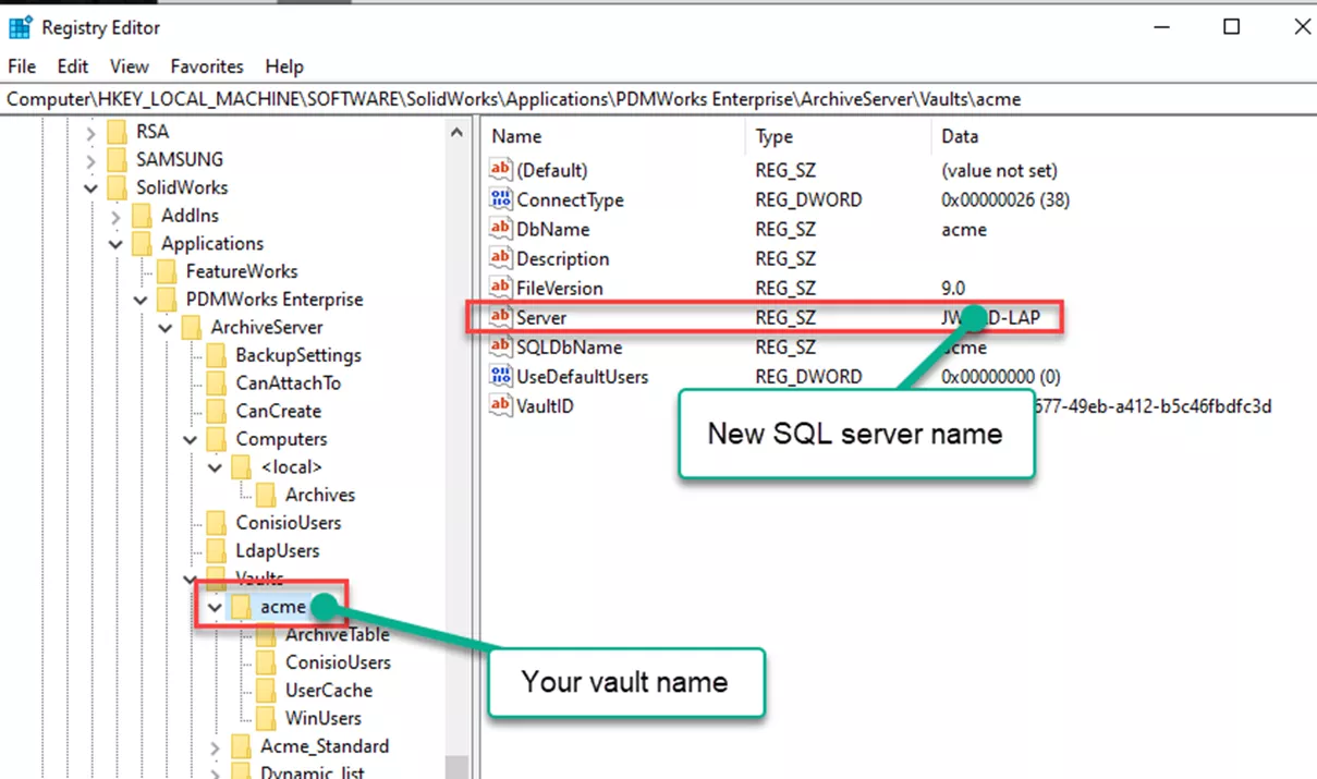

On the archive server, open the registry with the command “regedit”.
Go to HKEY_LOCAL_MACHINE\SOFTWARE\SolidWorks\Applications\PDMWorks Enterprise\ArchiveServer\Vaults\yourVaultName” where “yourVaultName” is the name of your vault. Be certain to update all vaults.

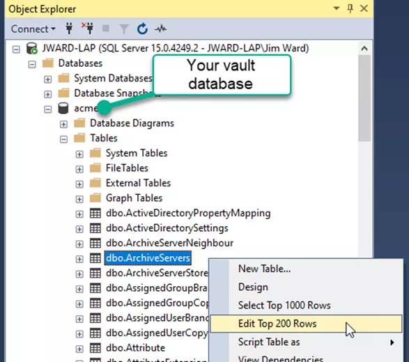

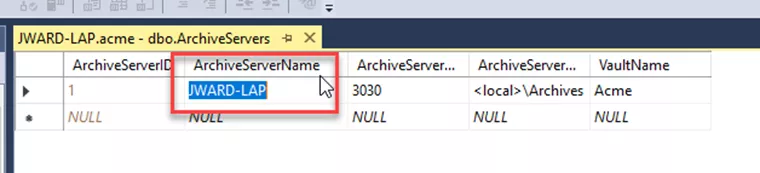

On the SQL server, start Microsoft SQL Management Studio, and log in with an account that has sysadmin privileges. Expand Databases: your vault database: Tables. Right-click the table dbo.ArchiveServers and choose Edit top 200 Rows.
Edit the ArchiveServerName and select Enter.
Important: Selecting Enter triggers your changes to be saved.

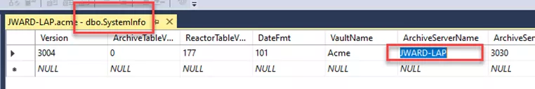

Repeat the process in the table “dbo.SystemInfo”.

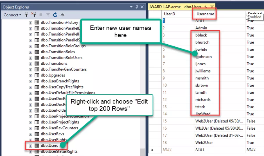

First, edit the table “dbo.Users” in the database. Use the same method as outlined in "Update the database to new archive server name" to access the tables in the database. Right-click the table dbo.Users, and choose Edit top 200 rows. Edit the first 200 usernames to the desired names. Do not change the username for the admin user. This is a special user for PDM and should not be modified.
If you have more than 200 users, then you will need to use the SQL command Update Table. Be very careful with this command, as you can destroy the table with it.
