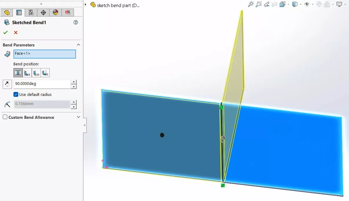

The Advantage of Sketched Bends

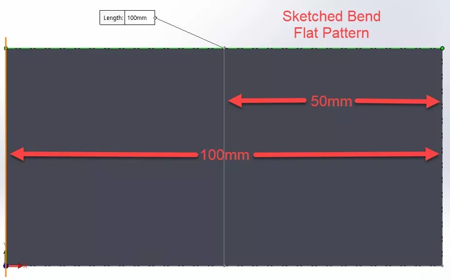

Sketched Bends and Edge Flanges can both create the same parts in SOLIDWORKS, but they require different approaches. A Sketched Bend is defined by a sketch on a sheet metal part before it gets bent. So, a Sketched Bend lets you create the part by sketching its flat pattern directly. But since sheet metal stretches when bent, this means that the dimensions applied to the pattern will differ from the finished, 'bent' dimensions.

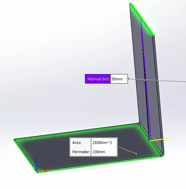

SOLIDWORKS Sketched Bend Flat Pattern

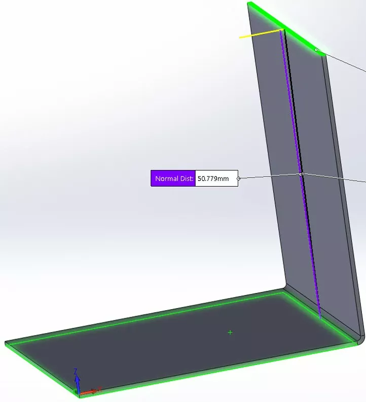

In this screenshot, the sketch line for a Sketched Bend is positioned 50mm from the edge of the 100mm piece of flattened sheet metal. Once bent, notice that the height of the flange is 0.779mm longer than the distance specified in the sketch, due to the stretch.

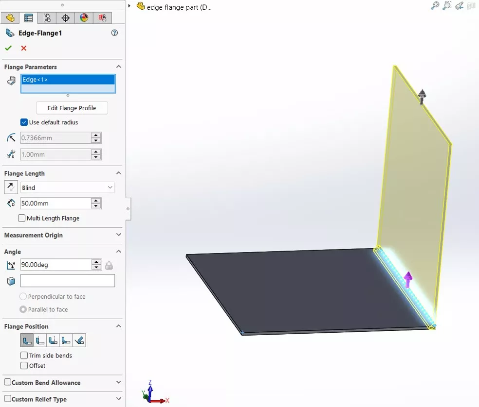

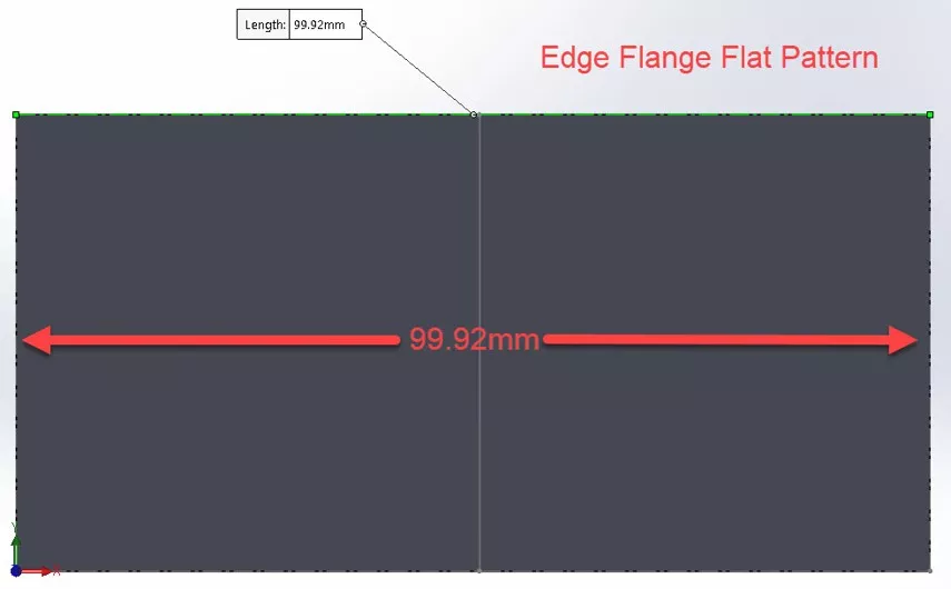

Edge Flanges add material to an existing base part to create the final bent part. By adding material this way, SOLIDWORKS lets you define the final dimensions of the part. This is great when the bent part needs to be precise. But this precision may come at the expense of cost, since the flat pattern dimensions aren’t likely to be standard integer values that correspond with standard stock.

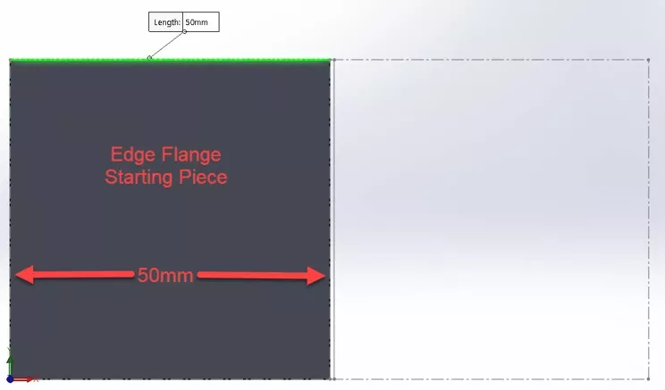

SOLIDWORKS Edge Flange Starting Piece
In this example, a 50mm Edge Flange is added to a 50mm x 50mm base flange. Notice how the bent flange is exactly 50mm, but the flat pattern is slightly smaller to account for stretching in the bend to create an edge flange of exactly 50mm. This might require an extra cutting operation if the material comes in 100mm widths.
SOLIDWORKS Edge Flange Flat Pattern

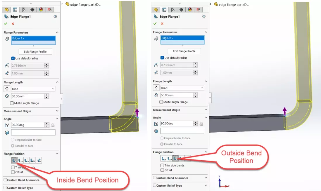

Using Bend Position to Control Length

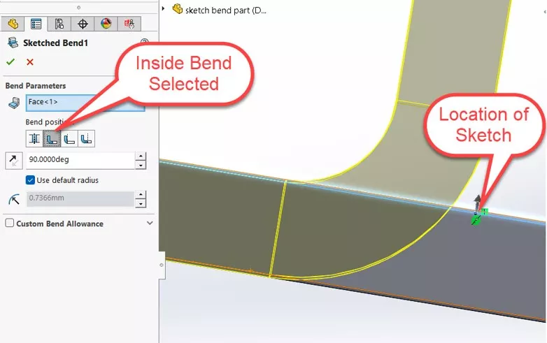

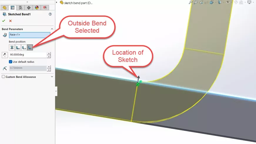

When creating a Sketched Bend, specifying the bend position is one strategy to control the length of a sheet metal feature. This option defines where the flange is relative to the 2D sketch. This does not give you the exact length of the flange after bending, but it helps significantly to control it.
SOLIDWORKS Bend Position Control Length
Bend Position and Control Length in SOLIDWORKS Sheet Metal
The same option exists for Edge Flanges, but the results are slightly different. Adjusting the bend position changes where the bend will be on the flat pattern, and lets you decide if the starting piece’s length will be affected. It will not affect the length of the flange you are adding.
SOLIDWORKS Sheet Metal Inside and Outside Bend Positions
