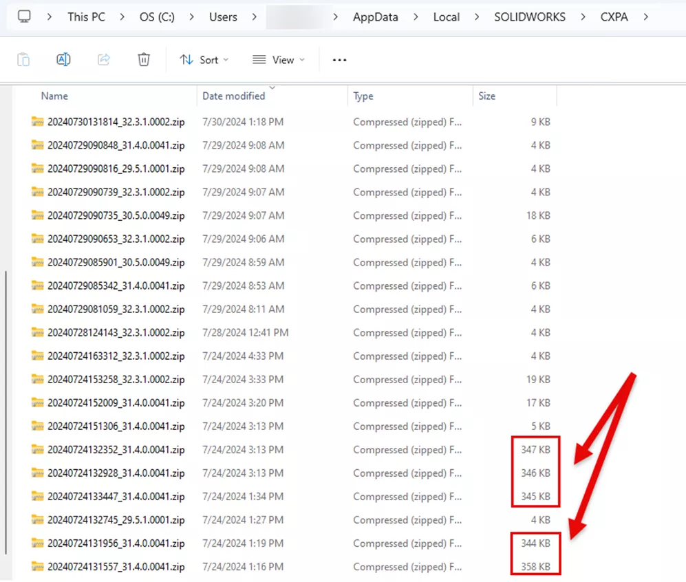

When you arrive at the file path above, you will see many more .zip files than you do crashes. At this point, if you feel you are too far in and don’t feel comfortable, go ahead and grab the last 10 or so .zip folders written and send them to another compressed folder (.zip). When you contact Technical Support with a crashing concern, they will request these logs from you.
If you’re still with me, great! Find those CXPA logs with a larger size than those surrounding it – that will likely contain a crash (see image below).
SOLIDWORKS Troubleshooting CXPA Logs
Unzip one of the larger folders and look inside its contents. If it contains a ‘CXPD’ folder, this log was from a crash! You can verify this by opening the other file in this folder, ‘SolidWorksPerformance.log.’ If the program terminated with a crash, the last line will either be <T> or <AT>, and there will be a <RAWSTACK> line in the log file.

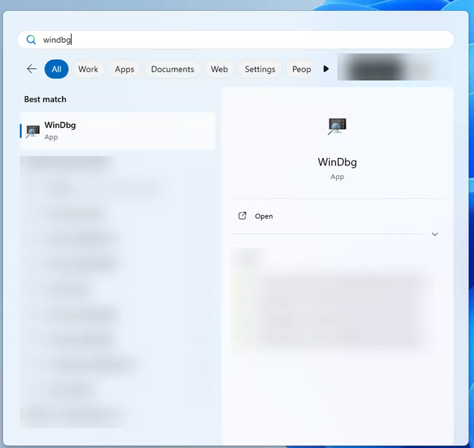

Once WinDbg is installed, you may access it by typing ‘windbg’ in your Windows Start Menu and launching the program.
Search for WindDbg Windows Debugger App in the Windows Start Menu

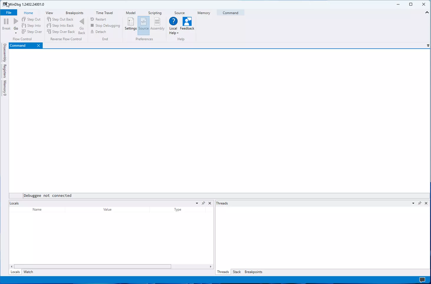

You will get a screen that looks something like this:
Windows WinDbg App for SOLIDWORKS Crashes
Return to your CXPA folder location, unzip (if you haven’t already) one of your crash logs, go into the CXPD folder, navigate through one more folder (it will have a date- and time-stamp as its name as well as your SOLIDWORKS version number), until you reach a destination containing a .dmp file.
You will drag and drop the .dmp file into your WinDbg window, and it will start running and indicate ‘BUSY’ while it loads.
Once this finishes, type !analyze -v in the command line and hit Enter. This will analyze your file and output information for Tech Support to analyze.
